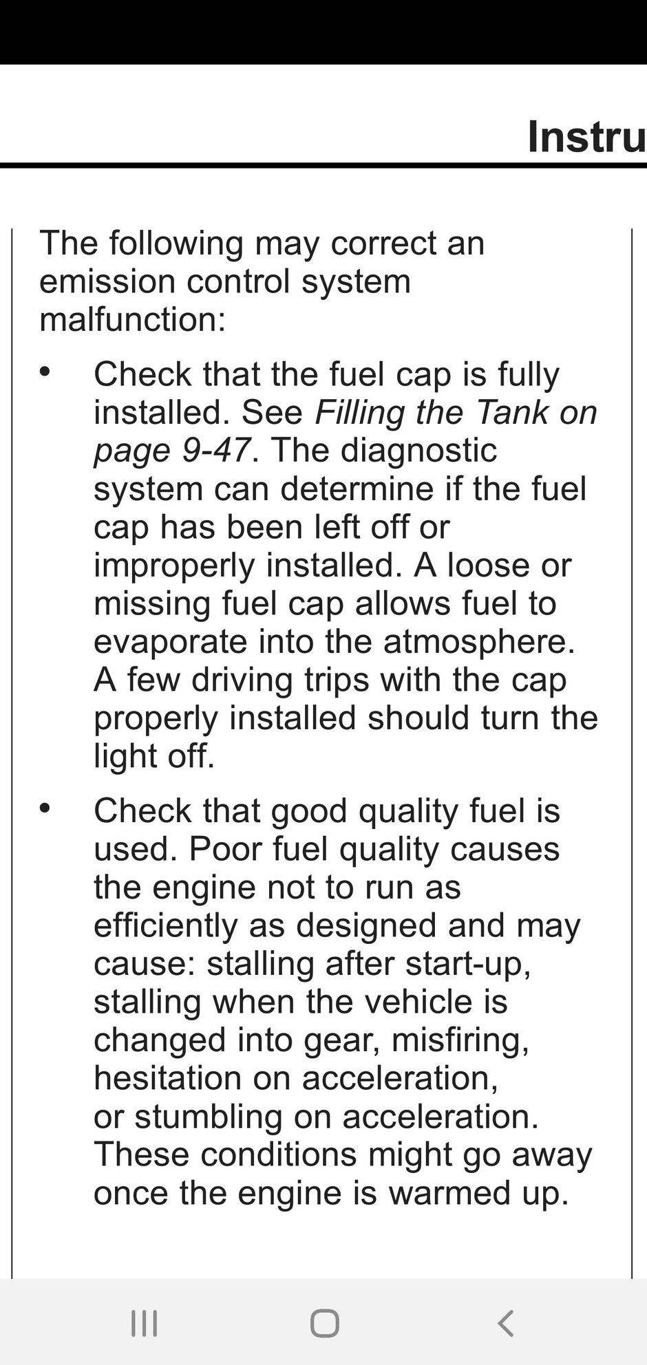

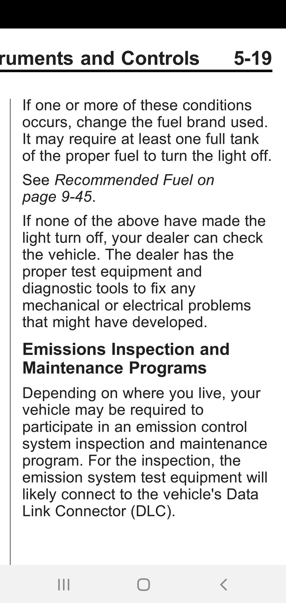

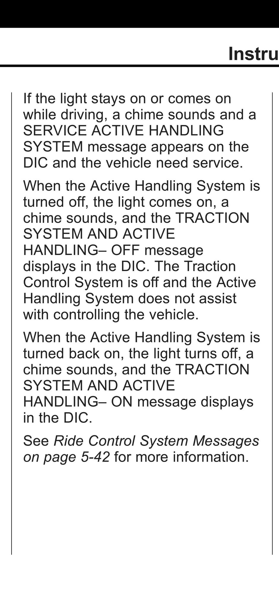

Default cel/tc/active

Default cel/tc
i hope this helps a little
