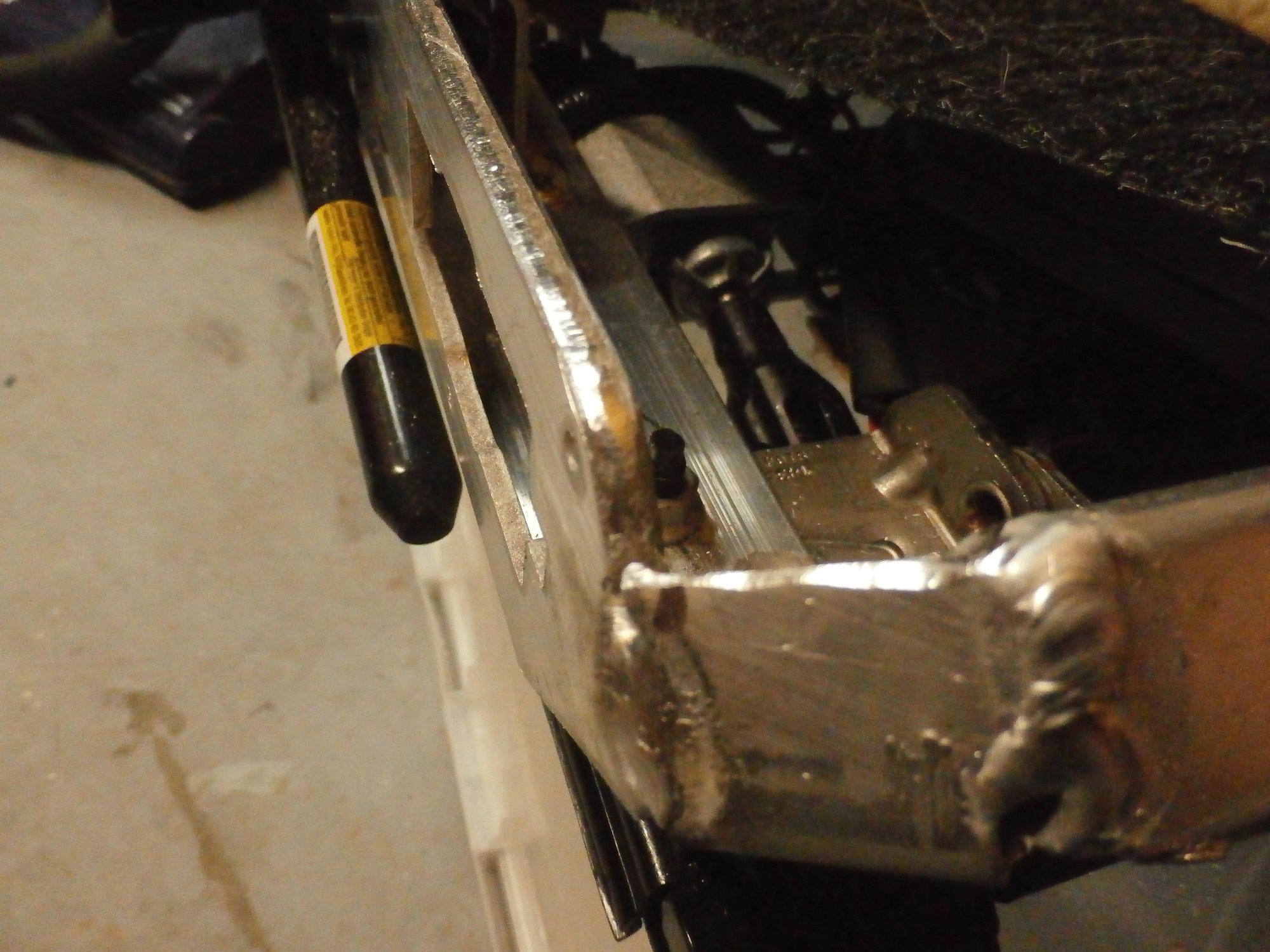

Hi folks!
As some of you may know, I'm new here. One of my two posts so far is about the seat cover replacement. Since posting that to look for a replacement cover, I learned a lot in a couple days. I am offering some of my solutions based on what I saw in the forum.
What I found upon taking the seat apart to remove the seat bottom cover are a couple things relative to what others have posted about. Number one is, the foam was severely cut on one side from the sharp edges of the aluminum frame. One person suggested to put double-sided foam tape on the edge, covered by duct tape. What I did was to take a Dremel tool with a coarse double-cut burr and round over all the edges. I believe this is a better solution. It did not take long to do and it will last forever. It will never cut the seat base foam again.

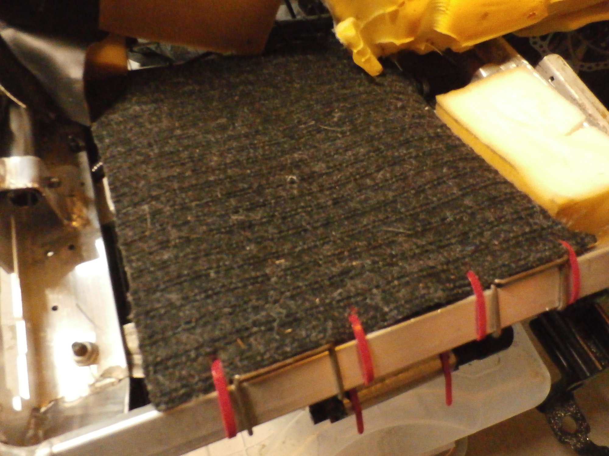

The second thing I did was to cover the wires under the seat foam with a piece if inexpensive floor mat cut to size and held on with zip ties. The wires will never cut the underside of the foam padding again!
The third thing I did, based on what I learned from the forum, was to cut foam blocks to fit in the corners under the seat foam where they tend to sag from weight over time. I saved a huge piece of foam from a couch seat cushion that has come in handy for repairs of this type before,on a motorcycle seat.

Edges of the aluminum frame cut down and rounded over with a rotary tool.
A piece of a door mat I saved was used to cover the wires to prevent any further cutting of the seat bottom foam.
Another angle of the door mat zip-tied on, and the seat foam support blocks at the corners. I think I will put a sheet of 5 mil polyethylene over the door mat, so the seat foam can easily slide a bit, if it needs to.

Good work. Some of us know exactly what you are talking about, as we found out firsthand when installing the seat rebuilt kit offered by forum vendors.
thanks for the great description of how you performed the work.
