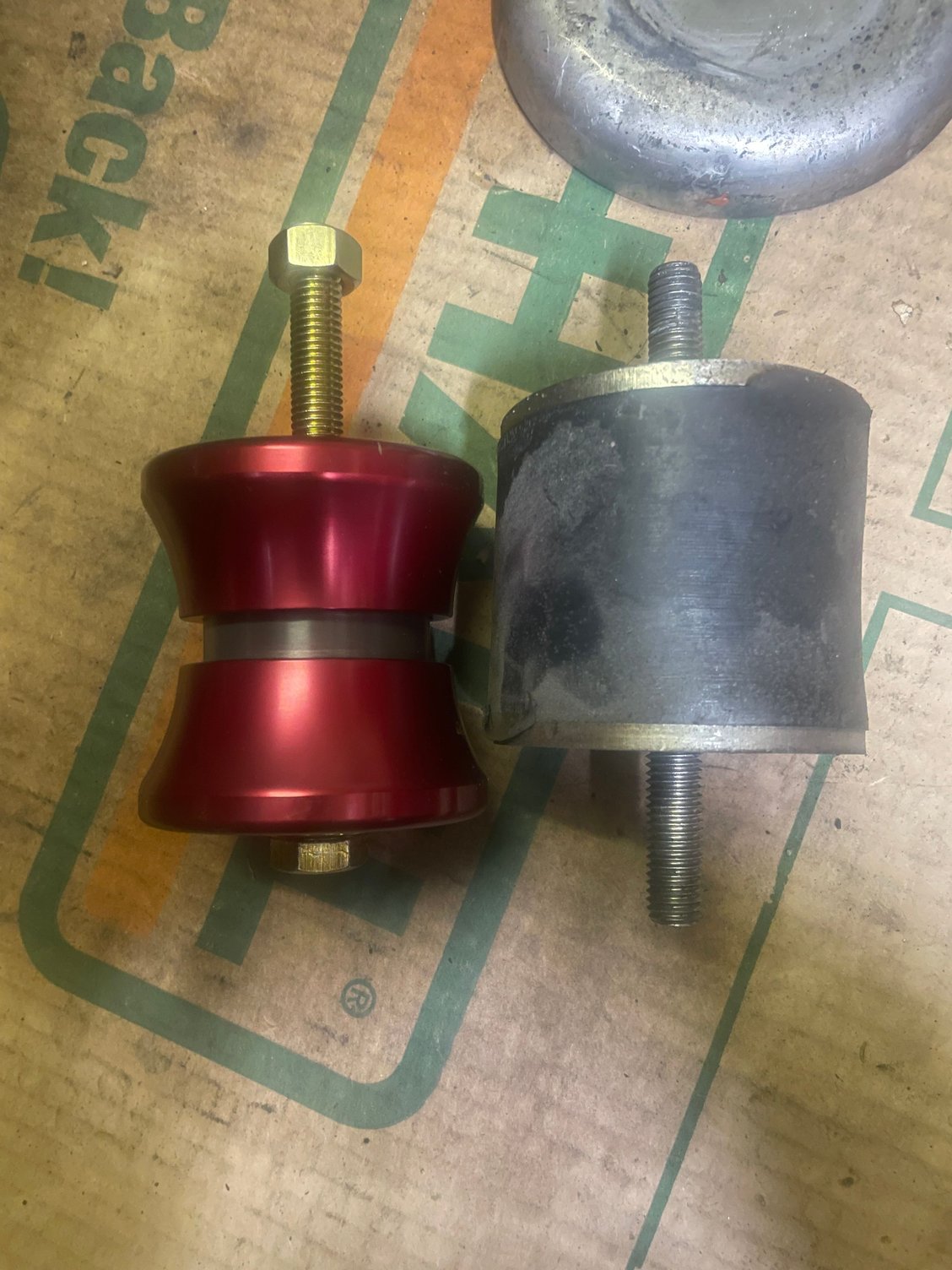

Great build! How do you like the hinson motor mounts?
I currently have the Hinson transmission mounts but will be installing the Hinson motor mounts this spring.
Old Feb 10, 2021 | 05:22 PM
badtzmarui's Avatar
badtzmarui
Joined: Feb 2016
Posts: 22
From: Bay Area
The motor mounts are fine. The interior vibrates if the idle is at 500 rpm, but overall I think it's worth it.

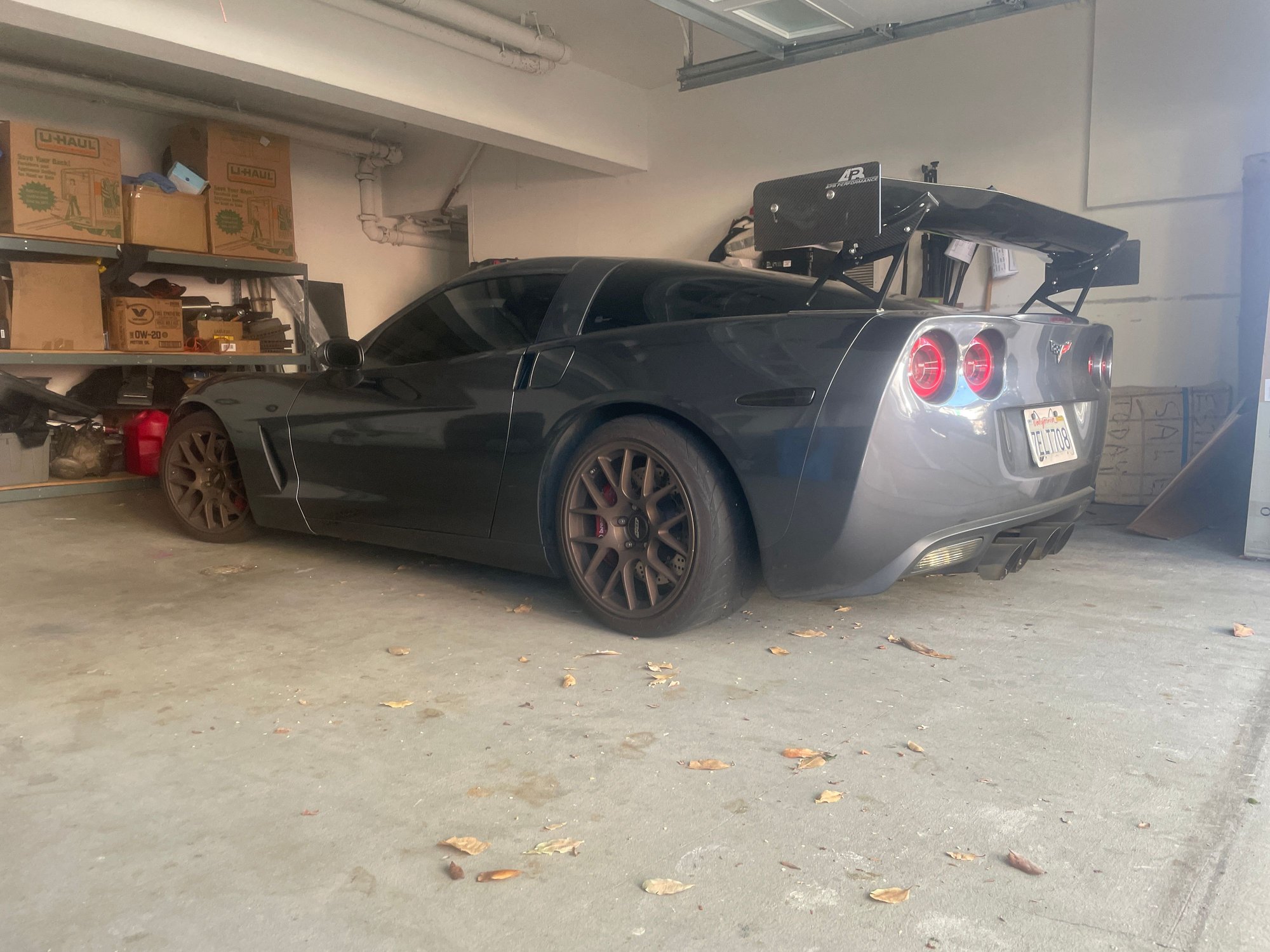

Here are a few pictures of the car now

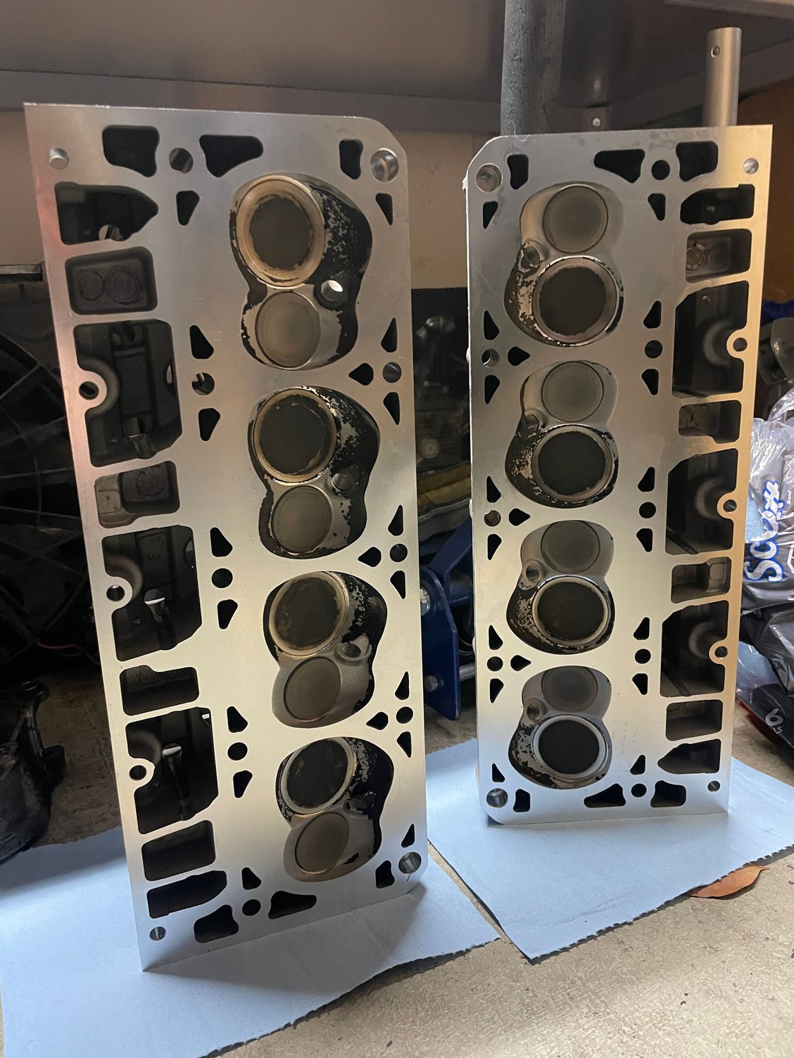

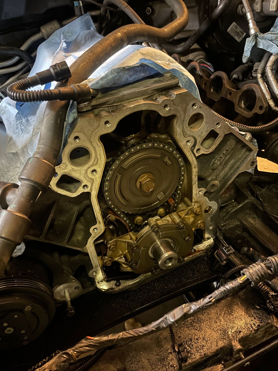

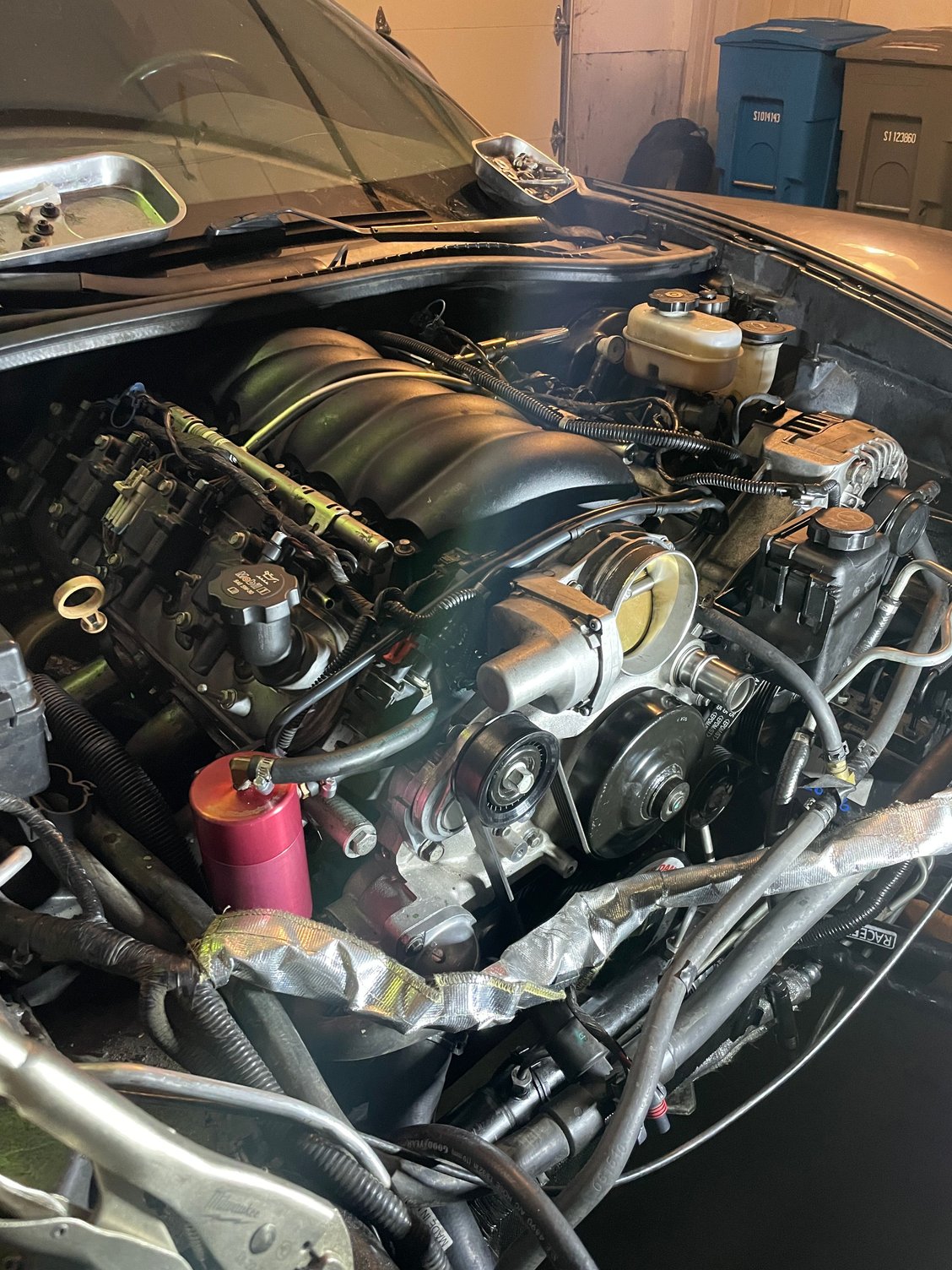

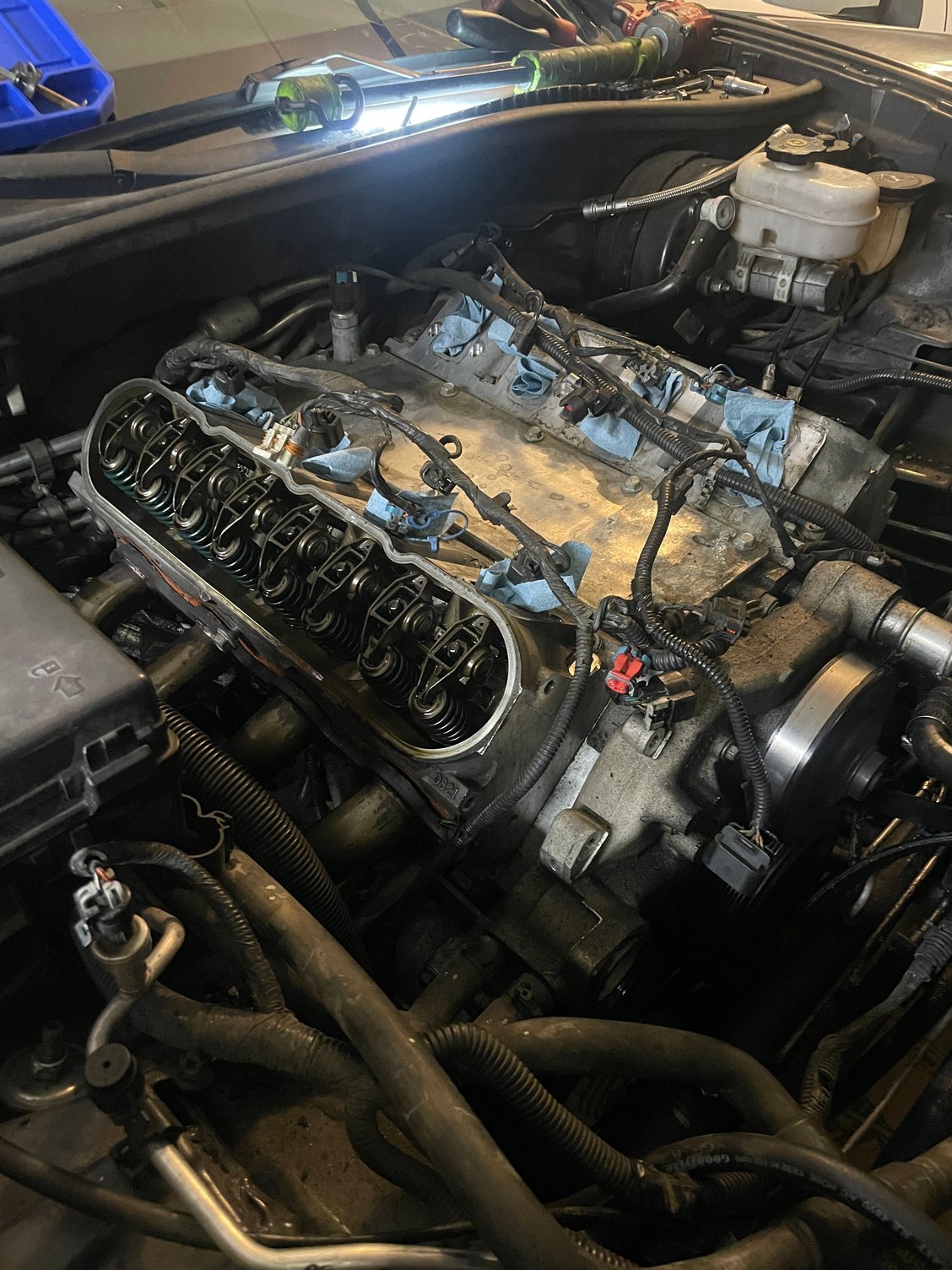

Hey guys,

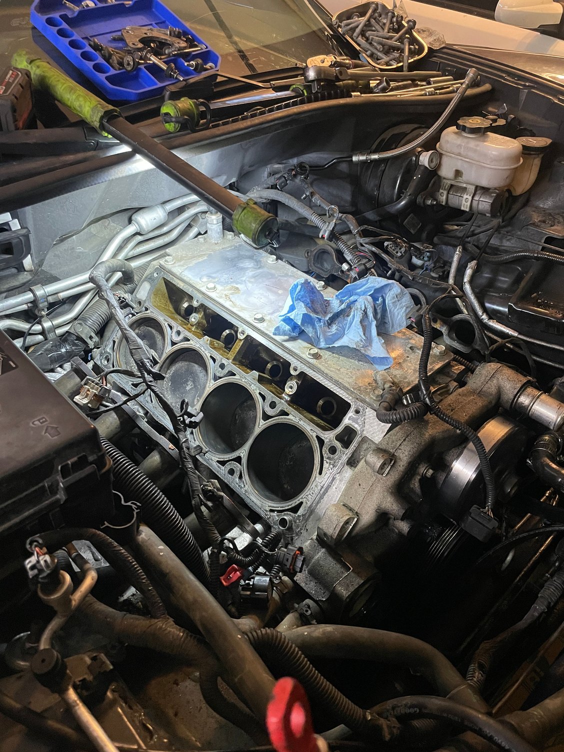

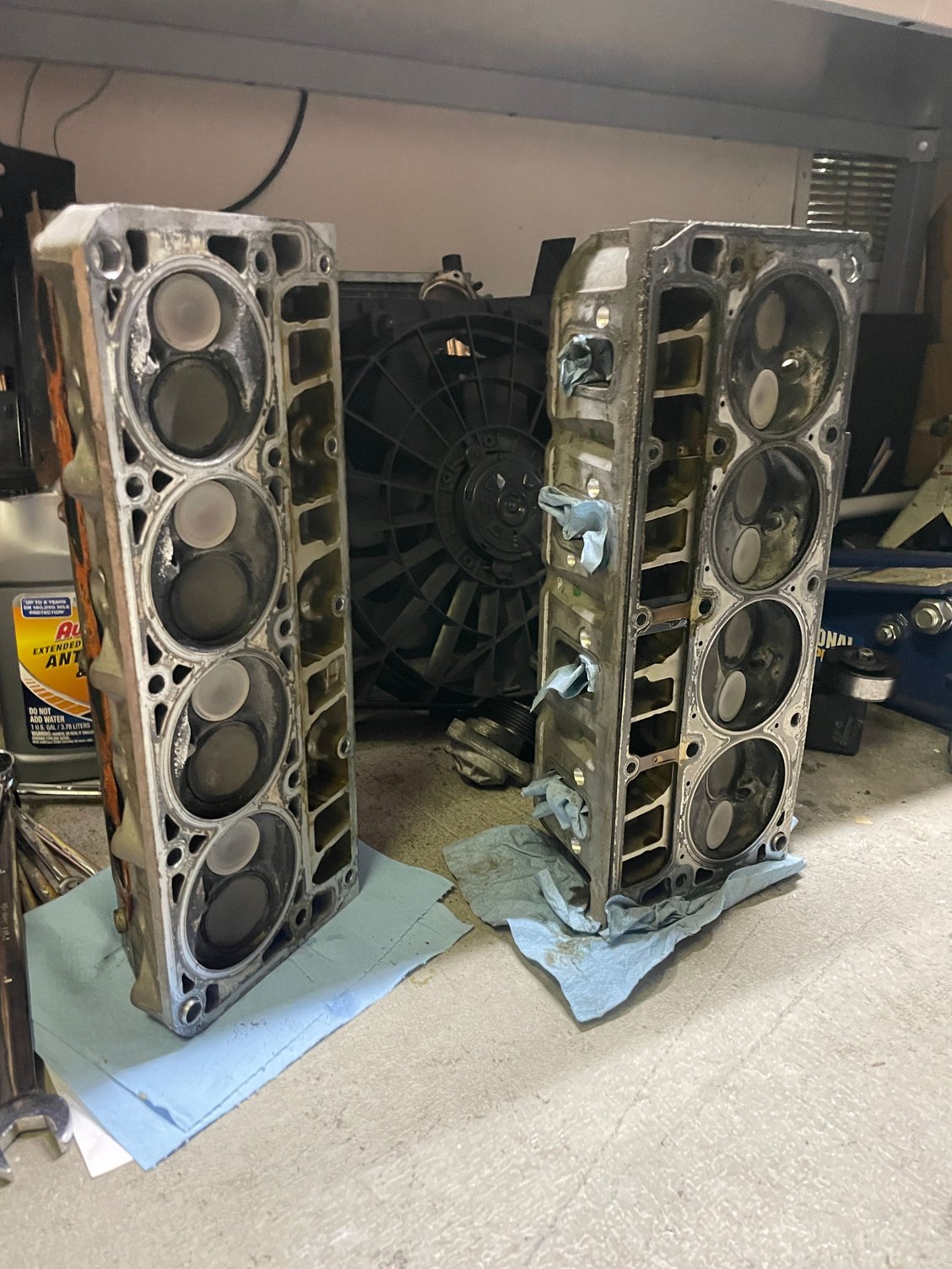

Last October, the car received a harmonic balancer, new head gaskets, water pump, 180F water thermostat and hoses. Cylinder 3 had a stripped spark plug, so I pulled the heads to have the cylinder heli-coiled. I also replaced the head gaskets, lifters, trays and performed the trunnion kit upgrade as the motor had 135k miles.

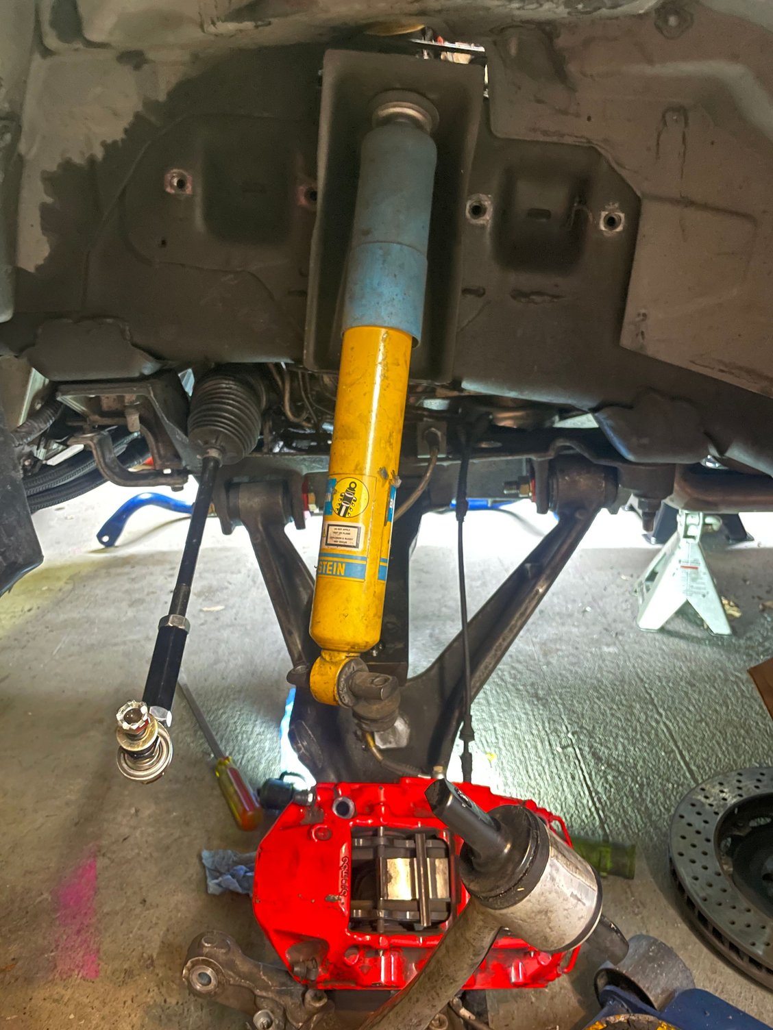

I was finally able to install the AFE Poly Control Arm bushing kit. I also installed upper and lower ball joints, OEM front inner tie rods and bumpsteer kit both front and rear.
I took the car to the track in March and the car has never felt better. It used to have numb steering feel, now it feels like a precision tool.
I previously had a 212F oil thermostat and my oil temps could reach 290F+ before the end of a HPDE session (20 min). I updated to a 180F, now my oil temp reads a max of 275F on the DIC.
