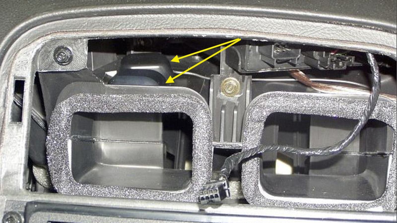

Sorry to hear that, it's worked well for myself and others. Usually most people will put the aftermarket XM antenna on top of the HVAC ducts under the dash behind the center console which is where I had mine before I did the stock antenna mod, and it seemed to work fine, but I think I get slightly better reception now after doing the mod.

Here's a photo of the area I was referring to, you can see in this photo they have both the aftermarket XM and GPS antennas mounted in this location.
