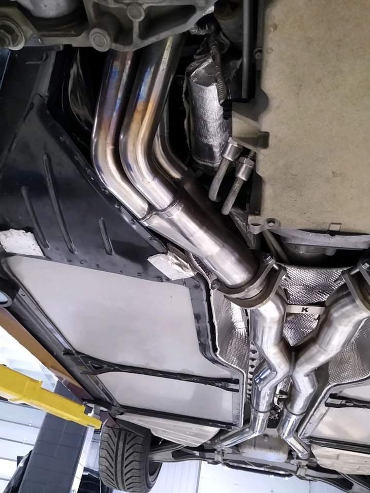

Sometimes I buy used parts. These Kooks 1 ⁷/⁸" headers and H pipe I bought for $900 installed as you see. Since the exhaust was out I supplied a DEI fabric heat shield for around the starter along with tunnel and side plate DEI heat shields.

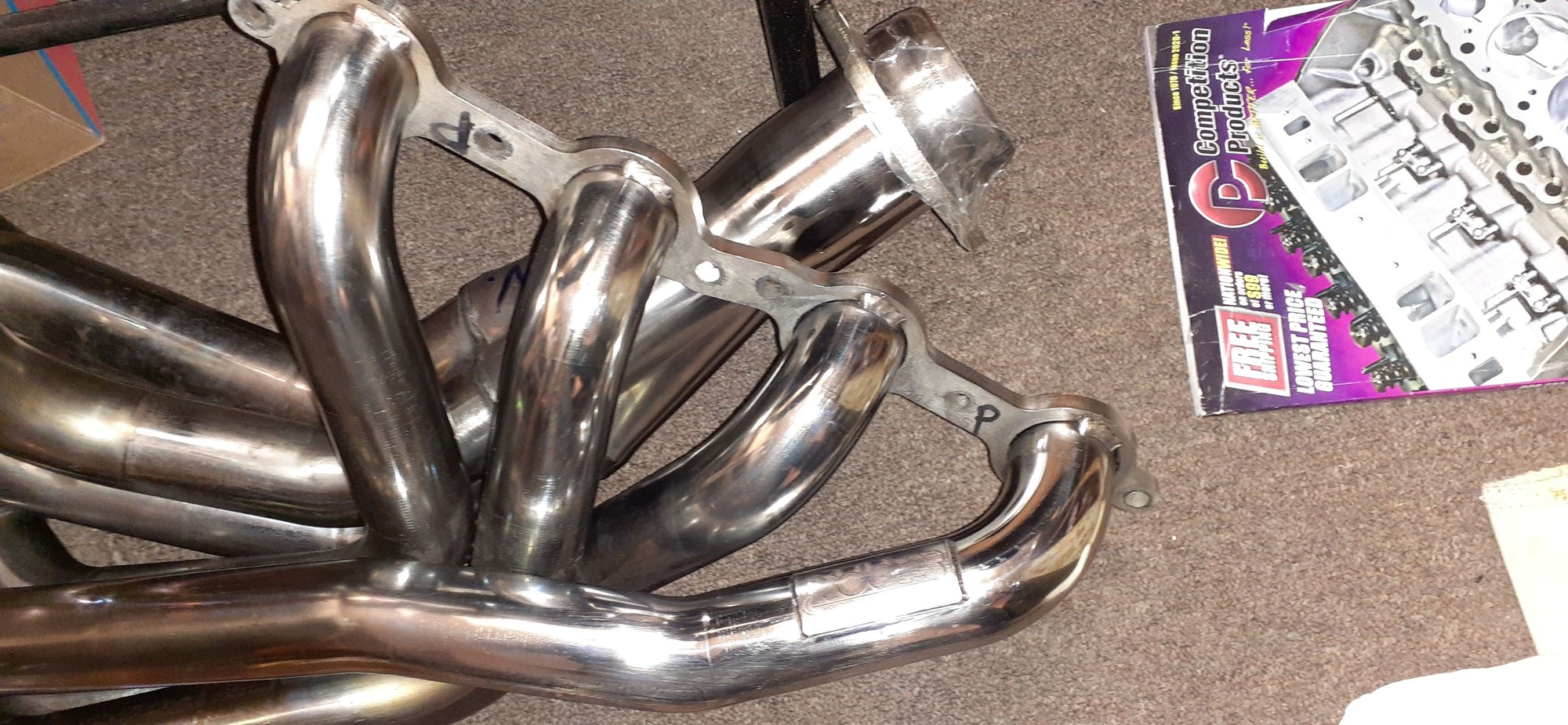

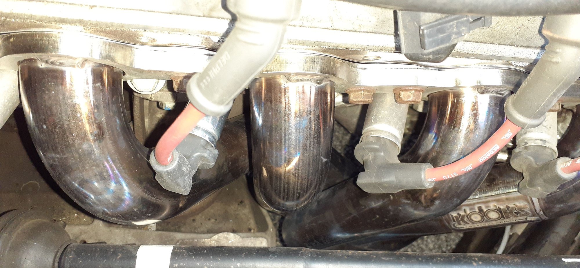

The headers have no dents but were quite scourched from 2 years on the shop's 8 second Procharged project car. With some emery, Flitz and liberal amounts of free Elbow Greaze the headers and H pipe turned out good.
Below are the headers before the Flitz-elbow greaze mix....
After ...

The 1st pic shows that inexpensive DEI precut stick-on drive shaft tunnel, heat insulation before headers & Hpipe are installed.

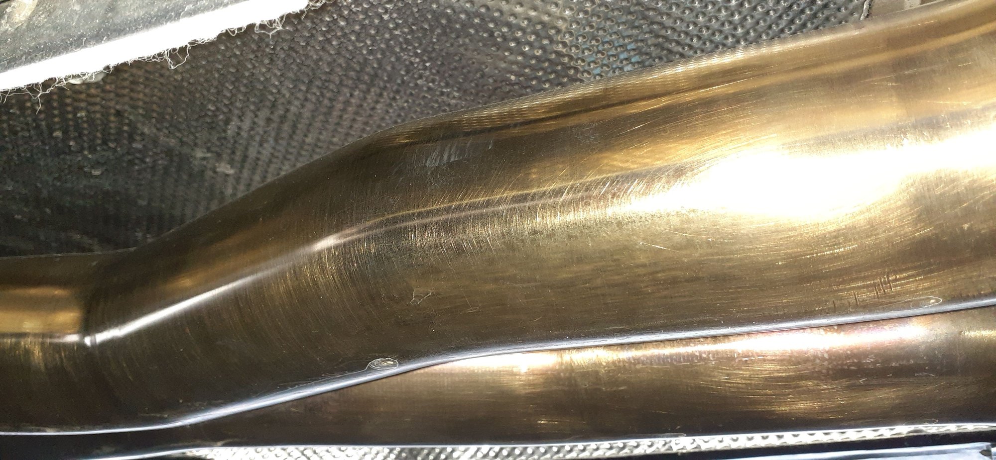

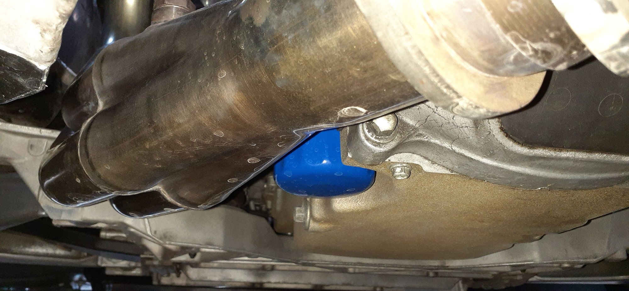

Stainless steel will polish up (unfuck) good no matter how bad it looks. But the chrome like shine doesnt last long under heat.
Here are pics of what was polished stainless after only 135 miles and a dozen or so WOT boosted street pulls.
Thanks
