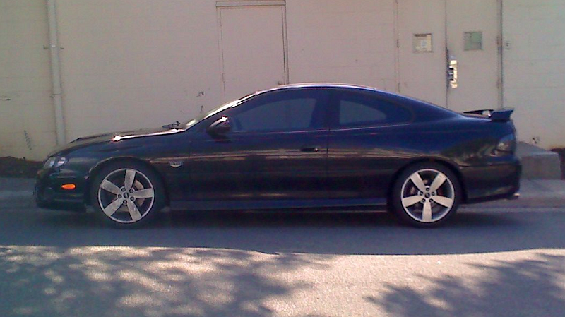

I ran far more rake on my LS2 GTO, and I loved it (it was lightened and nose heavy as well):
