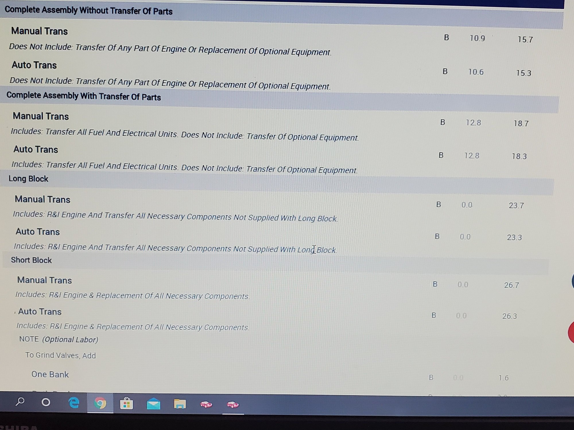

Here is what alldata calls for.

GM Book time is about 20 hours for the LS3. Multiply that times their shop rate and you have your labor quote. I work at a large Chevy dealer and our labor rate is $139/hour so you'd be $2780 in labor plus tax and shop fees. They may charge a little extra for the radiator R&R as well but $3750 seems pretty steep.

They shouldn't be adding time to R&R the pressure plate and clutch disc as that and the flywheel have to come off to replace the engine anyway, thus that time is included in the engine R&R. Some shops may quote additional time for the clutch...which is shady practice.
