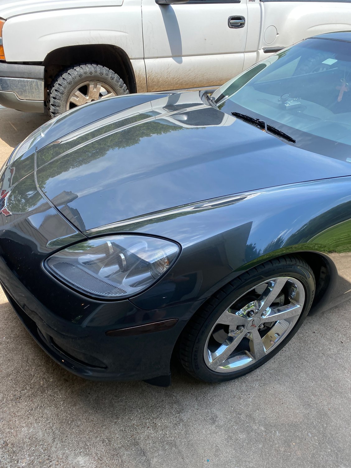

From a distance
Looking down the hood. The clip is good also

Originally Posted by southofHoustonVette
Bottom photo shows a gap caused by the to pieces not being lined up properly. There's a little pin that has to line up and snap in for the fender to fit properly. I hope this helps. Anyone who has ever taken the headlights out will know exactly what I'm talking about.
Dave
Dave

The locator next to the clip holds the bumper down, the clip holds it close to the fender.
not sure what I am looking at here
In post #6 you can see your bumper lifting where it meets the fender. The pic I posted shows the clip and locator that holds the bumper down. I suspect your clip is broken (common) or the locator is missing. Here are a couple of PDF files I got from another Forum member that may help.

Yes fixed in under 10 minutes. Was amazing
