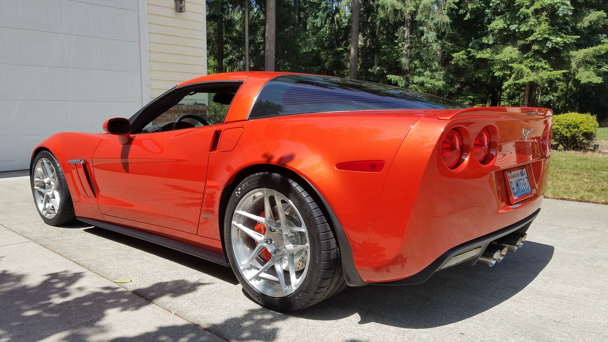

RedC6Ed, 1) You should take your concerns to the Car Care Section
2) Are your small chips thru the clear coat into the base coat ????
3) On my Inferno Orange car I used a AC Delco touch up Pen. Wearing a headlamp
and holding magnifying glass in one hand and the pen in other you just "dab" a drop into
the chip/hole. I let it dry for a day and then used my orbital buffer and a fine cutting polish
to remove the Blob............Im no Expert but this work for me
4) On my clearcoat chips I was able to just polish the clear enough so as to remove "most"
of the imperfection
There are a lot of threads on this at the AutoGeek.com forums and on YOUTUBE
