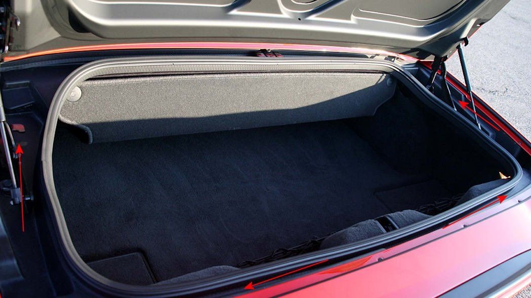

Have you carefully checked the trunk seal weatherstripping to assure there is good adhesion to the body all the way around?
Pull back the inner trunk carpet, on each side, then pour water in the space between the weatherstripping and the fender (red arrows) and watch for any water dripping or leaking into the trunk area.
Good Luck

Originally Posted by BigAnthony
Pour it inside the trunk at the rear corners? What will that tell me?
It will tell you if one side is plugged up and allowing the water to stand around your seal and if either side is cracked under the hinge.
