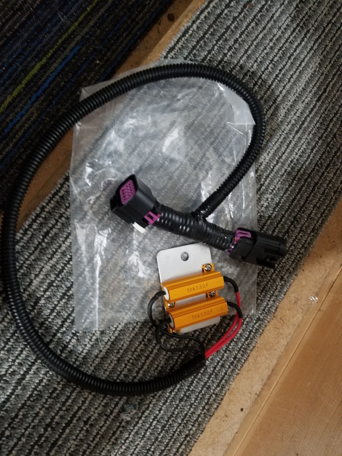

TripleB5832's Avatar
TripleB5832
Joined: Feb 2019
Posts: 1,049
Likes: 599
From: Tennessee
Originally Posted by 2008 Corvette
The wire colors are different on a C6. If you do not want to splice into your wires, Sharp Light Innovations makes a plug and play harness for the C6.
^^^^^What he said. I got the Sharp Light Innovations harnesses for both, rear and front lights and they are well worth it if you like the factory no-splicing look. Rear is pictured below; it connects to the C6 main harness that feeds all 4 rear lights. I did not take pics of the front, but each light plugs into the C6 harness individually up front, one resistor for each light. No drilling at all; there are places on the frame to mount the resistors that Sharp Lights provide. The front was more difficult to do, but there is a nice place on driver side and passenger side to mount each resistor to the frame. Quality resistor harness for front and rear by Sharp Light Innovations, excellent.

darkfader's Avatar
darkfader
Joined: Jan 2020
Posts: 123
Likes: 68
From: West Virginia
I also have the sharp light harness. Couldn’t have been easier. You’ll need a washer and another nut like in the picture above. I left the factory nut on that stud and then slipped the harness bracket on top and tightened it down. Takes roughly 90 seconds to install, and no splicing of factory wiring.
