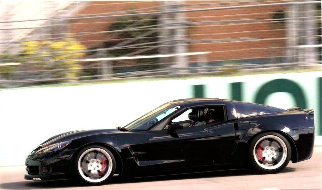

I tracked mine and used manual mode on the track. I will tell you this, if you are going to do it, upgrade your brakes, and get a transmission cooler. You will go into limp mode when the tranny heats up. I did the upgrades and had an amazing time on the track with it.
