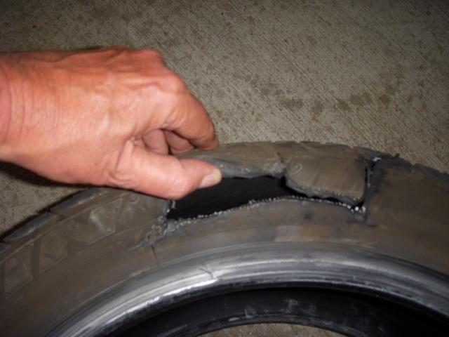

Plugged one front run-flat with a plug-kit, had another rear run-flat patched inside by Discount Tire......went another 25K miles on those
tires without an issue.
I swear by run-flats after following another C6 for 110 miles @ 60 mph to the nearest small town. Obviously this run-flat pictured below couldn't be
repaired, but it's reputation was proven when you drive without a spare in isolated areas. V V V
$aved a huge tow-charge as it went 110 miles
