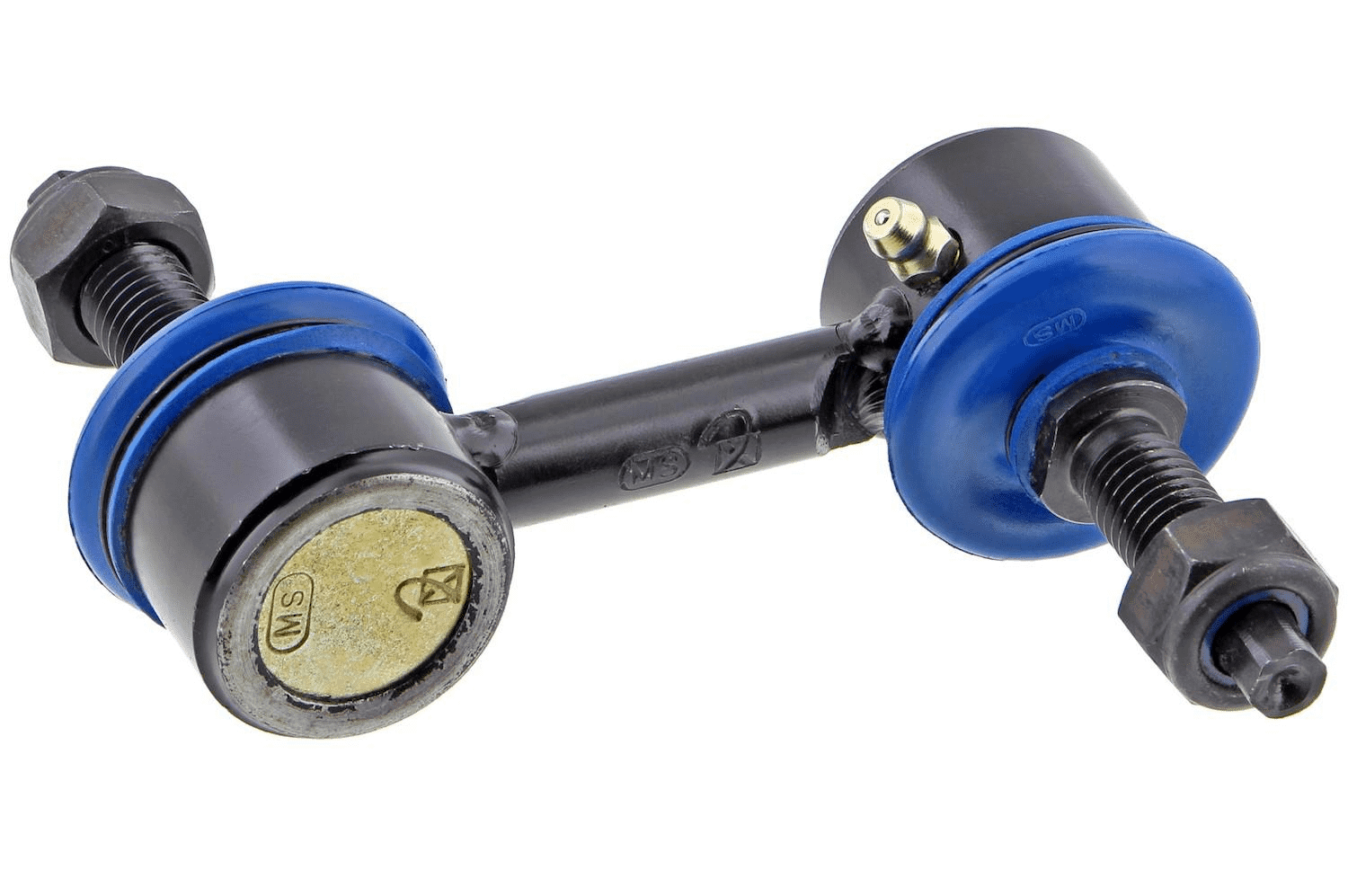

My drop links were the cause of my squeaking. I changed out all 4 with MEVOTECH Supreme MS50823 and no more squeaking.
