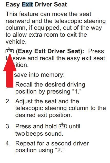

In the DIC, AUTO EXIT RECALL is set to YES but upon exiting in PARK the seat moves all the way forward.
I have no idea what button the red arrow is pointing to.

Its the button on the door right between the 1 and 2.

Thanks I should have worn my glasses the first time I looked for it. All is well, the seat now stays back when entering and exiting.
