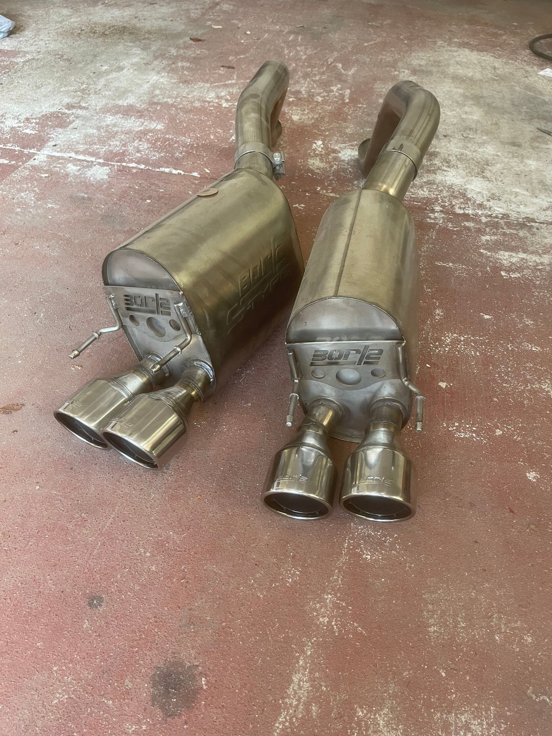

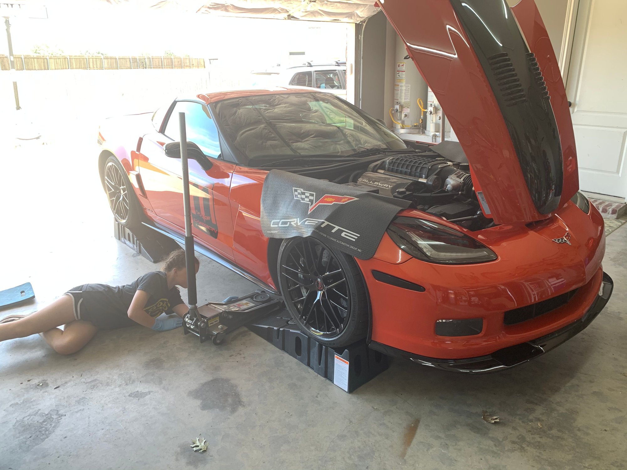

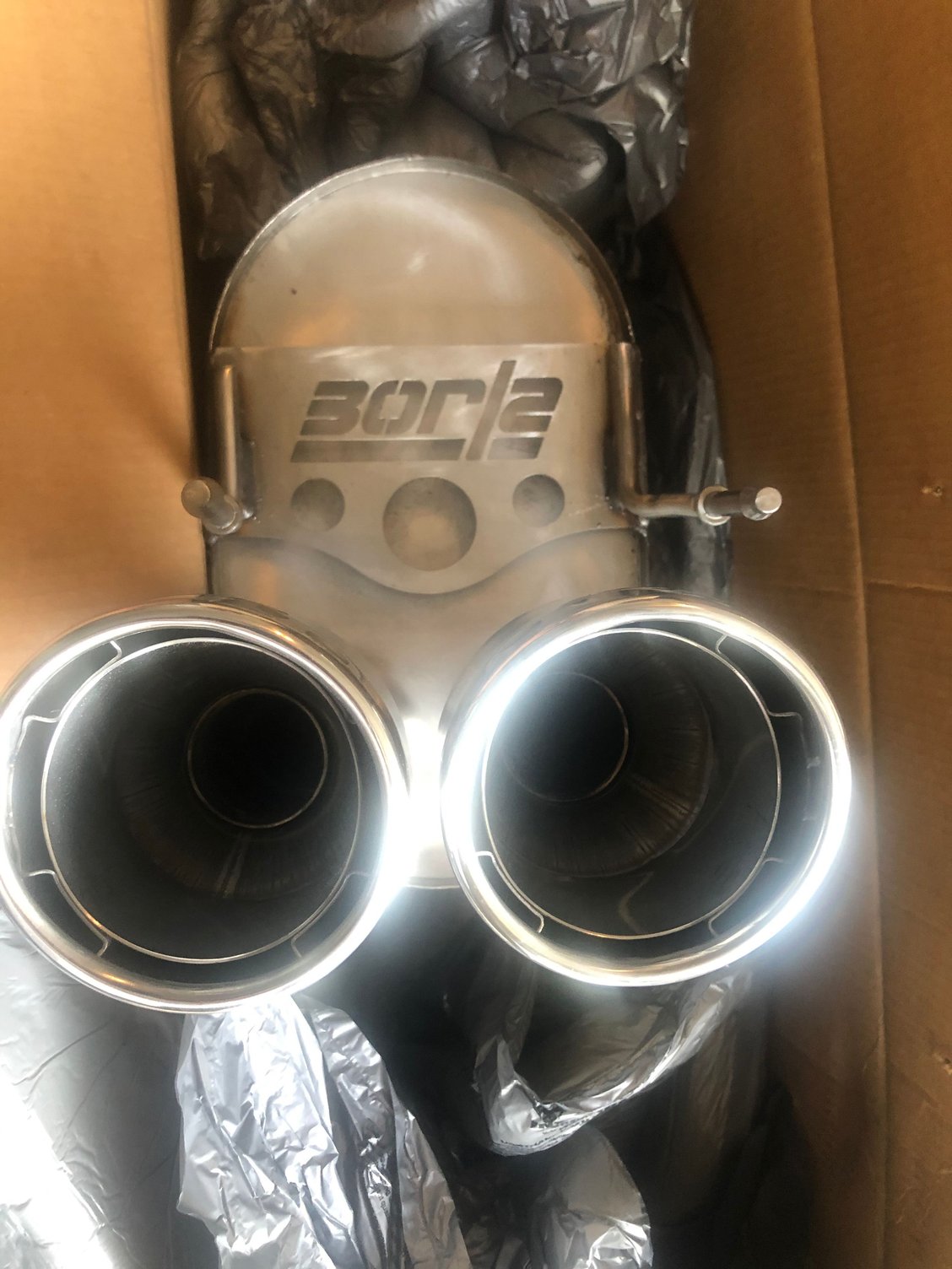

I should be receiving my Borla S Type II axle back today. I kinda want to install this at home. How high does the car need to be for this? What’s the best way to jack up the entire rear end?
I’ve always jacked cars up under the rear and chunk. Not sure if this is safe to be done on my C6Z.
my buddy has a shop with a pit I could use and a lift also, but I really don’t want to bother him with it. Thanks in advance.

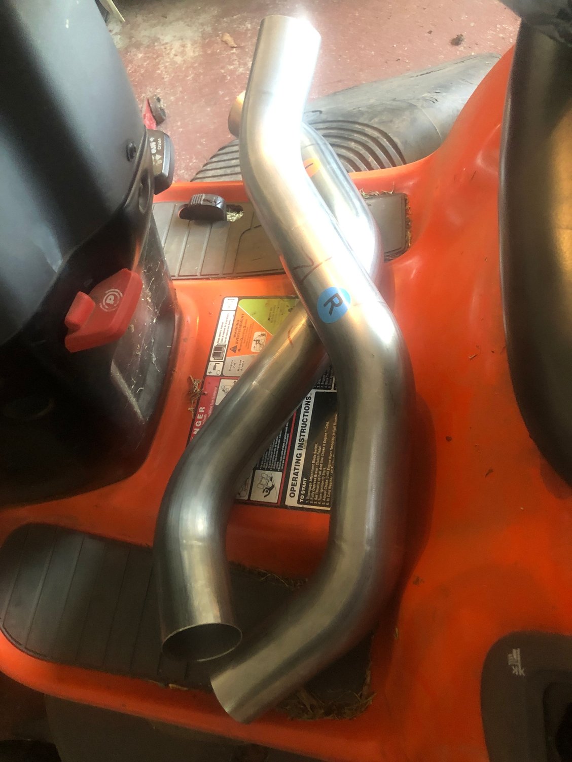

It is always easier on a lift. Is the car an A6 or M6. I ask, because I have an A6 and it is a real pain even on a lift to get the over the axle pipe off on the passengers side, so I just cut mine as I was not planning to reinstall the stock system. On the ground it can be a PITA even with it jacked up and it need to be a lot higher then what you do to change the oil or remove the wheels. Besides to get it high enough you need some real good jack stands. I would also want some secondary support. If you have access to a lift I would be all over that.

Thanks guys. I’m glad I posted here. My kit just showed up and I was about to go jack it up.

Much easier when the over axle pipes are separate.

Grab yourself a pair or 2 of rhino ramps, $39 ea for the pair & the car will be high enough to swap the exhaust

i do have a set of rhino ramps I use on my lowered Tahoe. I also have a set of the truck ramps as well, which are taller than the rhino ramps. I could put those out back for the extra height. I am curious of what it’s going to sound like with the new exhaust. I may try it tomorrow and see how it goes

I did mine in the garage on Race Ramps, was plenty high enough. Should sound awesome.

I did mine with just the rear up on Rhino Ramps. I had to take the sway bar loose from the end links so I could rotate it out of the way and gain more room. From there it was just figuring out how to move/wiggle/rotate the over axle pipes to get them out. There was no excessive force required.

well I got it on. Had a hard time removing the passenger side muffler, so I cut it at the muffler. Got tired of fooling with it. It’s “LOUD” I was hoping for something quieter, but oh well.
