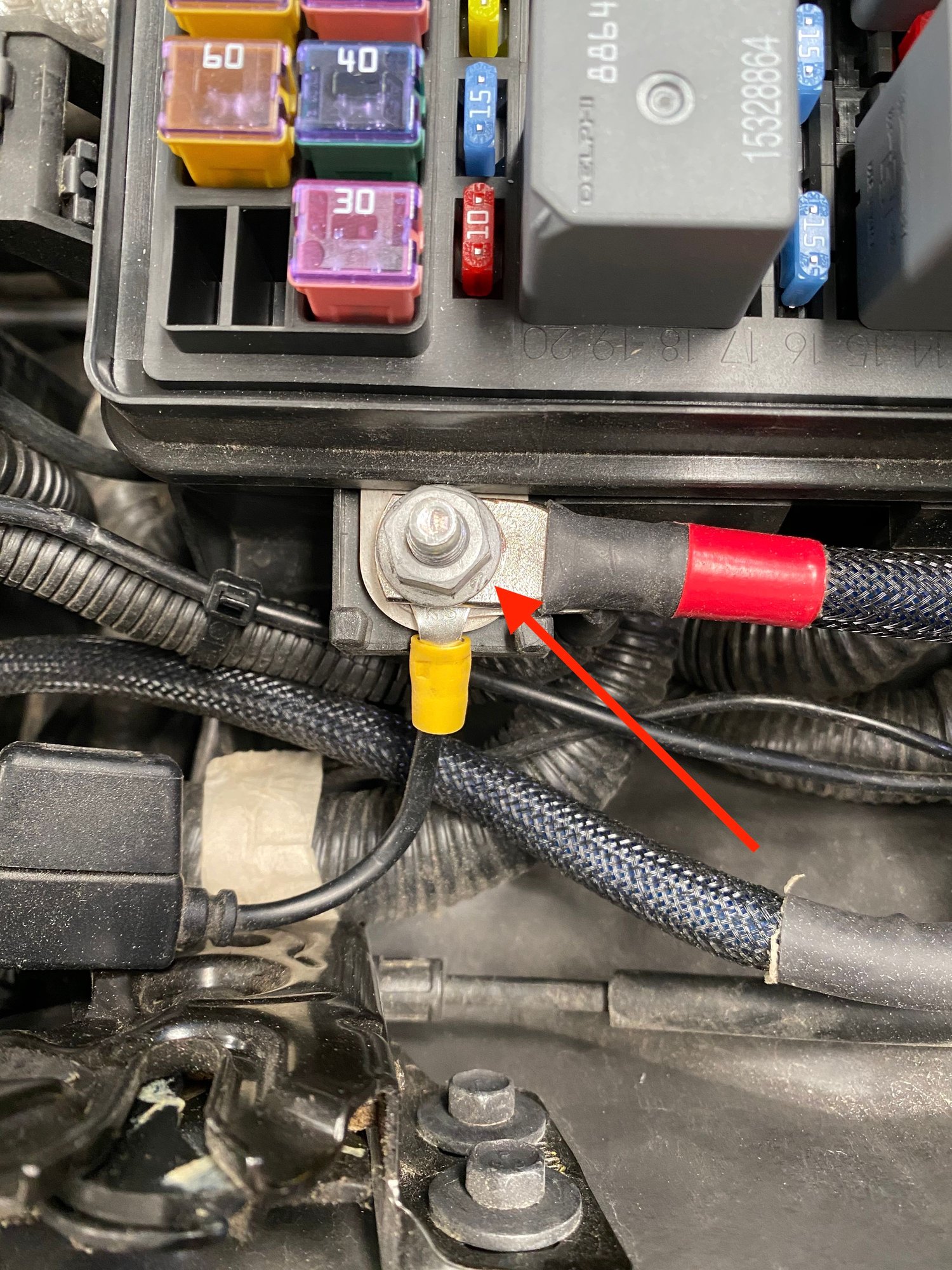

Another way to do it is If you have a battery tender, connect the positive to the stud shown here that you can see when you open the under hood fuse box cover, and the negative to a good ground, then plug it in, remove and reinstall the battery, this will retain your memories like the other methods mentioned above. Whichever method you choose, just make sure the positive battery cable doesn't come it contact with a ground when changing out the battery.

madsonp, (or anyone else)
Can that terminal be used to jump start the car? Or be used to charge the battery?
Both. The manual actually recommends using that terminal for the positive cable when jumping the car as opposed to the battery.

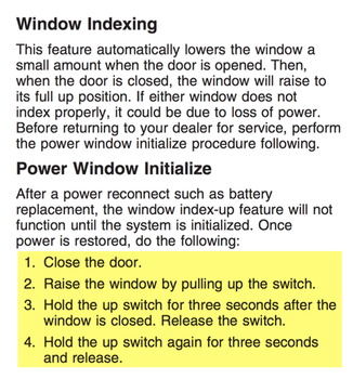

Procedure from the C6 manual.
GD

Originally Posted by Tim2013
There are multiple threads on this but it is easy to do. Mine is a convertible so windows must be indexed. Close the door and run the windows down then all the way up, hold the switch in up for 3 seconds and you are done. Tim
Thanks-I will give it a try.
