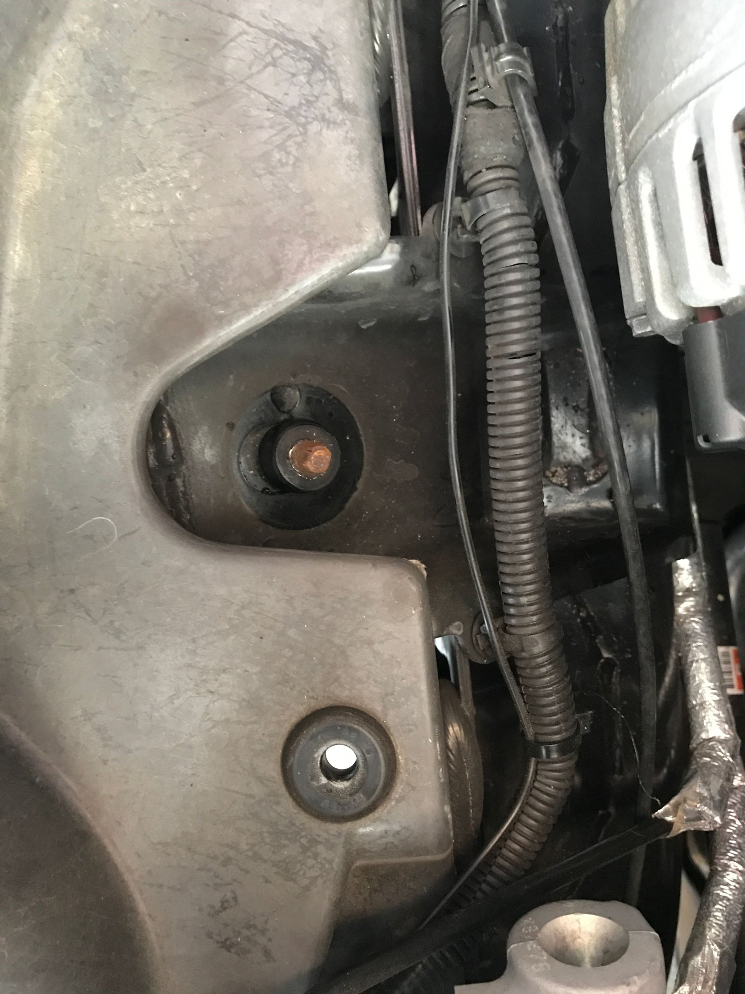

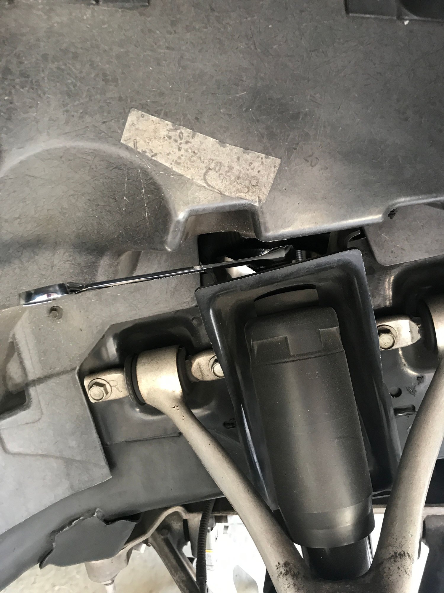

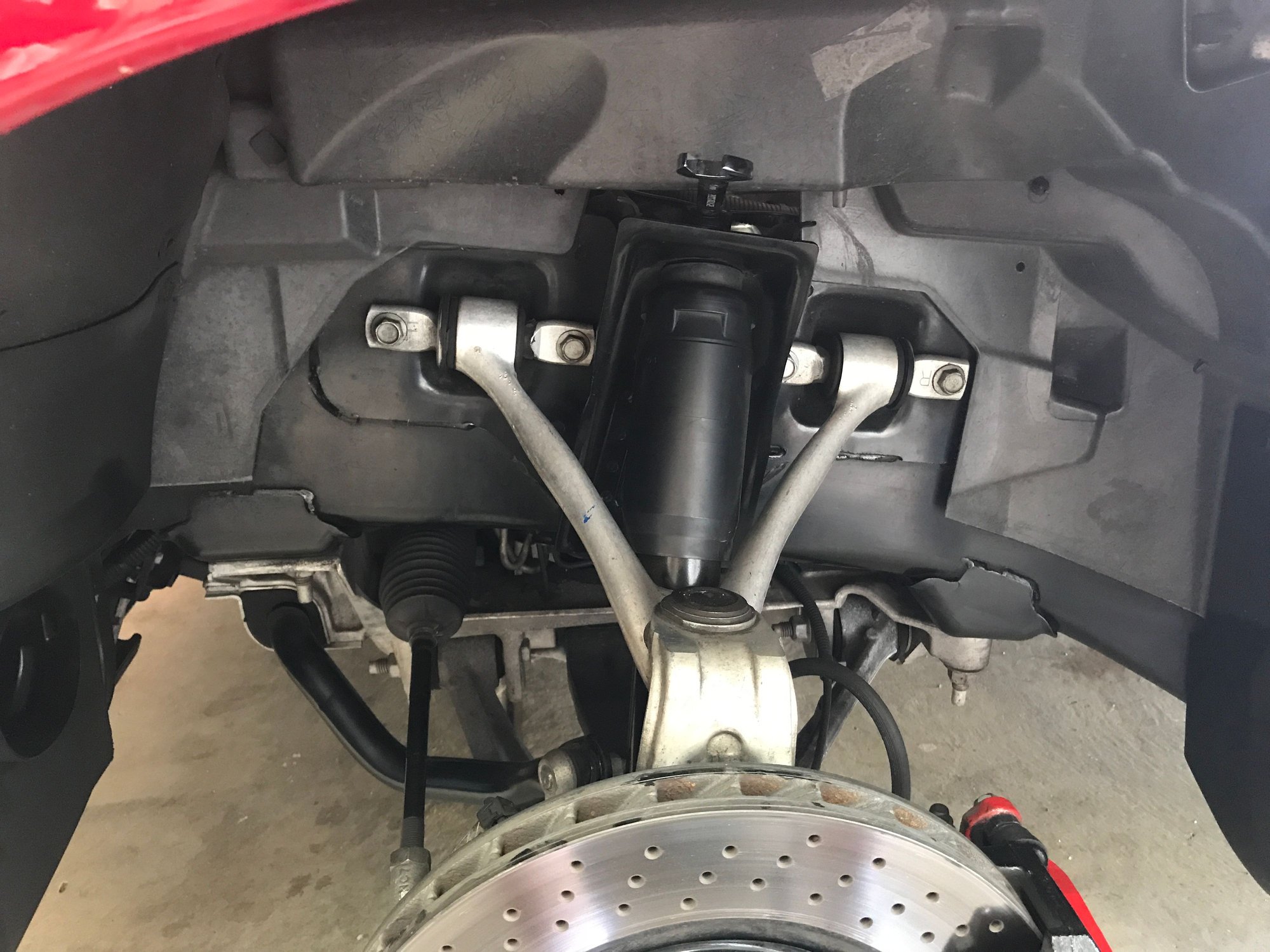

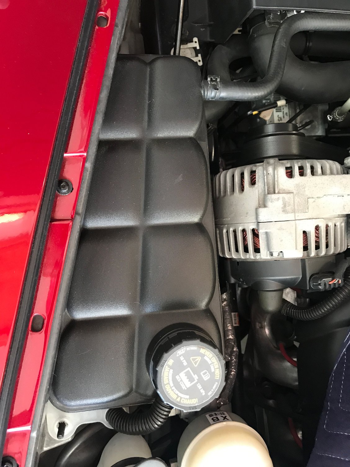

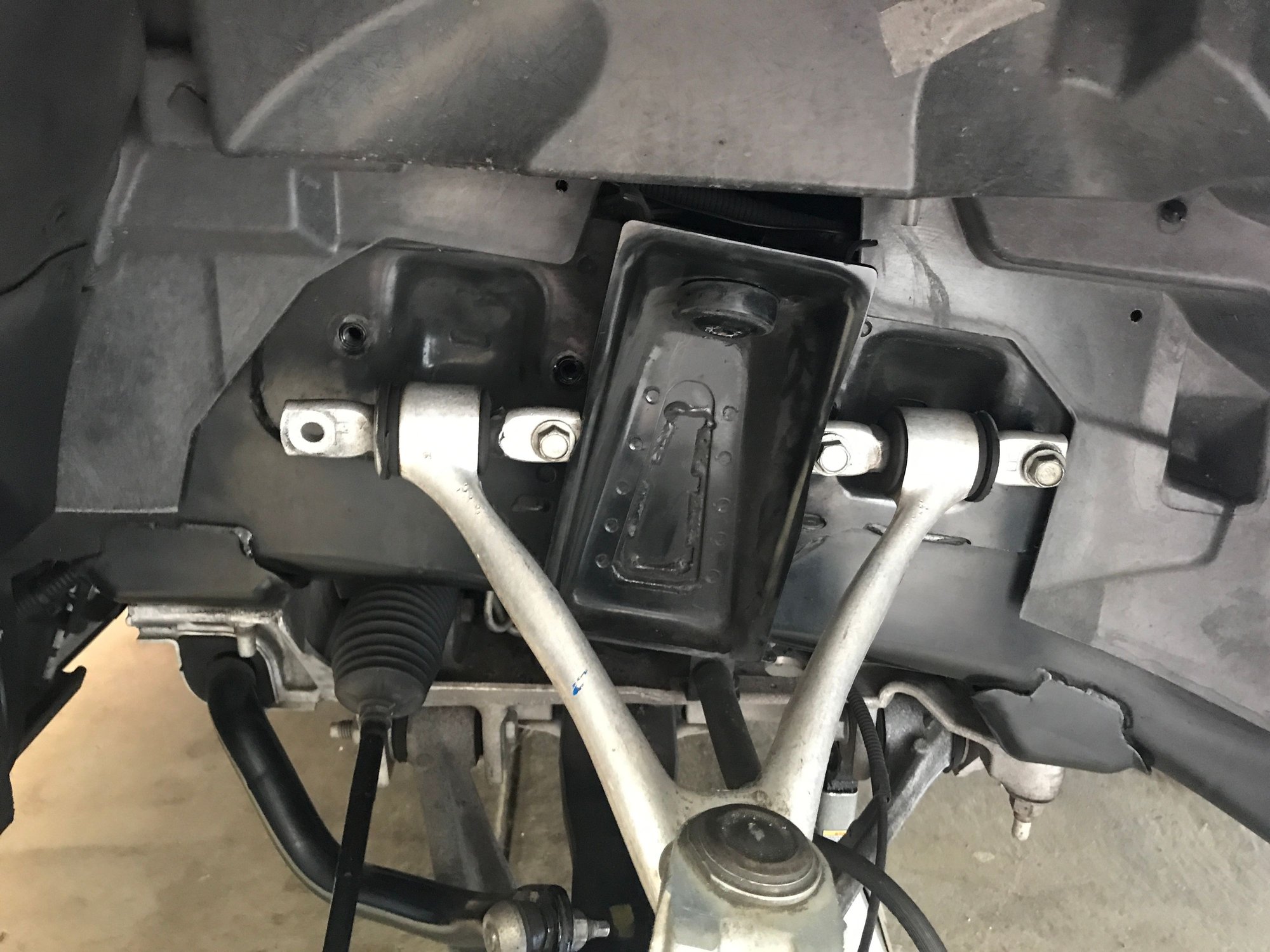

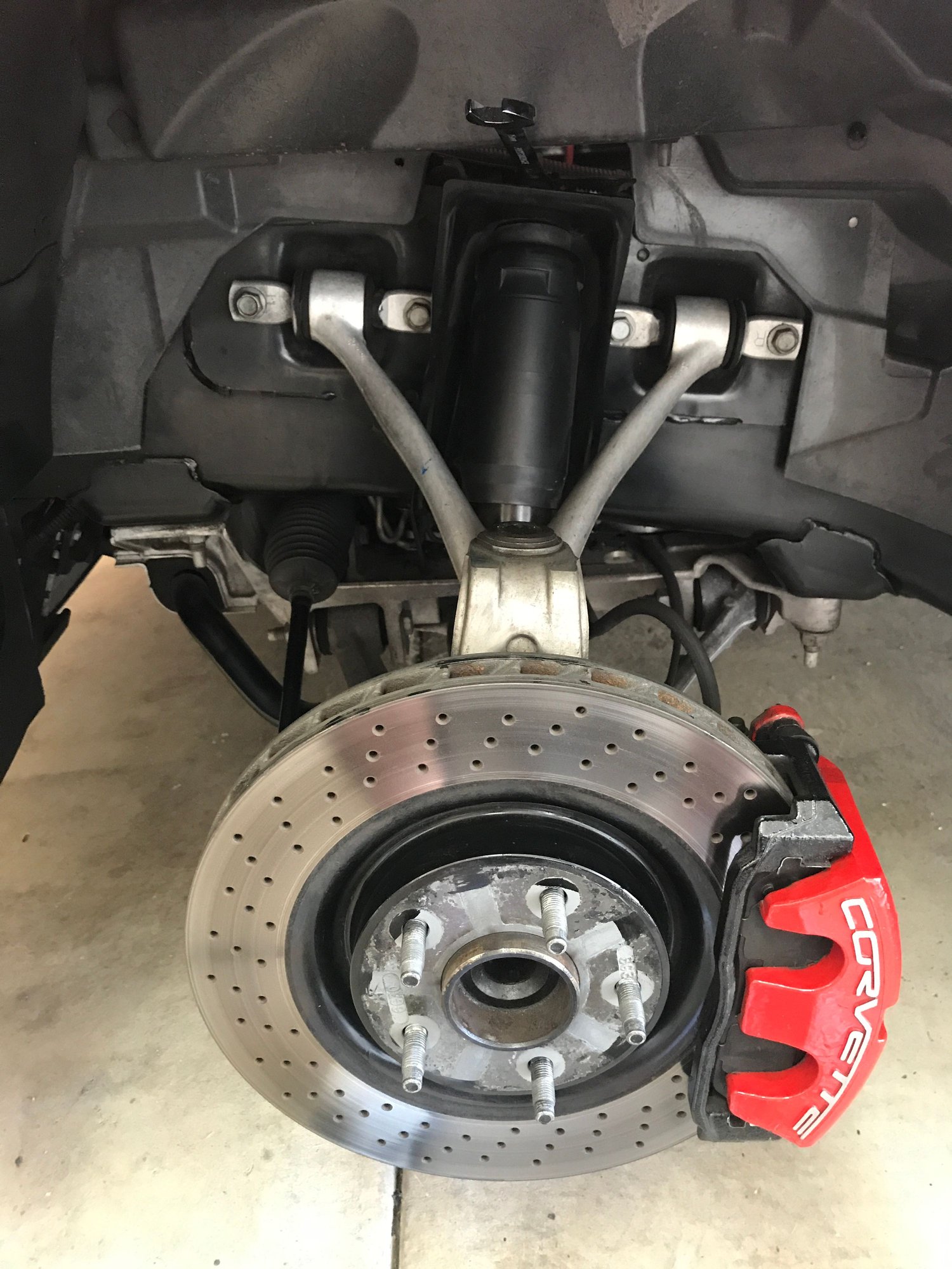

So here are some pictures of a set Bilstein's I installed today. About four hours total. It was a lot easier that I've researched. Tools used Lisle 20400 15 and 17MM box end and 15mm 1/2 drive deep socket. Jack stands
Drivers side Front with 15 MM ratcheting combo wrench
Remove overflow tank Two 7/16 nuts

I removed the four 15mm bolts holding the upper A-Arm Old shock out
New shock in

New shock in
Top of the shock mount. Use the 20400 Lisle
Remove overflow tank Two 10 MM nuts
