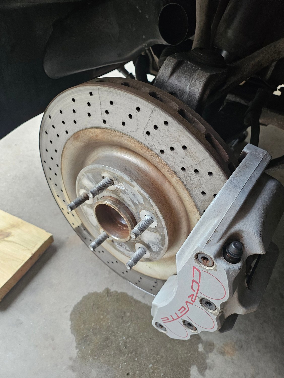

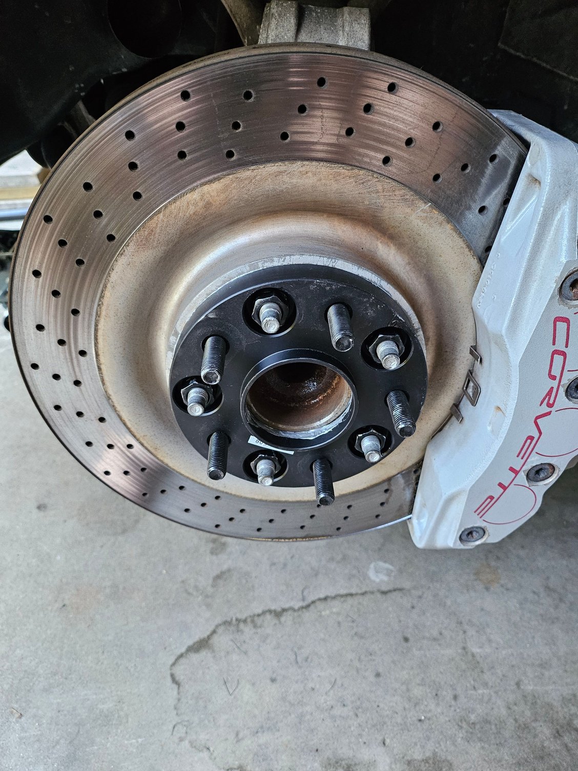

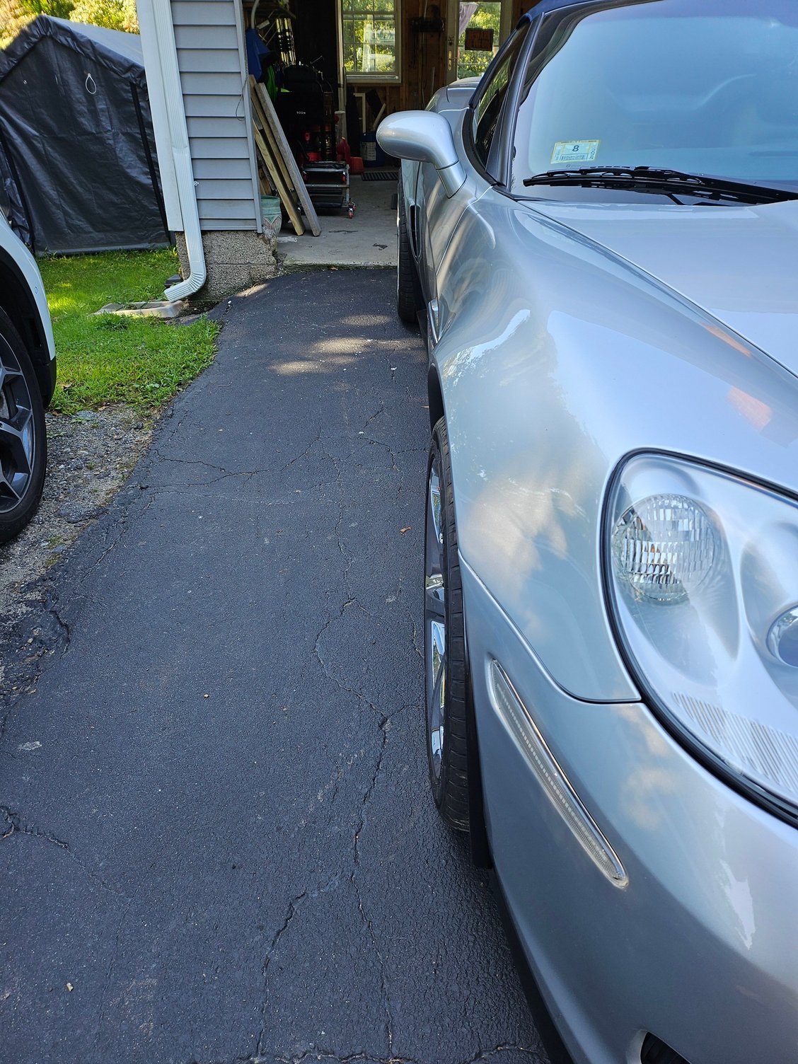

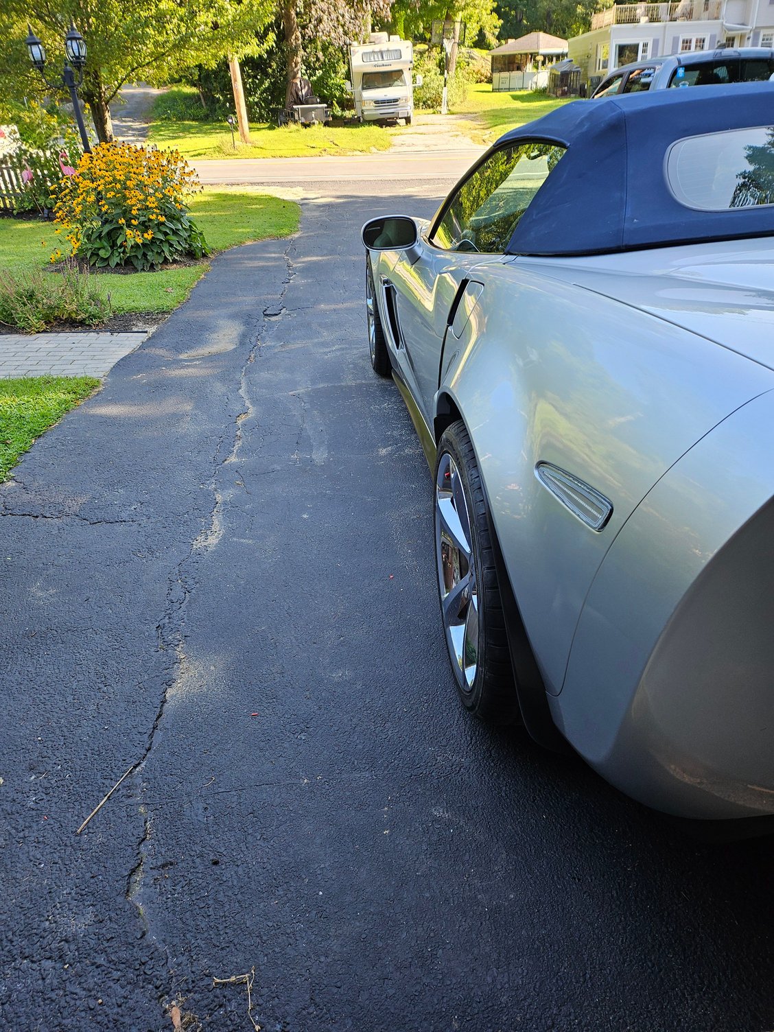

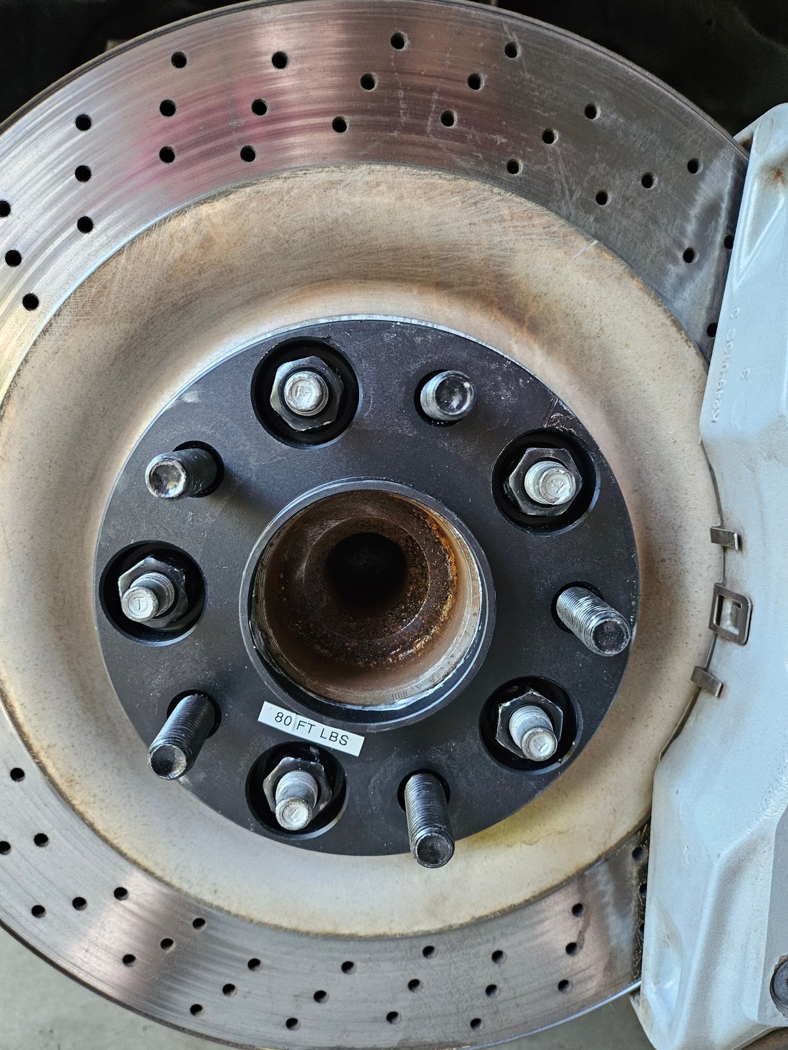

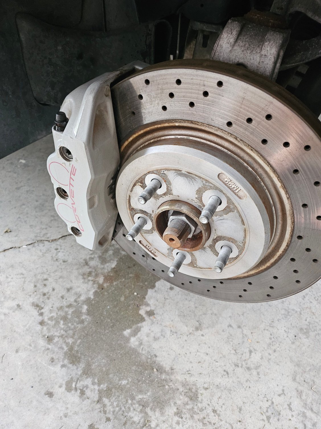

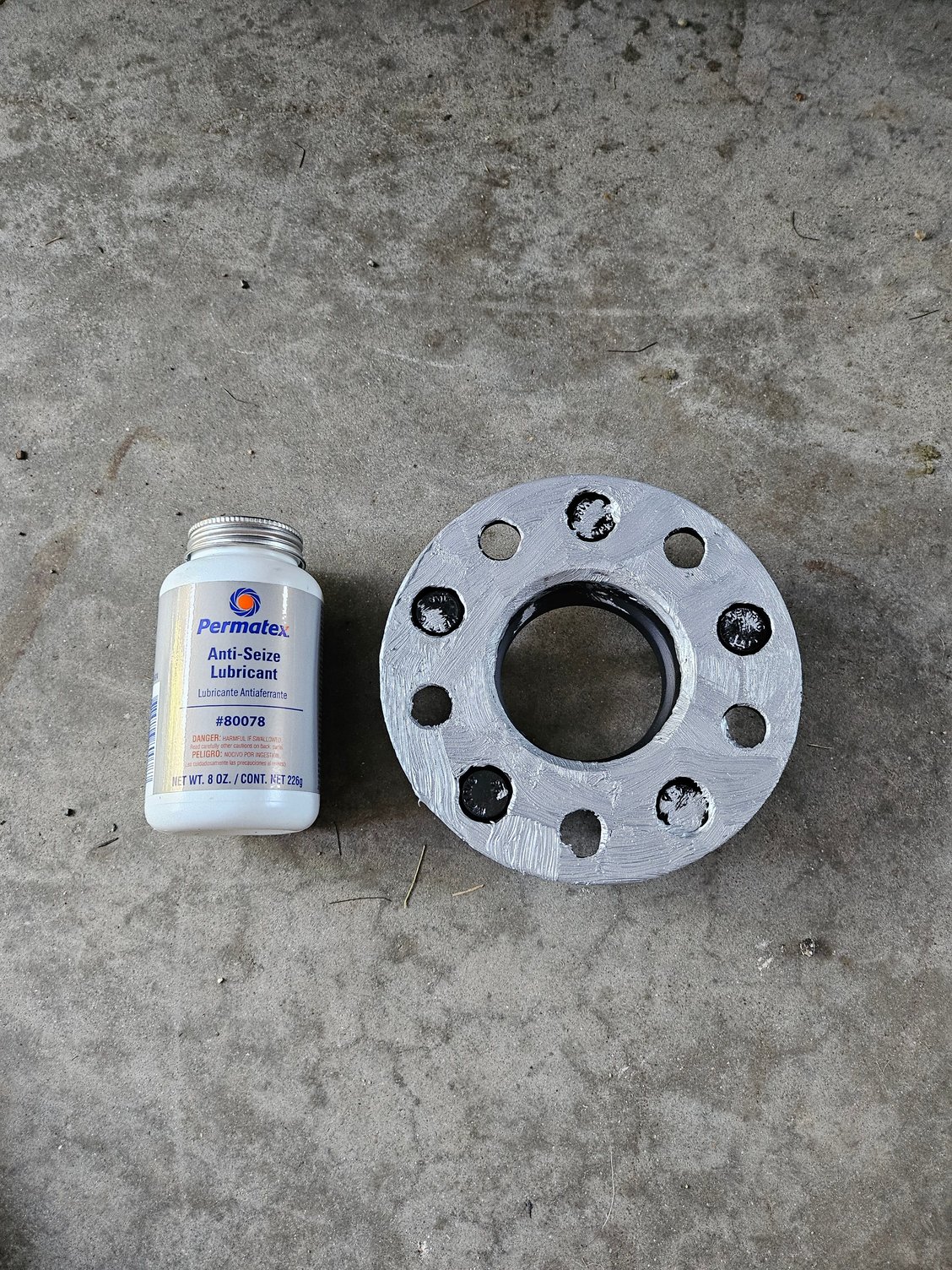

Ok So Will try to post pictures in order of install with 20MM Spacers, car drove supper smooth, not sure if it was me but seemed more responsive, but it was early morning and havent drove car in a bit so could be just me!
Cleaned Hub
Cleaned Hub
Not sure of the Metal to Metal but why not be safe, never read in here of people coating before install.
Spacer on Hub
Yes little **** today LOL tagged each spacer with 80 Ft Lbs. So Tire Stores will know.
Finished
Finished
Finished

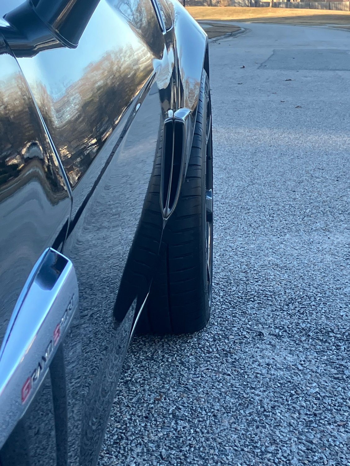

Came out nice! The wheels are pushed out just right. Is that a blue top on your car or just the lighting?

They look good but i was taught in both gm and ford brake courses to never use anti seize on anything that could get hot fling off and go to the rotor or brake pad. I’m not sure how much you put on but I’d take about half of that back off
I just did a light coat so the metals don't weld themselves together. Noway for never seize to leak out and cause issues. The benefits out way the risk on that.
But agree you would not want anti seize on your calipers or pad backings. One would have to use Brake Grease myself I never have used it, but once I think.
