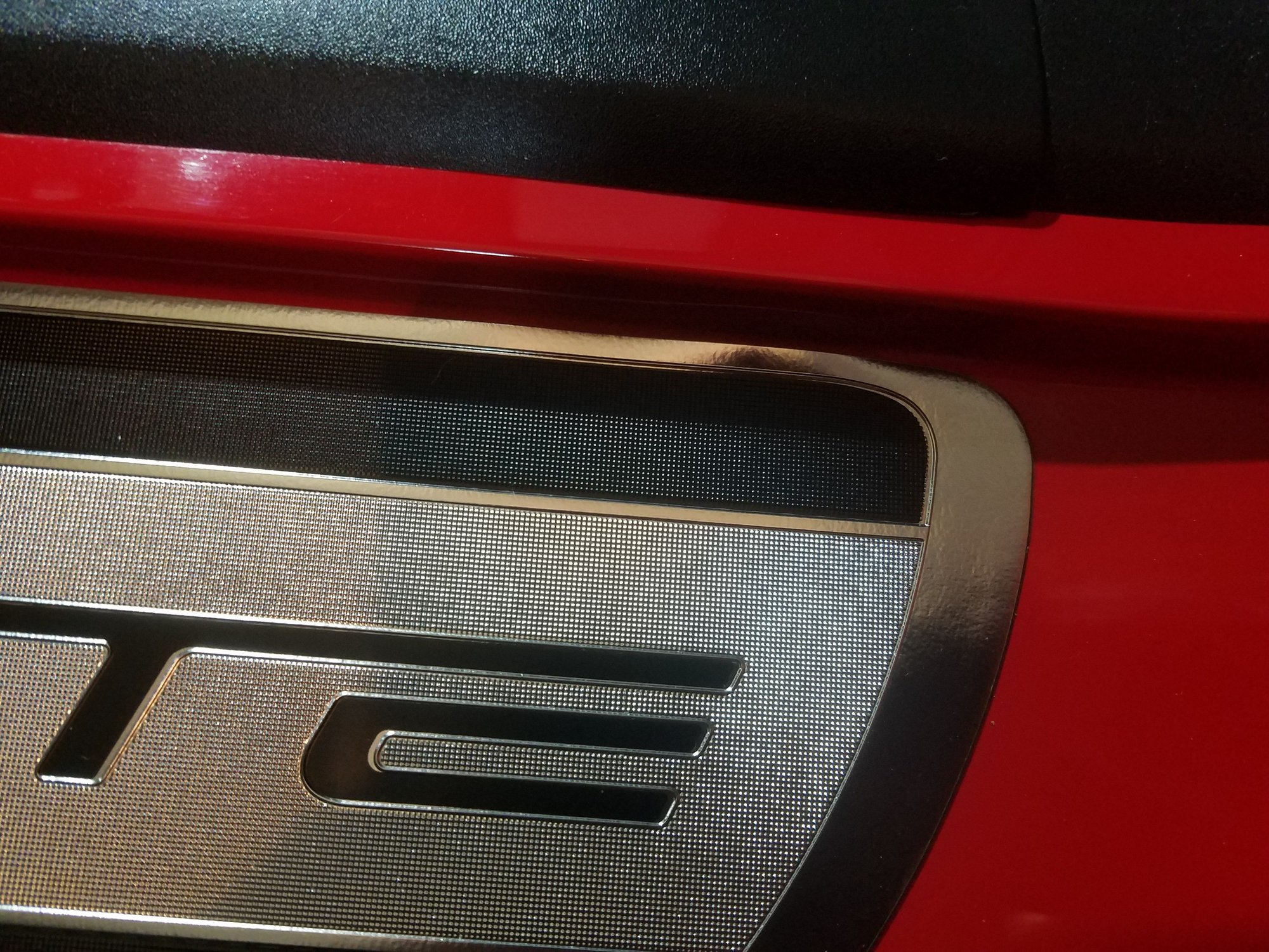

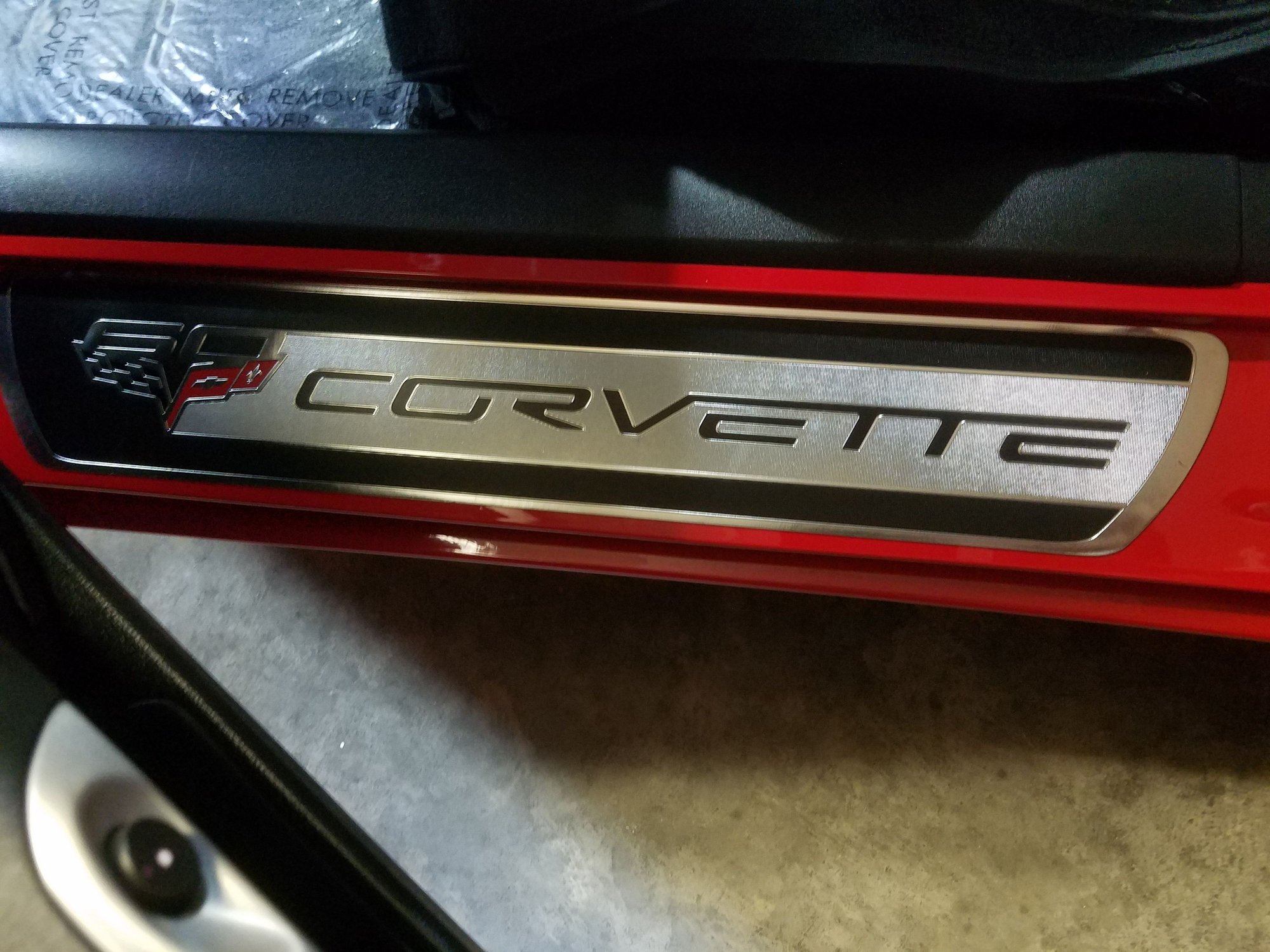

What is the best way to remove? Need to replace (peeling up on edges.)

Heat gun or hair dryer.

Try some strong monofilament nylon fishing string. While applying heat, catch the edge of the sill and pull backwards. May be easier with two people. One holding the hair dryer, another the string.

Heat gun or hair dryer and dental floss or light fishing line too use as a floss underneath. Just keep at it . It will come off.

it's the residue that was a PITA to get rid off, the sills came out pretty easily with a hairdryer

The ones on my ‘12 GS just peeled right up and left behind very little residue that was easily removed with goo gone.
