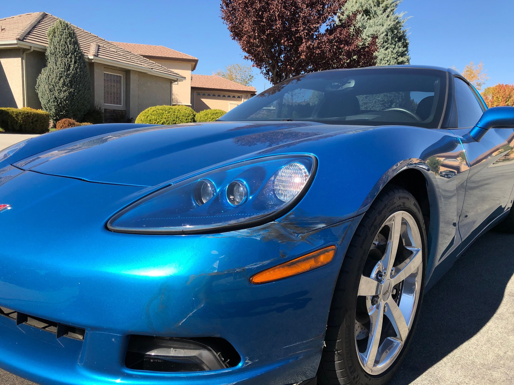

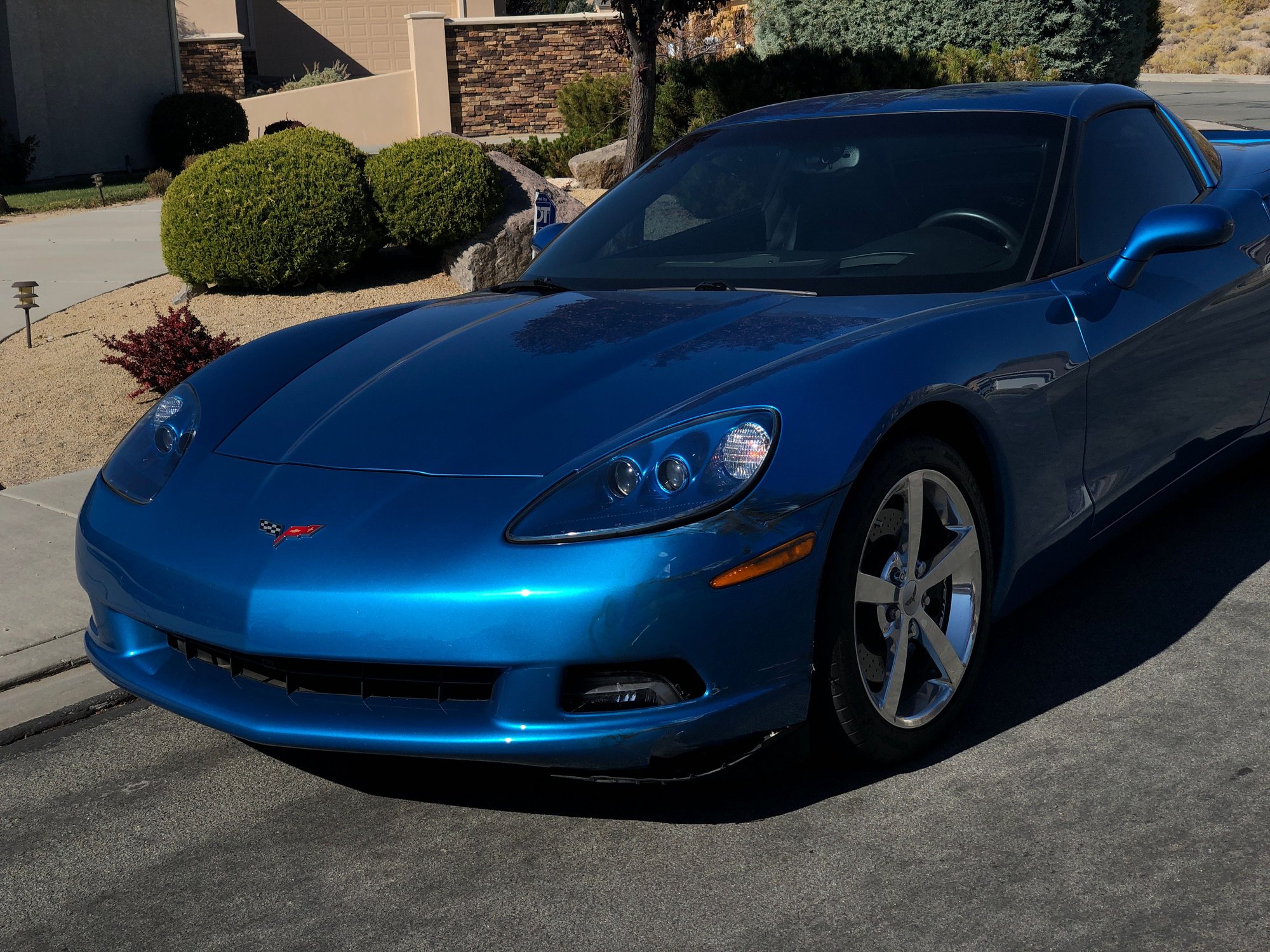

Not the way anyone wants to start November. A lady pulled out from the right at the stop sign, as I'm going straight down our street.
I hit the brakes and stopped. Thinking she will stop and let me continue ahead or go around me, but she never stops.
She continues to turn left in front of me and cuts it sharp towards me. I'm honking the horn now, as I can tell she'll hit me if she continues.

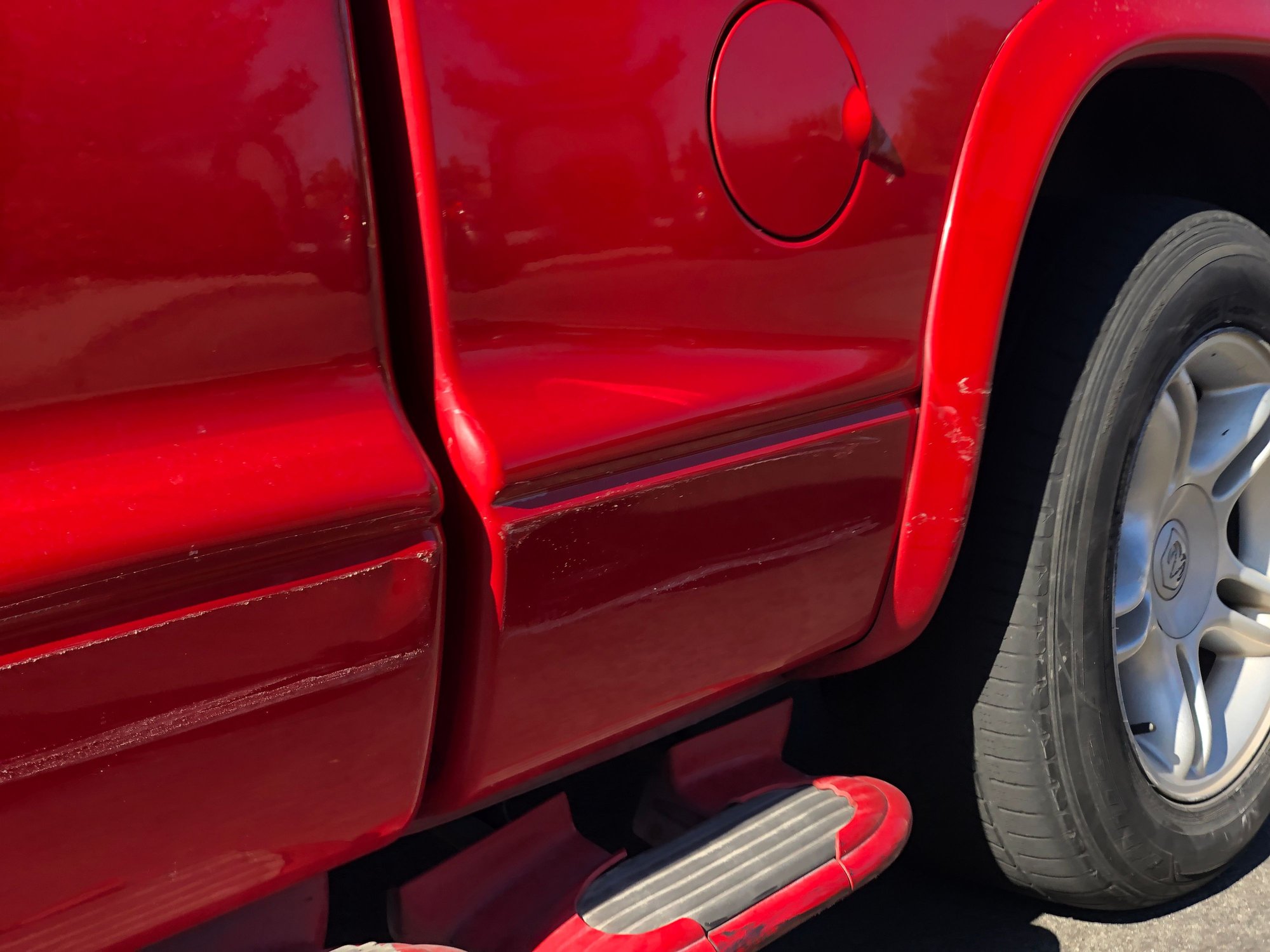

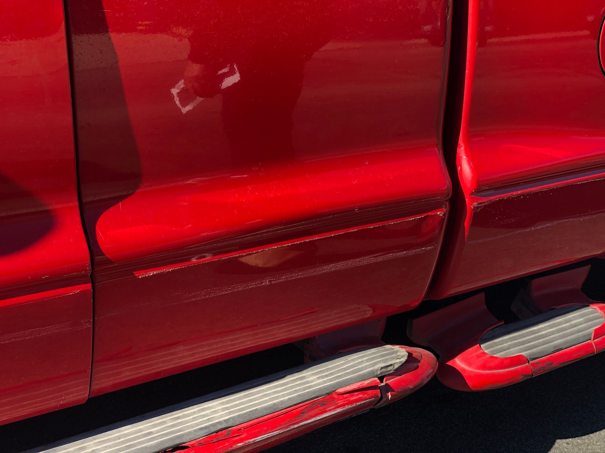

She passes right by my front end and clips my ride with her left side of her truck with the running boards on the truck.
Had I not stopped, she would have plowed into the right side door area, where Anne was sitting. SMH
Anne says the lady never looked at us, but saw her still looking back towards the corner. Apparently at the dog the lady later mentions.
She says she was looking at a man walking his dog and didn't see me until AFTER we crashed. It all happened very fast, no time for me to back up and there was a car behind me anyway.
A witness/neighbor saw it all and couldn't believe it. He heard my horn and turned to look and saw the crash. He was working in his driveway on the corner right beside us.
This all happend just 6 houses down from ours, as we're heading home. Lady says she's sorry and has insurance proof and lives 2 blocks away.
I had no stop sign and she did, along with pictures and the witness, so I'm good on that part. So no costs to me, except the troubles of getting it fixed.
Now it's the trouble of finding a place to get it properly fixed and paint matched around here in the Reno/Sparks area.
Do they still make these parts? Front piece and fender for a 2008? Is the dealership the best place for these parts?
What's the normal repairs on these parts? Repair or replace? Anyone?
Is there a formula for the depreciated value, because of the wreck, that we should get as re-imbursment?
What should I be asking for or expect on this? We both are with State Farm insurance.Thanks, for any information.
Feeling like crap about this, just glad no one was hurt and it wasn't worse.

Based on your photos, you can probably effect a 90% paint repair with polishing compound alone. A surprising amount of that scuffing will polish out, but I don't think it all will.
I have never been happy with attempts to repair polyurethane bumper covers. If it's creased or cracked, the best fix is replacement.
If the bumper cover is replaced and the fender can be reused, standard operating procedure would be to sand the clear coat from the entirety of both front fenders and the hood, paint the new bumper while color blending into the three adjacent panels, and then shoot clear on all four panels.
If the bumper cover can be reused, you can get away with painting just the bumper and the driver's fender.

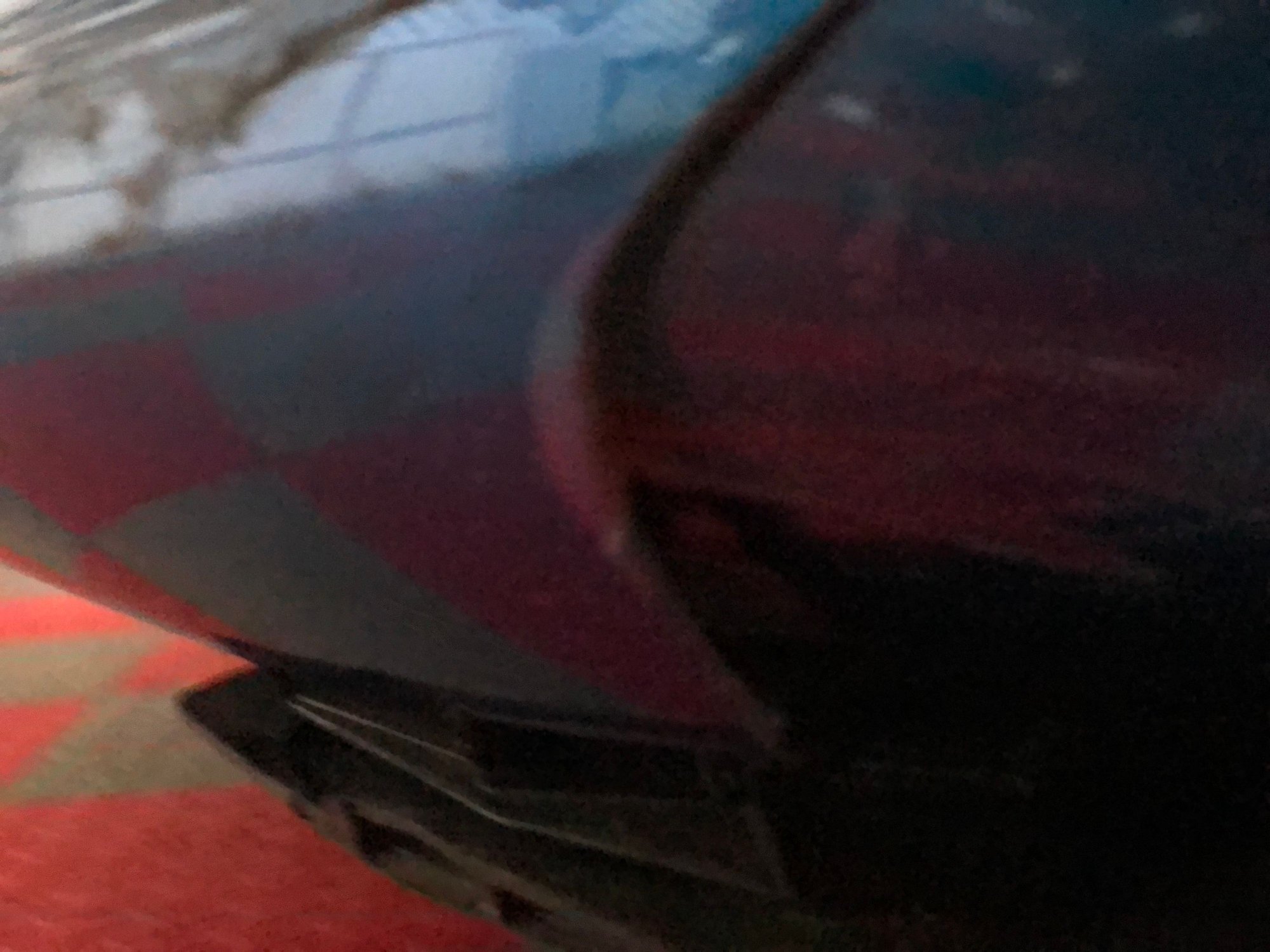

Thanks. On the front piece there's a fracture and a piece broken off down at the bottom and hanging there. The SunTek paint protection is holding it on for now.
The fender and front is scrubbed and in the darkest area is bent inward at the seam point too.

It would be nice to save the fender to avoid color matching the driver's door.

I just took this shot of the broken lower part on the front I mentioned. Sorry about the quality of it.

It's not the visual damage that gets you, it's the hidden stuff underneath. Presumably, the other party's insurance will pay for the repair, so I'd take it to a good body shop that repairs Corvettes and get an estimate. They'll know what to look for and what to replace and repair. Any competent shop should be able color match your paint, so I'd be trying to get broken parts replaced with new parts, or minimally, recycled undamaged parts. Just my .02

Looks like she had more damage than you did. A good body shop will have you out on the road looking good as new

Update: Got the quote for $4,295.24 so far. Replacing the front bumper, headlight, fog light assy,lower deflector, side marker assy.
The right fender is alright, just repair deal. Then of course the paint and clear coats. Then replace the SunTek paint protection on the bumper, headlight and fog light.
I talked with the owner, as he has a white Z06 of his own. So a Corvette guy is in charge of it all and I feel a bit better now.
It goes into the shop on the 17th and should be about a week. Hope things go well.
