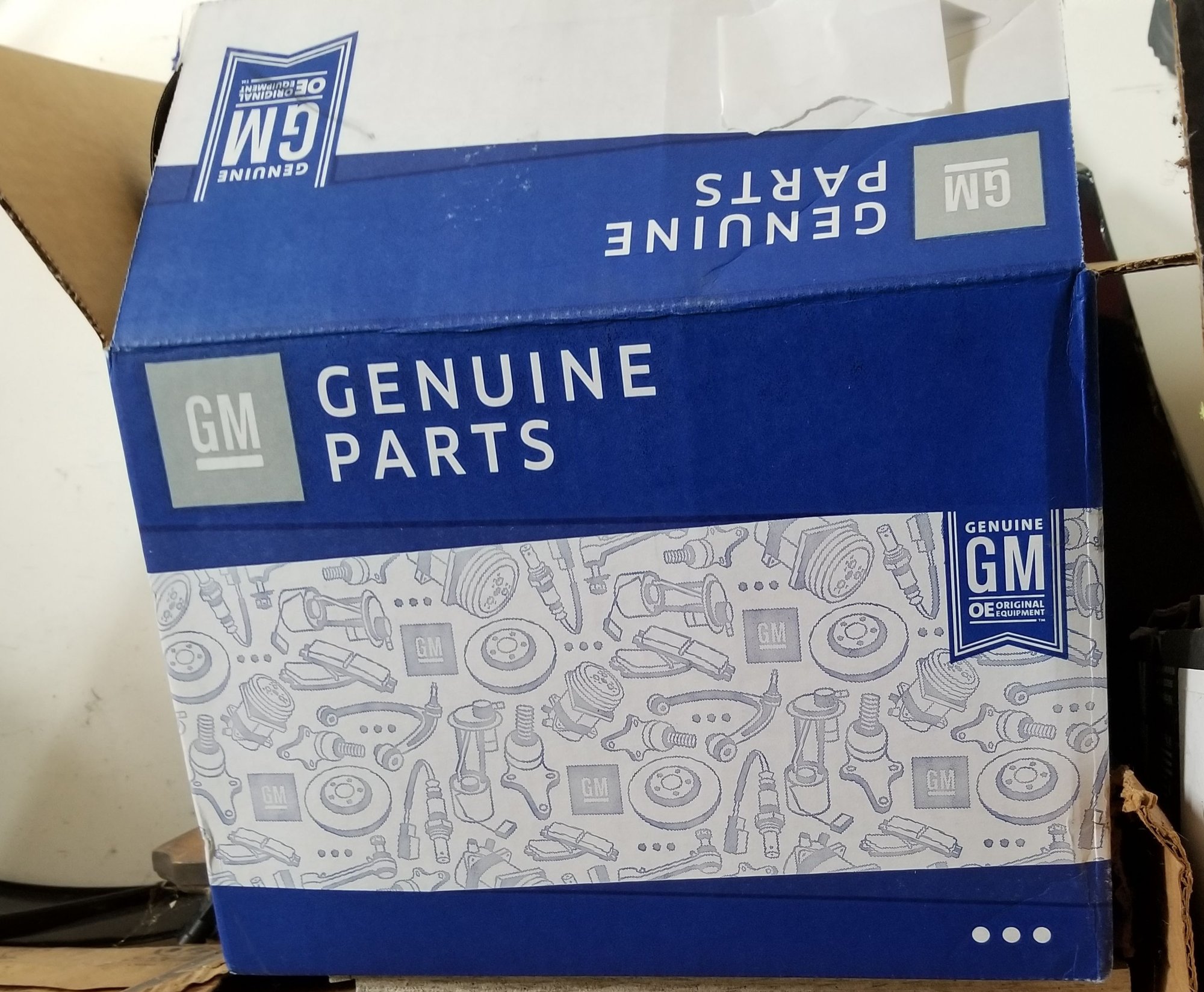

So I ended up buying a gm alternator, amazon prime. Installed in a half hour since I'm a pro at this going thru 3 crap alternators, and bam, 14.4 volts STEADY.. The power master held at 13.9 and has more amperage per the advertising?? I will never buy aftermarket or rebuilt again no matter what amperage is advertised.

Glad you got it sorted out. Did the Power Master come with any warranty? I'd have thought at least 6 months, more likely a year. Are you going back after them for either a refund, or replacement?

Thanks. I sent it back for a refund. I had to go thru a few holes but in the end, I was able to plead my case. I would not take a replacement. I will be keeping an eye on the refund process.
