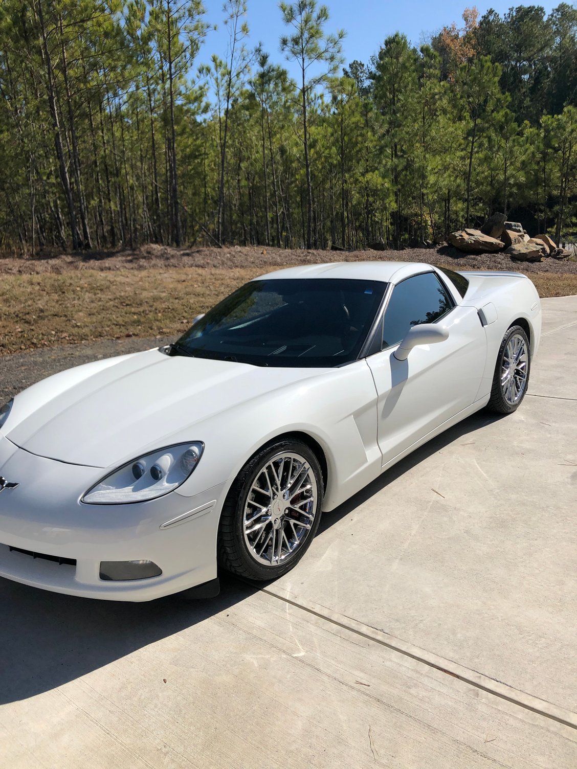

The stock size for my front tires when I input the vehicle information into the Discount Tire website is 245/40 R18 SL for the front and 285/35 R19 SL for the rear. I have the Z51 package so I am assuming that might have made a difference in tire size. I have the stock premium wheels on the car - they show as an option on my window sticker I got from the Corvette Museum. I'm not changing out the wheels. You can see them in the picture I have attached.

Those wheels are after-market zr1 replicas.

As pointed out those are replicas, but they're the same size wheels with same tire size specs.

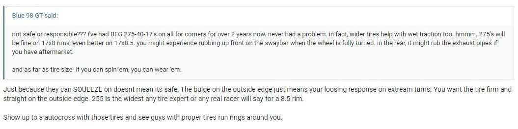

Researched this when changing to aftermarket wheels. Found several opinions, most having to do with aesthetics. Did find a good back / forth in the autocross section of another performance forum for mustangs while using Google. Took a screenshot of most definitive post and kept it for information reference. It was the same question posed for 8 / 8.5 " width wheels...
Because I do so much mountain road driving opted to stay within recommended spec for the aftermarket wheels purchased. Your driving may be different so may not be relevant.

My suggestion would be to go with stock tire sizes. Unless you're going to track the car adding width really doesn't buy you anything. Plus you must maintain the 1.2" difference in diameter between the front and rear tire sizes (rear taller). Usually that active handling issue will not so up until 100+ MPH.
And yes, your car did not come from the factor with those wheels in the picture.

As several of you have noted, you've said the wheel on my car are aftermarket ZR1 replicas and you are correct. A quick Google search showed me that the $1850 wheels that were on it from the factory must have been the five spoke chrome wheels. The car was sold by Corvette World to the second owner, so they may have swapped them out. Who knows.......and I like them.
Thanks for the advice. I'll stick to stock sizes for tires.

Not knocking your wheels at all, Fastdawg. I think they look pretty sharp too.
