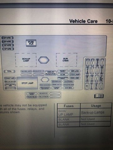

This is a picture in my manual. Unfortunately when i got under the carpet this is not what i found. Did not have the fuses on the far right side of this picture. Total blank space. So no auxillary power fuse.
Old Dec 3, 2020 | 10:55 AM
FatsWaller's Avatar
FatsWaller
Joined: Aug 2017
Posts: 4,929
Likes: 2,339
From: Etobicoke (Toronto) Ontario
There's got to be a cover that you can remove to expose the fuse that you want. I've circled it in red.
You may need to remove the big blue connector first. Not sure.

Here is a video of someone changing the cigarette lighter fuse, but it directly applies to your case. The AUX PWR fuse is right above the one he changes.
Note that he didn't need to remove the blue connector.

The are not, and you have the cig lighter fuse for the one in the ash tray under the HVAC controler, and the Aux fuse for the one in the center arm pad tray.
