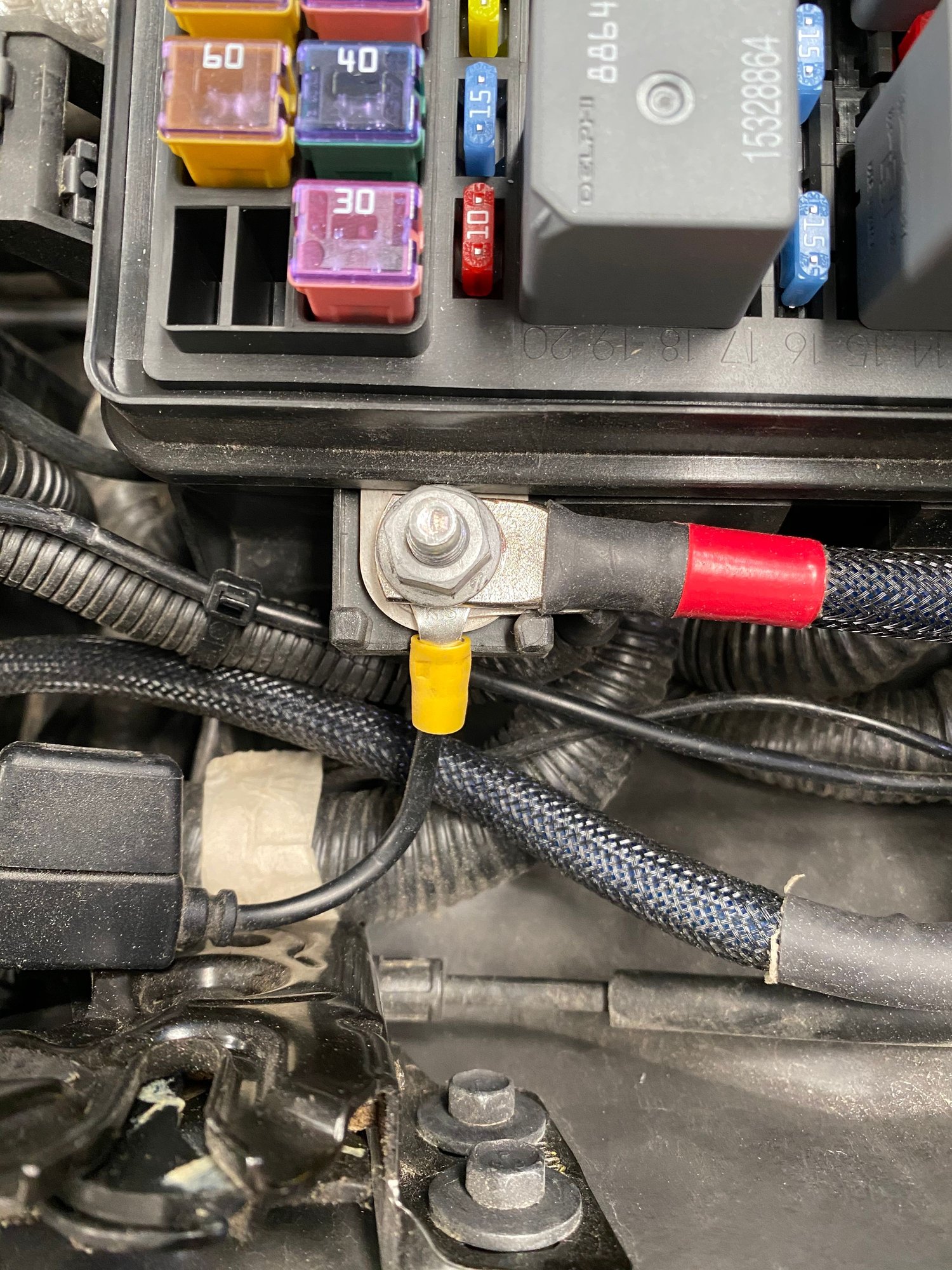

It's the taper of the nut that causes the battery cable to clamp the battery terminal tightly when tightened, so for this reason it's not a good idea to put anything under these. What I did with mine is to connect the positive connection to the terminal that the battery connects to on the fuse box and the negative connection to a chassis ground, as shown here.

Mine is fused, if you follow the wire back from the yellow terminal in the photos, you'll see the fuse holder.
Yah, I didn't see that what with me viewing it on my phone. IMO you've taken the time and trouble to do it correctly. I have seen others having done this with no fuse and the kit that came with my maintainer had 3 adapters including 2 direct-to-battery, none of which had inline fuses except the plug end of the ciggy adapter which had it's own fuse.
