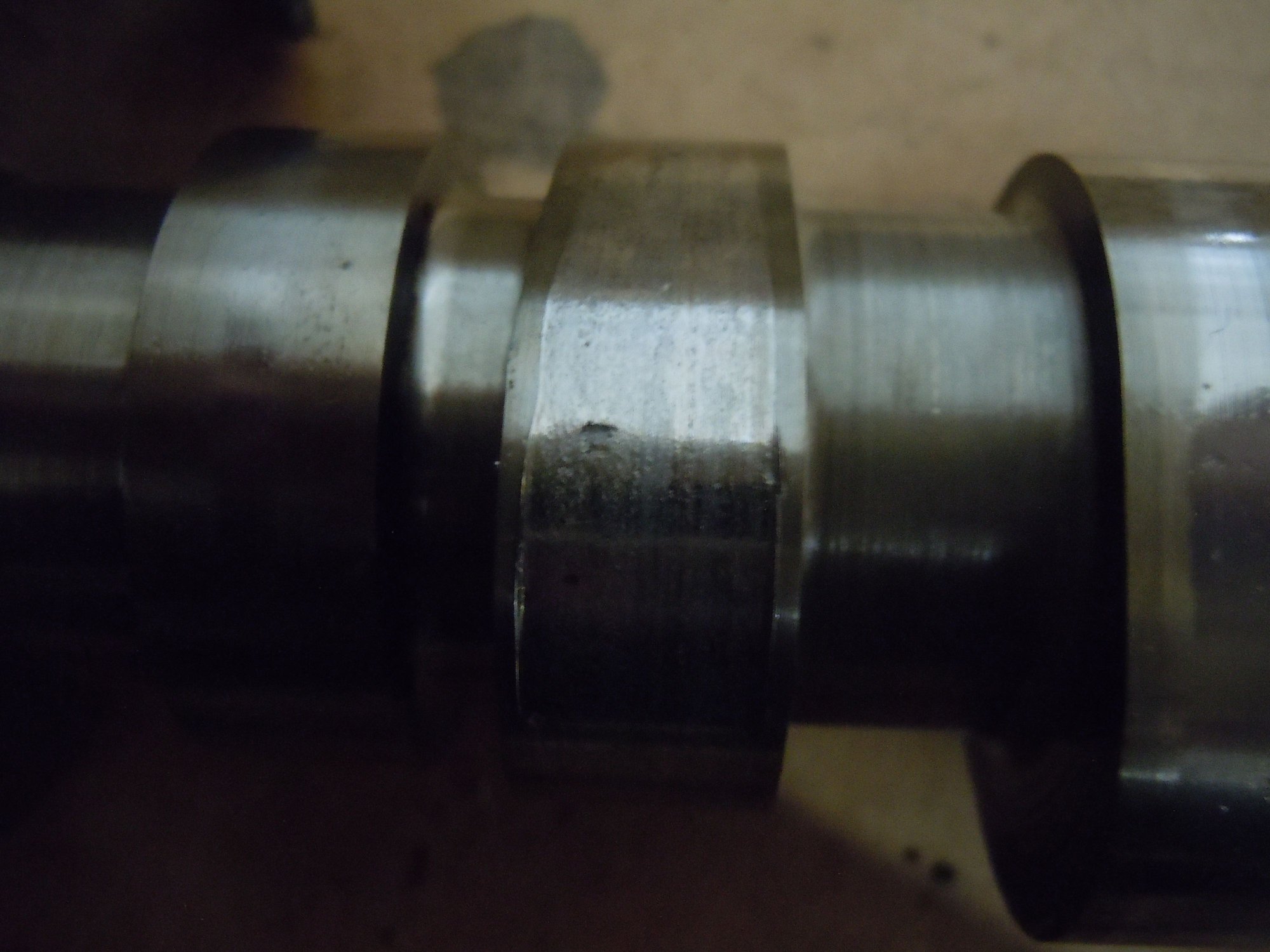

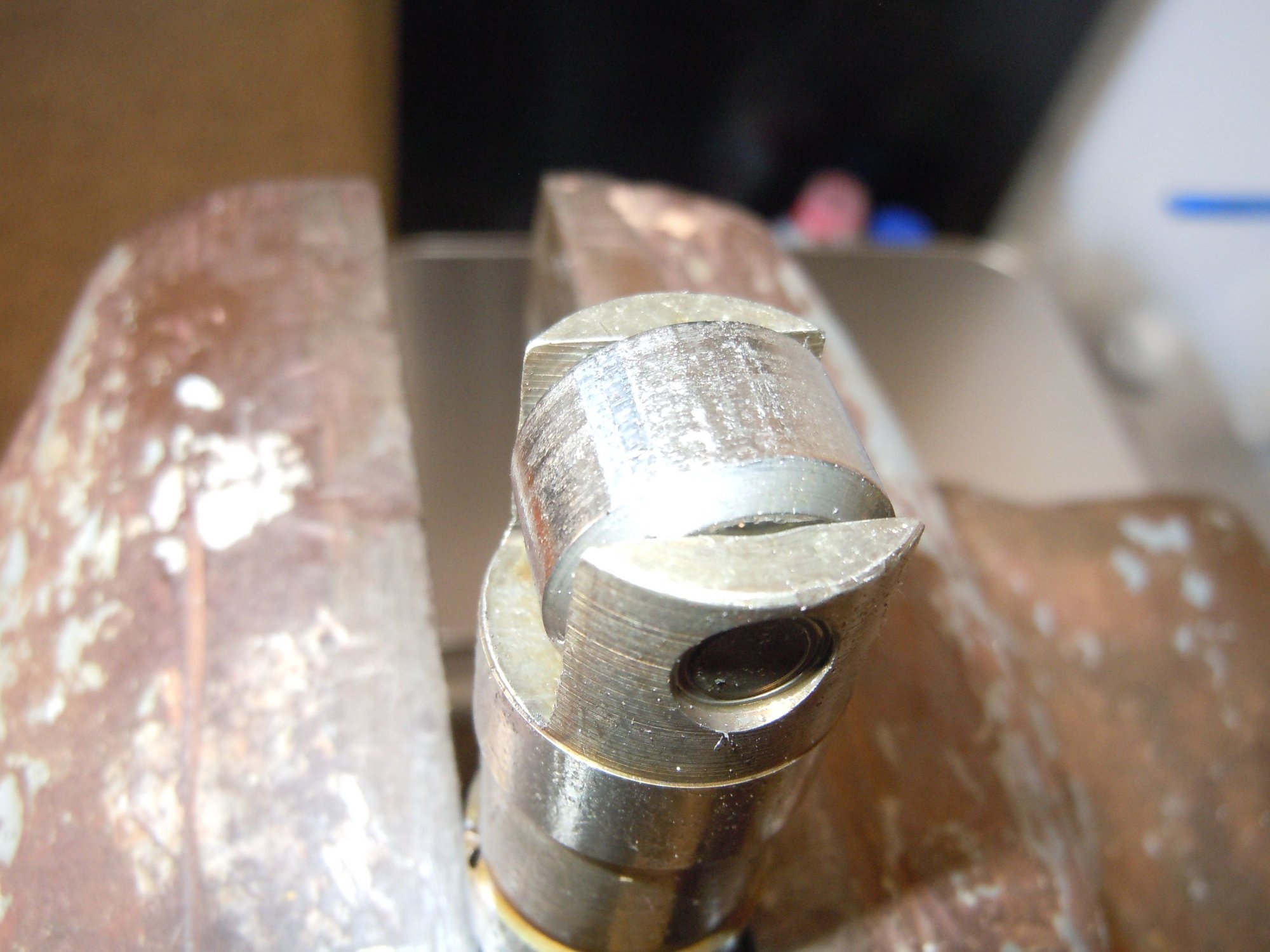

I have a 05 stock Corvette that developed a ticking noise inside the engine. After failed attempts to solve it with oil additives I tour it down and found the #7-cylinder exhaust valve lifter roller’s bearings had failed causing the roller to jam up long enough to cause a small flat spot on it, cause the roller to be sloppy (you can move it side to side and up and down about .1”) and damaged the cam. I am in the process of replacing the cam, putting in new LS7 lifters and new lifter trays. My big concern is what caused this in the first place. It may have just been that the lifter failed due to age, the engine has 118K miles, or it could be a lubrication issue. I have looked in this forum, other web sites and even in 05 factory service manual to learn who the lobes and lifter rollers are lubed but have found nothing. There is one post in this forum that asked this same question but it is never answered. Could someone with knowledge of these LS motors please explain this to me and I am sure others would love to know this too. I will include pictures of the bad lob and lifter roller (the picture shows the small flat spot). Before you ask, my lifter trays are fine and the flat spot on the lifter roller is side to side which would not be the case if the lifter had spun at all. If I was to take the valley cover off would that show a lubrications path to the lobes?

Well the car has 118K miles on it and it ran fine up to this point so not #4. The lifters on both sides of the bad one are fine and the car ran fine, that is you could not see any difference in rocker movement when at idle. So I do not think it is #3 and that leaves #1 or 2. If the lifters and lobes right next to this one are getting splashed lubed enough do not thing this one would have a problem. I think it is #2. The roller bearings that support the lifter roller seem to have gone bad or the shaft that they roll on or the inside of the roller. I can grad the roller and move it side to side and up and down. Not a lot, I measured .1" of movement but the roller is not only sloppy but it is rough as you rotate it. I agree that this seems to be a recurring problem dealt with on the Forum and in other places on the web. I am hoping the new LS7 lifters addressed this problem and will be much better. My thanks to all how have been so kind as to reply to my post and give me information and advice.
