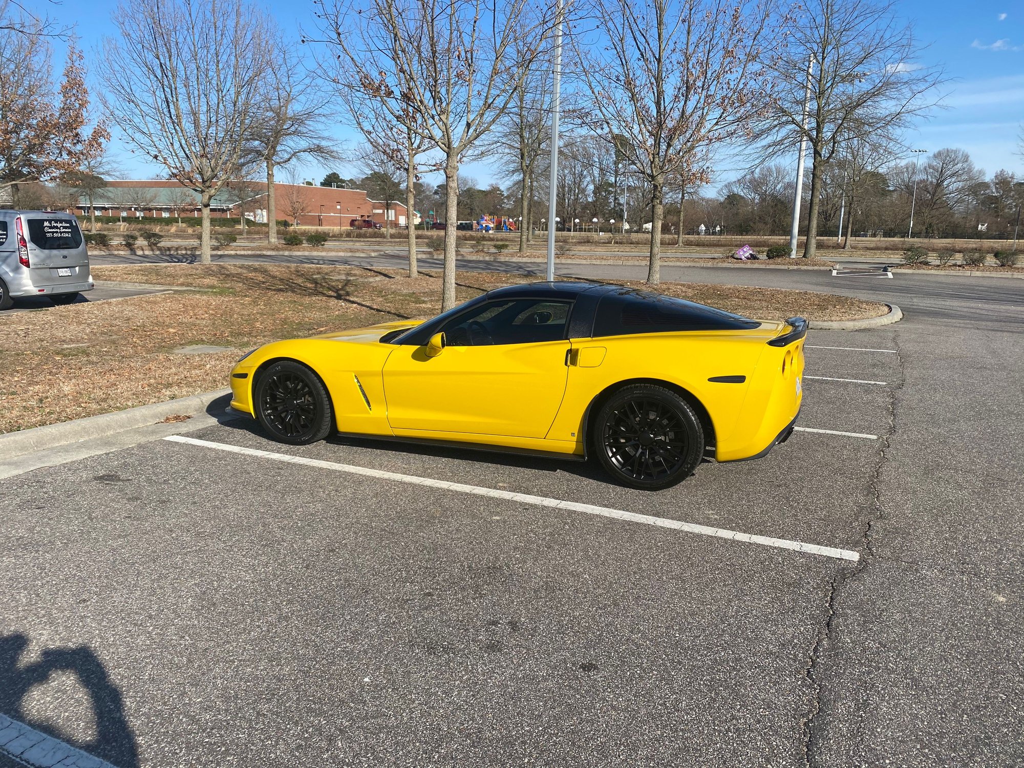

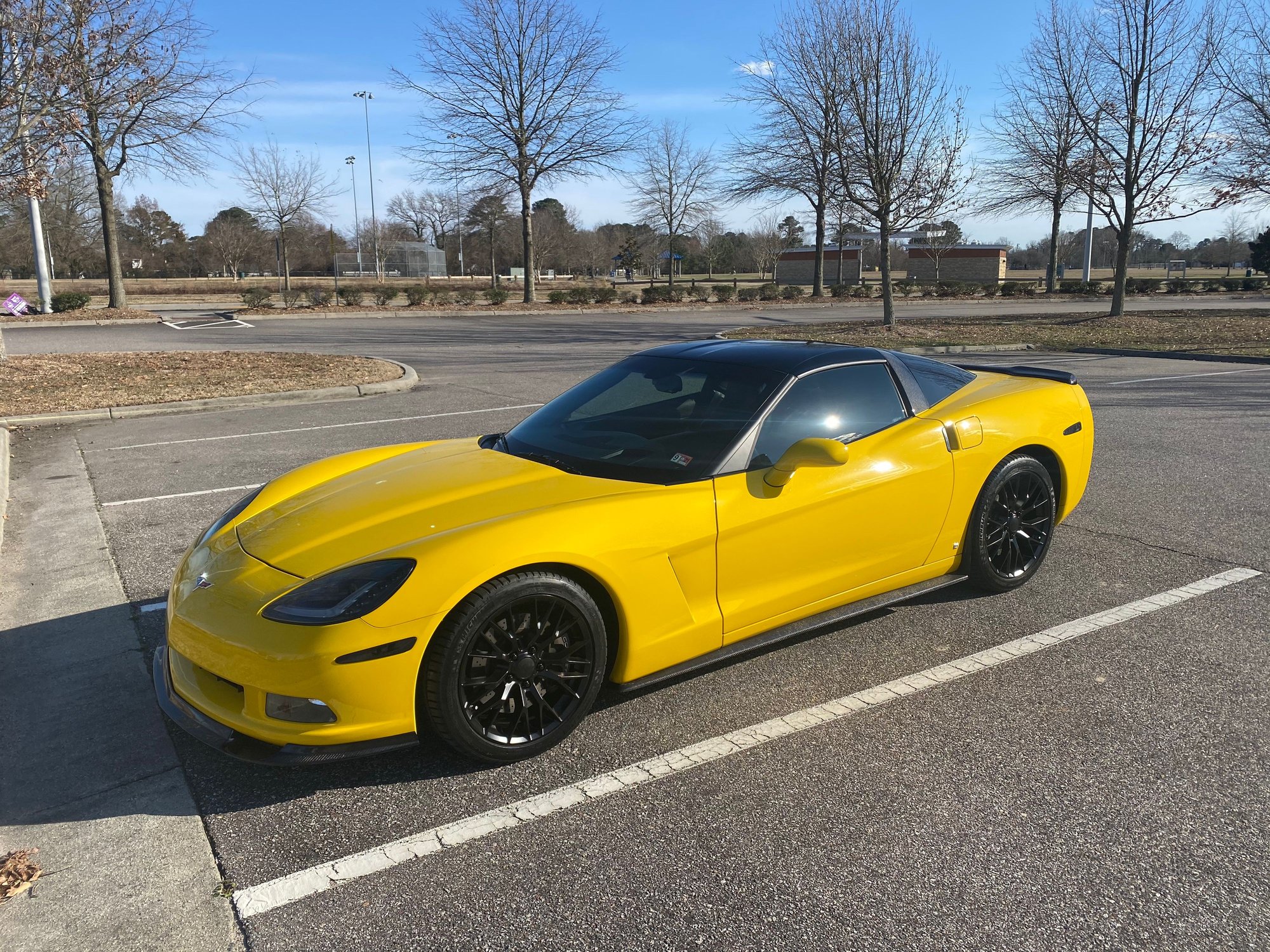

Welp, finally put the new tires on to match the rears. And had the tire shop put the tires on new wheels that I got from Florida speed shop. Had to take the tires and wheels to them as the car wasn't registered at the time. Is now. So no alinement done yet. Anyways, the tramlining is totally gone though. But, got a moderate front end vibe/wobble when I reach 60. Feel it in the gas pedal and shifter and slightly in the steering wheel. Then get a bad steering wheel shake at 80. It was smooth as silk with the crap goodyears and OEM chrome wheels. Gonna take the car into them this week to have them look at it. Feels like tire out of balance to me. Don't think it's the rotors. I put the wheel setups on the car myself and torqued to specs. Could it be a bad alignment that causes that? Here she is with the new wheel setup.

Yup, my dumbass left them on. Each rotor had two of them. Took them off, reinstalled the wheels and went on a spirited nut run. Great up to 65, but still a little something going on at 80 plus. Still gonna get the alignment done and have that shop check the balance on the front tires. Didn't see any balance weights on them. Guess thats ok? Thanks for the tips guys!
