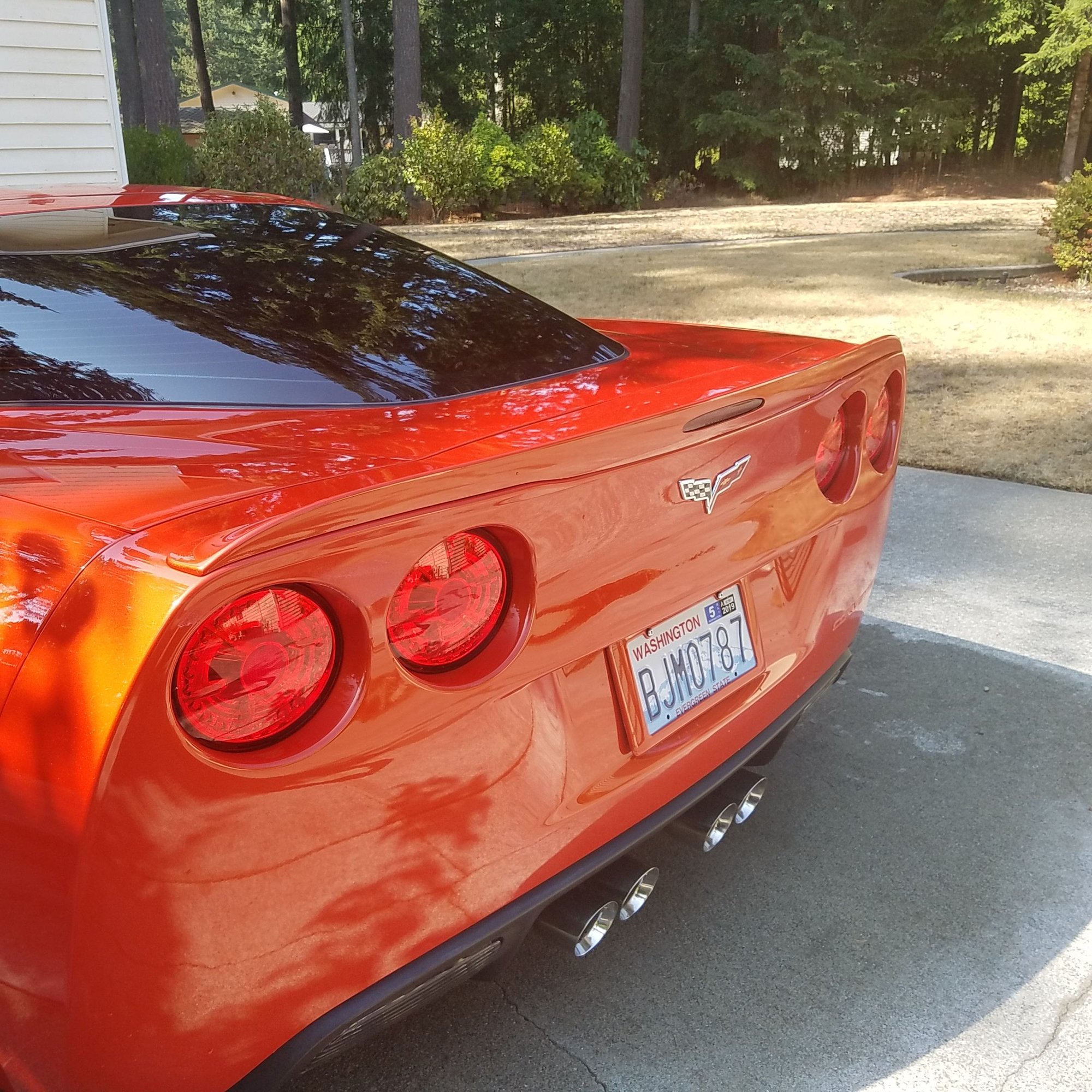

I replaced my 12 Grand Sport small Black "spolier" with the
GM Racing Spoiler (aka Ron Fellows).
As I didnt have the template for drilling the far right/left holes
we used a double thickness of 3m Double Faced Body Shop
Tape to secure the below...........
