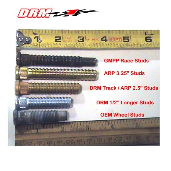

With adapters that thick, you will probably need to get longer studs as well.
This a a chart from Doug Rippie Motorsports. A great source for spacers/adapters and studs/etc.

I should also add that in IMO you should get specific/custom adapters, not a generic version with extra holes for different lug-bolt patterns.
And, a great source for that is motorsport-tech.com.
Both of these companies have great customer service and are highly recommended.
