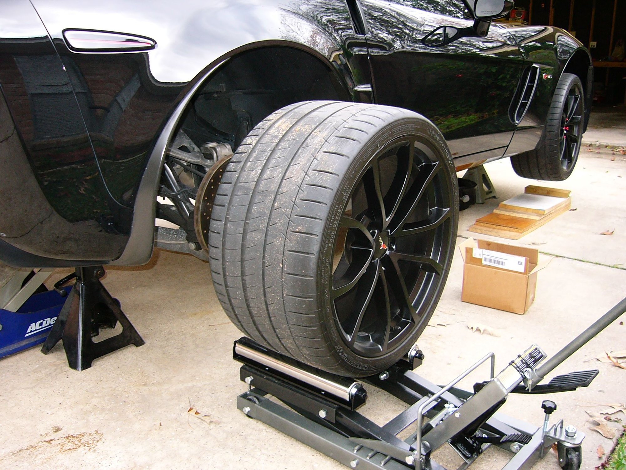

Here's another fancy schmancy rig for changing wheels
Made this up out of a motorcycle lift and some conveyor rollers.
Absolutely unnecessary for swapping wheels, but it sure makes the job easier and no scraping the barrels on the calipers drama.
