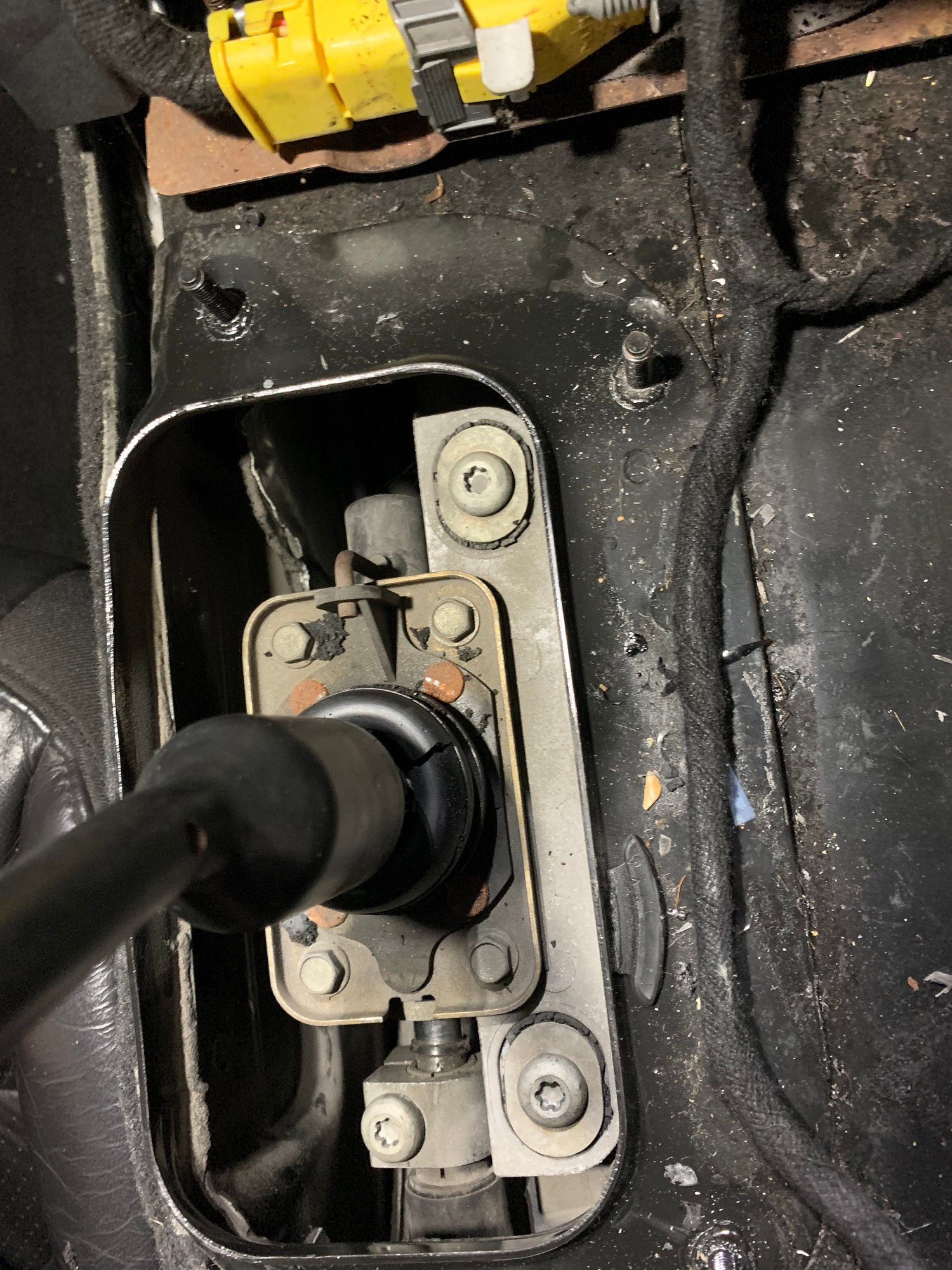

Hi guys,
I picked up a 2005 C6 a month or two ago. I love it every bit, except for the sloppy shifter! Two days ago, out of no where, first and second started grinding. I would have to completely stop to get it into first, and second was almost unusable. I thought it was an alignment issue with the shifter as synchro's don't generally go bad overnight. Then, the car became completely stuck in 2nd gear. I tried rolling it and dragging the clutch to see if it would budge, but no dice. It was towed home and placed in the garage. Still going off the alignment issue, I tore the inside down to the shifter, and now it has become unstuck, I can row through the gears with minimal issues, but it still seems wrong. I took some photos, it looks like all the bushings are completely done for.
Now, the grinding issue is what is scaring me. I had my dad check out the car, and he believes that if I solve the sloppy play, caused by either the alignment or the bushings being completely toast, the grinding will go away.
Would you guys agree with this assessment? I had plans to upgrade to the MGW shifter, which happens to come with those bushings, and if I could kill two birds with one stone I would be really happy.
On the flipside, if I throw $400 at a shifter, and it doesn't solve my grinding issue, or I get stuck in another gear again, I would be upset as that is $400 that should have went to a rebuilt transmission.
Your thoughts are appreciated!

yeah if you take the four bolts off, you'll likely see a bunch of black plastic laying around... mgw will fix this, as well as a new oem busing...
mgw will be significantly shorter throw, but one that i personally appreciate... didn't take long for my girl to pick up the feel either, and she had driven with oem shifter previously...
that box looks raggedy

Well, I disassembled it all, cleaned it all, and even made a makeshift bushing with a nylon roller.
Fixed a lot of the slop, but it still grinds in 1st and 2nd. Guess I'm looking at a rebuilt transmission
Anyone have any other things or ideas that I could check before dropping a pretty penny on a rebuilt transmission?

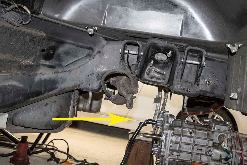

Two suggestions if I may.
I would pull the old shifter and try to move the rod linkage by hand. (make sure the shifter is not bound up.)
Also if you pull the trans to get it rebuilt. I'd also put in a new clutch and hydraulics with a remote bleeder. Just getting the trans out is a lot of labor cost.
Here's the linkage I'm talking about at the transmission end. The other end is the at the pinch bolt in your shifter picture.

Almost there. I have the rear cradle and differential out. Quite easy for someone who has never done anything like this before. Really happy with the ease of maintenance with this car, that for sure.
I'll be getting to the transmission today, and will check that out. I think I'll be sending it out regardless, as it is 16 years old at this point and I'm sure there's a lot of damaged or nearing death components in it.
