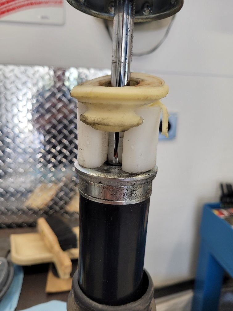

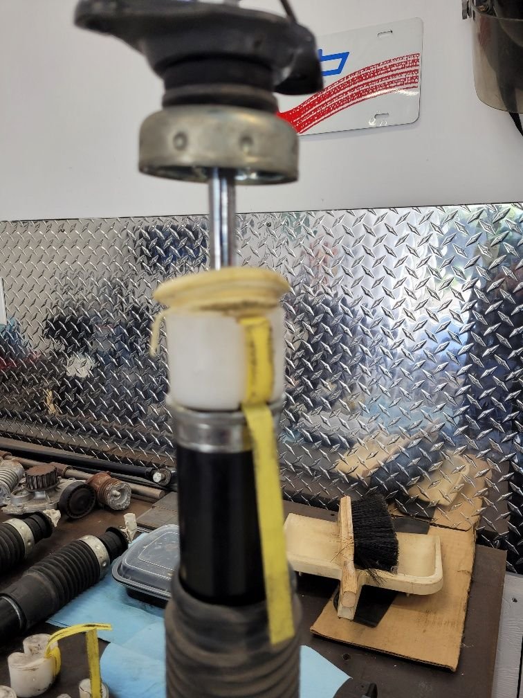

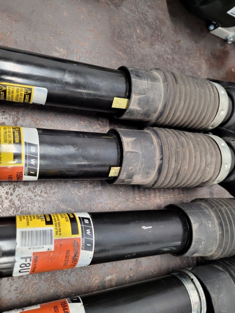

I know this is an old post but this might help someone. 2011 ZR1 customer was complaining that the JIm Mero Mag ride module I installed didn't do anything?? I checked the shocks and found pictures attached.
Yellow indicators for shipping blocks are visible.
This is unreal that this could of went on for so long - how many miles on his Vette (ZR1)?
Now not only does he have the full benefits of the Jim Mero suspension tuning and selective ride, but his shocks are essentially new!
Good catch and good to bring up this thread again!
Thanks,Matt
I believe it had 15,000 miles on it. Rode like a truck.

These shipping blocks are hollow on one end and flat on the other. In the past I've pulled these out without any damage to the jounce bumper at the top because the blocks were installed with the flat surface facing up. The bumpers were a little flattened but undamaged. All four of these blocks had the hollow end facing up and the jounce bumpers were forced into the hollow areas damaging the bumpers. These shocks are hard to find so It's not likely I'll find the bumpers or boots. If anyone has any leaking unuseable BWI mag ride shocks I would be interested in buying the jounce bumpers from them.
Jim
