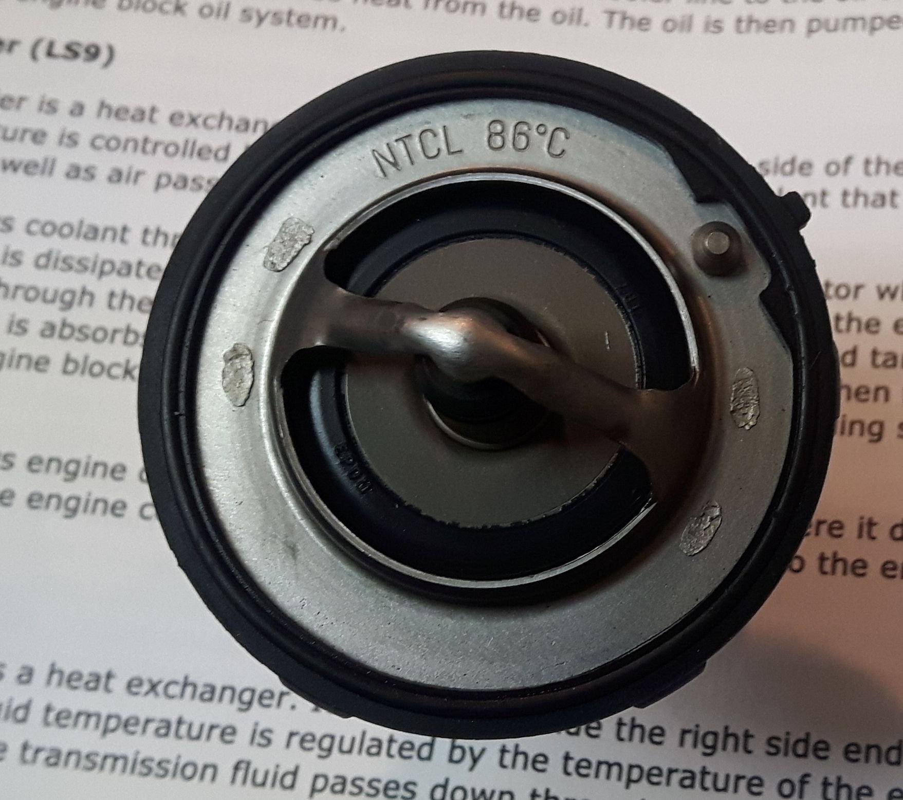

Pretty sure. It's marked 86C, so just under 187F. A pic is worth a 1000 words.
I thought the t-stat would be fully open around 7F above the rated temperature? Seems like that's the way it was operating before.
