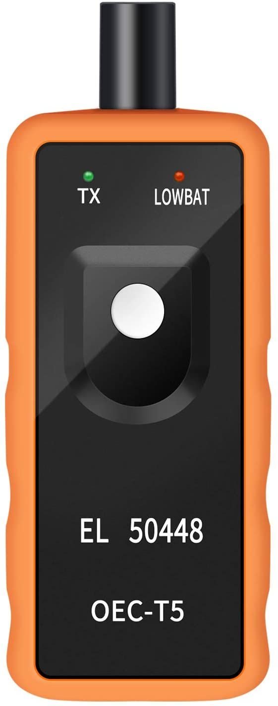

Just wondering out loud: if the wheels on a vette were removed, and repositioned in other positions, would the TPM system know they were not in their correct positions? Or is the system sophisticated enough to know they had been repositioned, and give PSI readings accordingly?

When you program it, the sequence it is looking for is front left, front right, rear right, and rear left. You can do it out of order or swap tires around and still have a reading, just wrong spot.

You will need a relearn tool to reset their positions. Any tire shop can do it, or you can buy one at Amazon for less than $20.00
