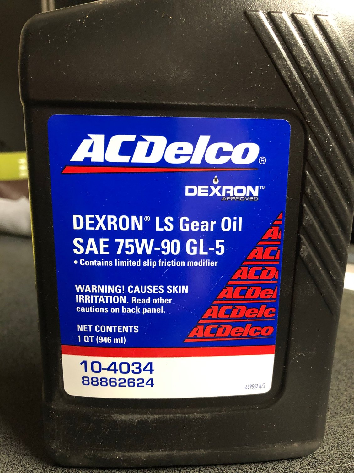

If not then buy the correct ACDelco oil (check here on the forum for part number) drain out the old oil and add ACDelco. If you are not going to do it yourself then watch and make sure they use ACDelco you purchased. Then again start again with the slow speed figure 8's

I would like to think the dealer used the right diff oil. I would prob go to a specialty shop and have it changed. I believe the proper fluid is p/n 88862624 perhaps superseded by p/n 88900330. If that does not solve the problem it isn't the problem.

With this gear oil it is not necessary to do the figure 8’s. Of course if you want to, have at it.

This is the correct gear oil, which incorporates the proper friction additive, but no disrespect, your comment is not correct. If the old gear oil is fully drained (i.e. let it sit & drain for a couple of hours) the old oil will drain out of the clutch packs as well as the housing. When refilled, the figure 8 exercise is needed to drive the fresh oil back into the clutch packs.
