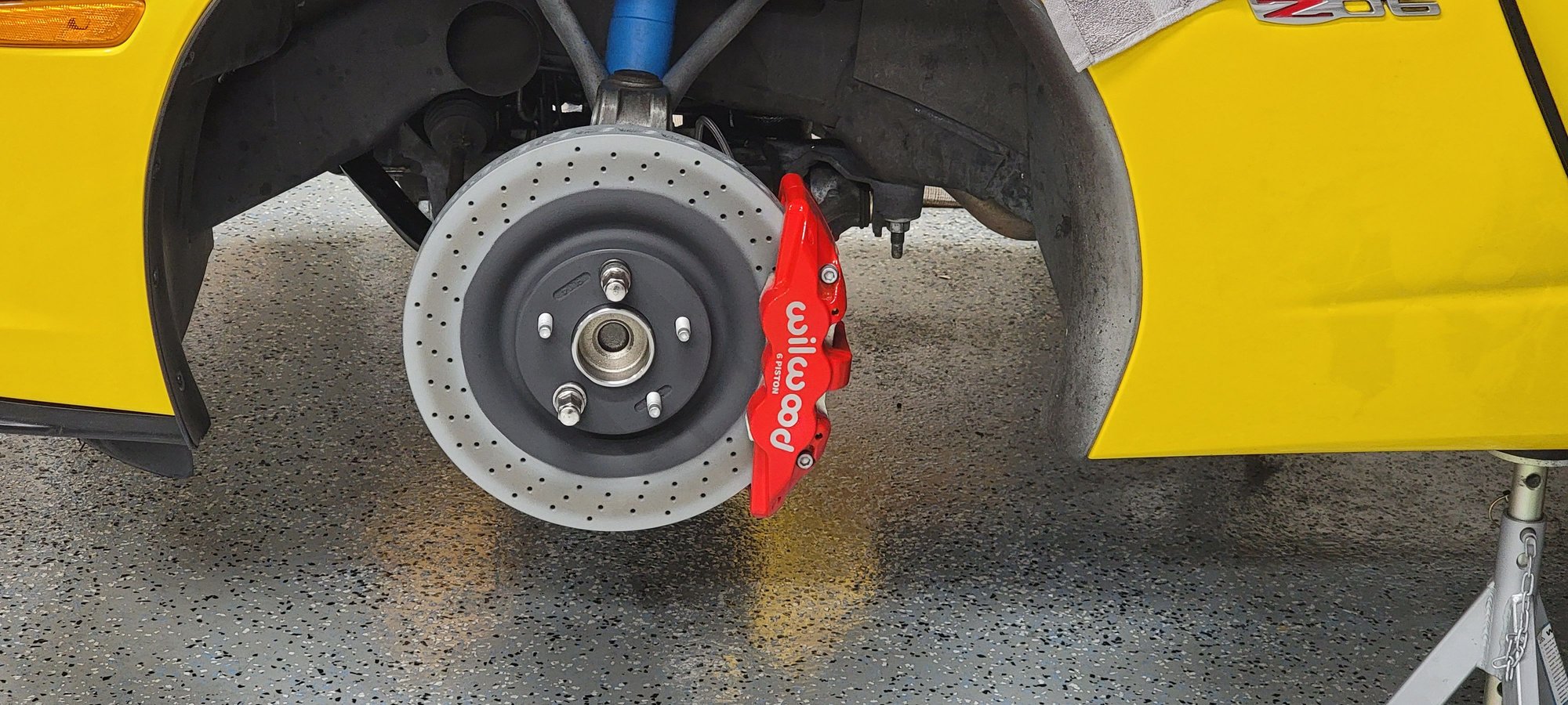

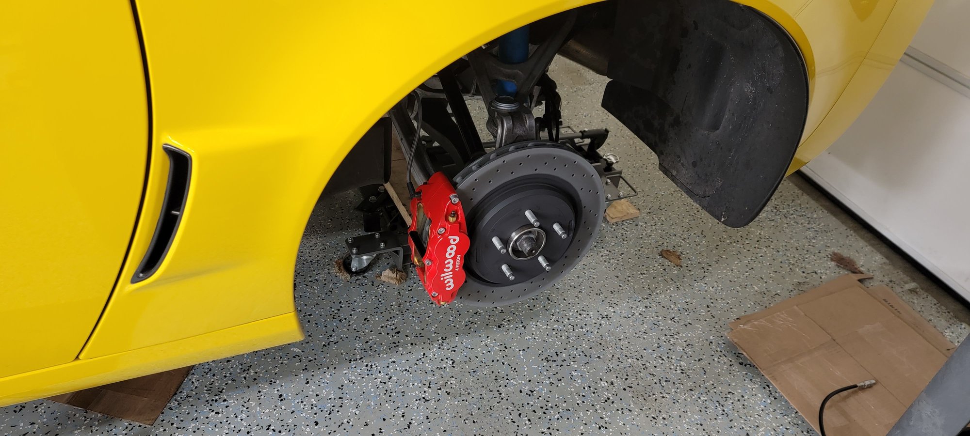

I don't know if anyone cares but i thought i would post this to help anyone else out in the future. The Autel Maxicheck Pro will do a full automated (guided) brake bleed on C6 Corvette. It is the cheapest solution I have seen!
I had my calipers off my Z06 for a few months and also replaced the master cylinder. All lines were pretty much empty. When I installed my Wilwoods I manually bled the brake system in the order from the shop manual (which is weird). Then did the Auto bleed twice (i think once would have been enough). Some foamy brake fluid did come through some of the calipers when I did the Auto bleed. I have a pefectly firm pedal with no issues at all.
pic of the Wilwoods cause they are so pretty!
