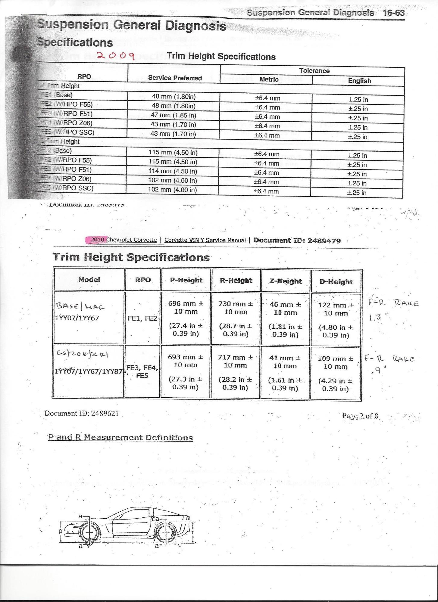

Not sure what vehicle you have but the spec on a C6 GS is as follows. Measurements are from center of fender opening to the ground:
front 27.3" +/- 3/8"
rear 28.2" +/- 3/8"
For reference, my GS is 10 years old with 12K on it. The rear is right at 28.25" and the front is slightly low at 26.75. I'll attach a pic for reference from my phone. Hope this helps.

Depends on what you want. IMO, these cars are already very low so I would likely raise the front up ~.75". This would still put the front 1/2" lower than stock. You can use my pic several posts above as a reverence.
