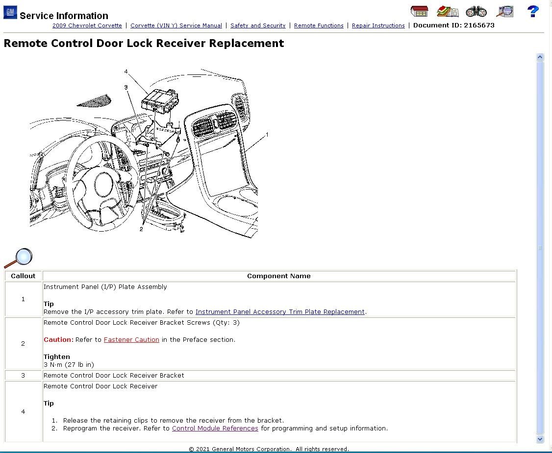

BTW, there is no "theft deterrent module" either. He's maybe (probably?) talking about the aforementioned RCDLR module. Theft deterrence is part of what it does, so you could call it that I guess.
Here is the R&R procedure from the shop manual. Very simple - once you have the console trim out which is a bit involved. Then there is the programming/setup procedure which does require some specialized equipment.
