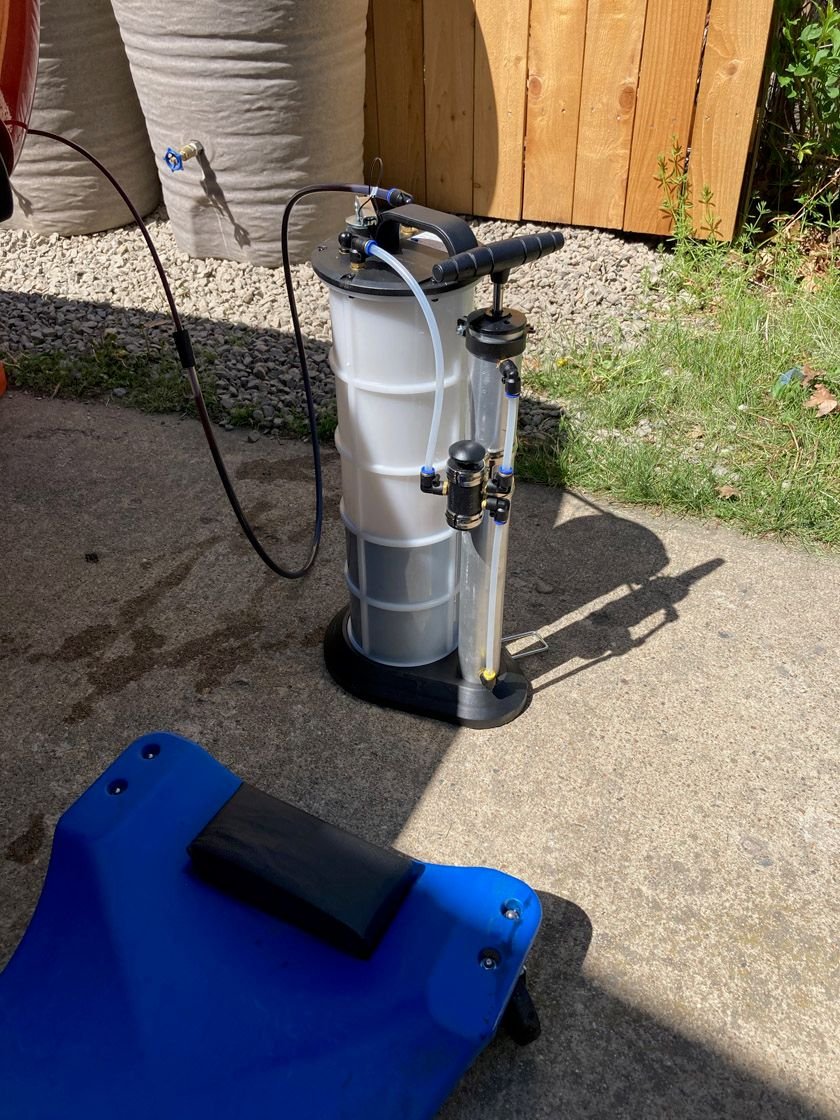

Old Jul 2, 2021 | 10:13 AM
vezePilot's Avatar
vezePilot
Joined: Jun 2018
Posts: 377
Likes: 105
From: Boulder, CO
Originally Posted by ghayesjr824
Hey guys, I have a base 2006 A6, just crossed 50k miles, should I have the tranny fluid changed now like the manual says or let it go alittle bit more? thanks
Where will you take it for the work to be done? Is there a Corvette specialty shop near you? Do other auto repair shops know how to do it?
I found that this work is MUCH EASIER than I thought it would be. I do have a set of QuickJacks, however, which make any work a lot easier.
I have even checked the level with the engine running while I was under the car. No big deal. Regarding the circumstances that C6ToGo mentions, I have done all of that, I have 77,000 miles now, and I'm the third owner.
It was a no-brainer to decide that it must be done. I have not dropped the Pan nor changed the Filter, but I have flushed what is possible twice now, and will do it a third time soon.
And this Mity-Vac device takes care of the rest:
