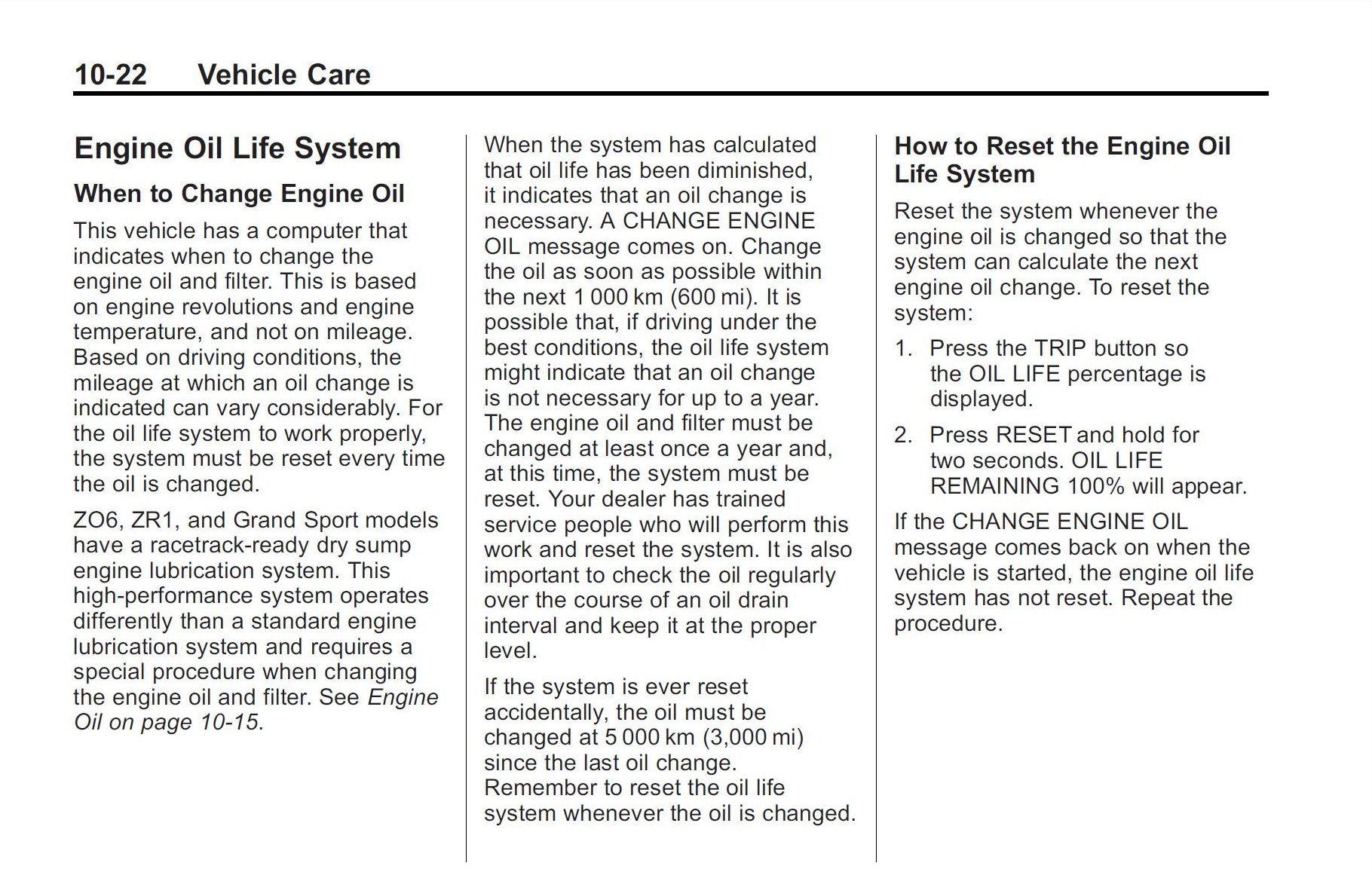

The "Service Engine Soon" type messages are common on many GM vehicles that use actual starting and driving info (e.g. number of cold starts, length of journeys, ambient temperature) to estimate the oil condition, rather than changing it at fixed mileage intervals.
The instructions below explain how to reset the oil monitor on a 2011 Corvette. You could try the same process on that vehicle and see if the message goes away.

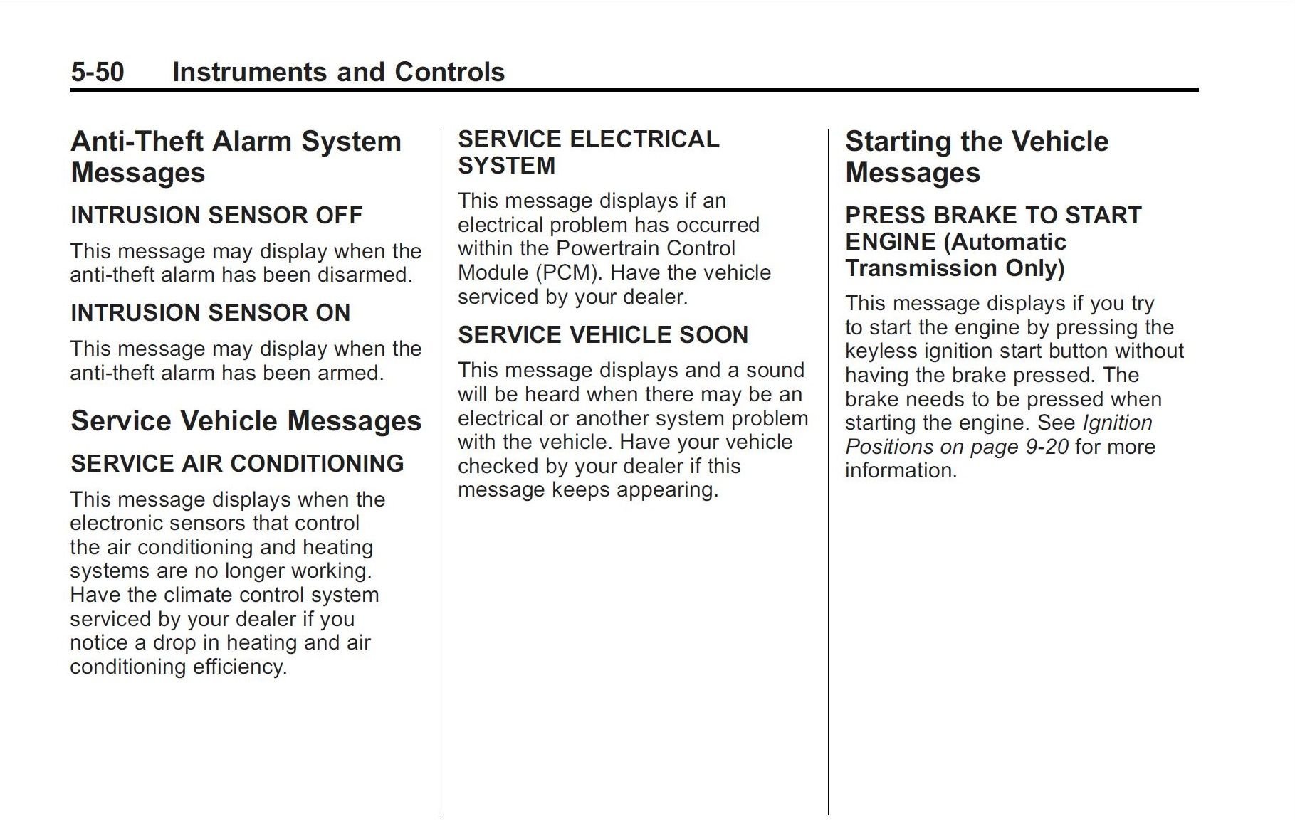

Otherwise, there is another message "Service Vehicle Soon" - see below:

More info on message SERVICE VEHICLE SOON
The driver information center (DIC) displays the SERVICE VEHICLE SOON message in the DIC when the IPC detects certain malfunctions not related to the vehicle emissions system.
