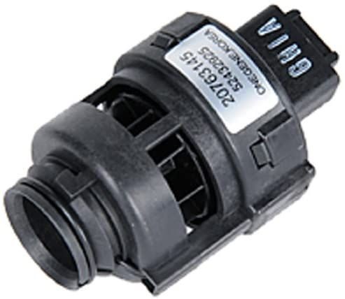

I had a similar issue with my 2007 ... ended up being the interior temp sensor (below the start button). Was full of dust (which I blew out, but it had allowed moisture to corrode the thermistor). Replaced it ($50 on Amazon) and everything works great now. Sophisticated little unit ... has its own fan to blow air across the sensor.

The grill itself is not removable. I removed the knee panel under the dash (two screws and pull careful) and that lets you get to it from below. Once you get hold of the sensor, it is a quarter turn one way or the other to free it from its mount. There is enough wire on it to drop it far enough to look at it and clean it (or replace it). GM part number is 20763145 (at least for my 2007)

How did you narrow down the problem to this sensor? I'm having my HVAC module in my 2007 act crazy, I might have to buy a refurbished main HVAC control panel online. It would be great simply to replace this sensor, if I could narrow down the problem to just that. Thanks ahead of time for any advice.

Just saw your other thread about hvac unit. This sensor is easy to get to. Pry the plastic panel off below where the sensor is( to the left of start switch). Next ON my 2012 there is an aluminum kick plate, held on by 4 screws just below the steering wheel. Take those out and just reach up, turn it half turn or so and it will com out. I also will do this first before I drop $$ for the refurbished HVAC unit.
