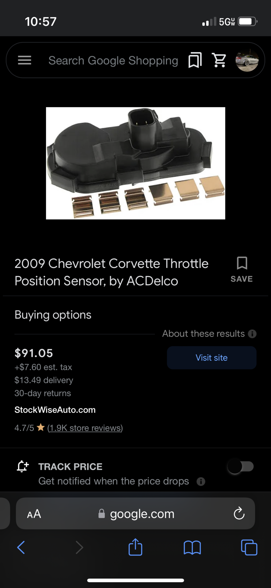

Not sure what sensor your talking about. If your referring to the throttle position sensor that is not an individual part you can purchase, you have to buy the entire throttle body. If you mean MAF, even if his maf is causing problems he will still need a different throttle body because the TRQ throttle body doesnt work, I went through 3 of them and all had the same symptoms, remedied by an OEM replacement.
Old Aug 13, 2022 | 01:58 AM
LaoBron's Avatar
LaoBron
Joined: Jul 2020
Posts: 482
Likes: 85
mine came apart off the throttle body
Old Aug 13, 2022 | 07:20 AM
Matthew Bull's Avatar
Matthew Bull
Joined: Nov 2020
Posts: 56
From: Florida
That's for an ls3 car. The ls2 throttle bodys are different and very hard to come by not to mention EXPENSIVE in comparison to the ls3. Ls2 uses a silver blade that opens opposite of the ls3, this is why it won't work the computer thinks the throttle body is not performing properly and will throw a code. Ls2 throttle body position sensors are internal and while it is possible to disassemble the throttle body get to the motor/sensor, they cannot be purchased separately so you have to buy an entire new throttle body.
