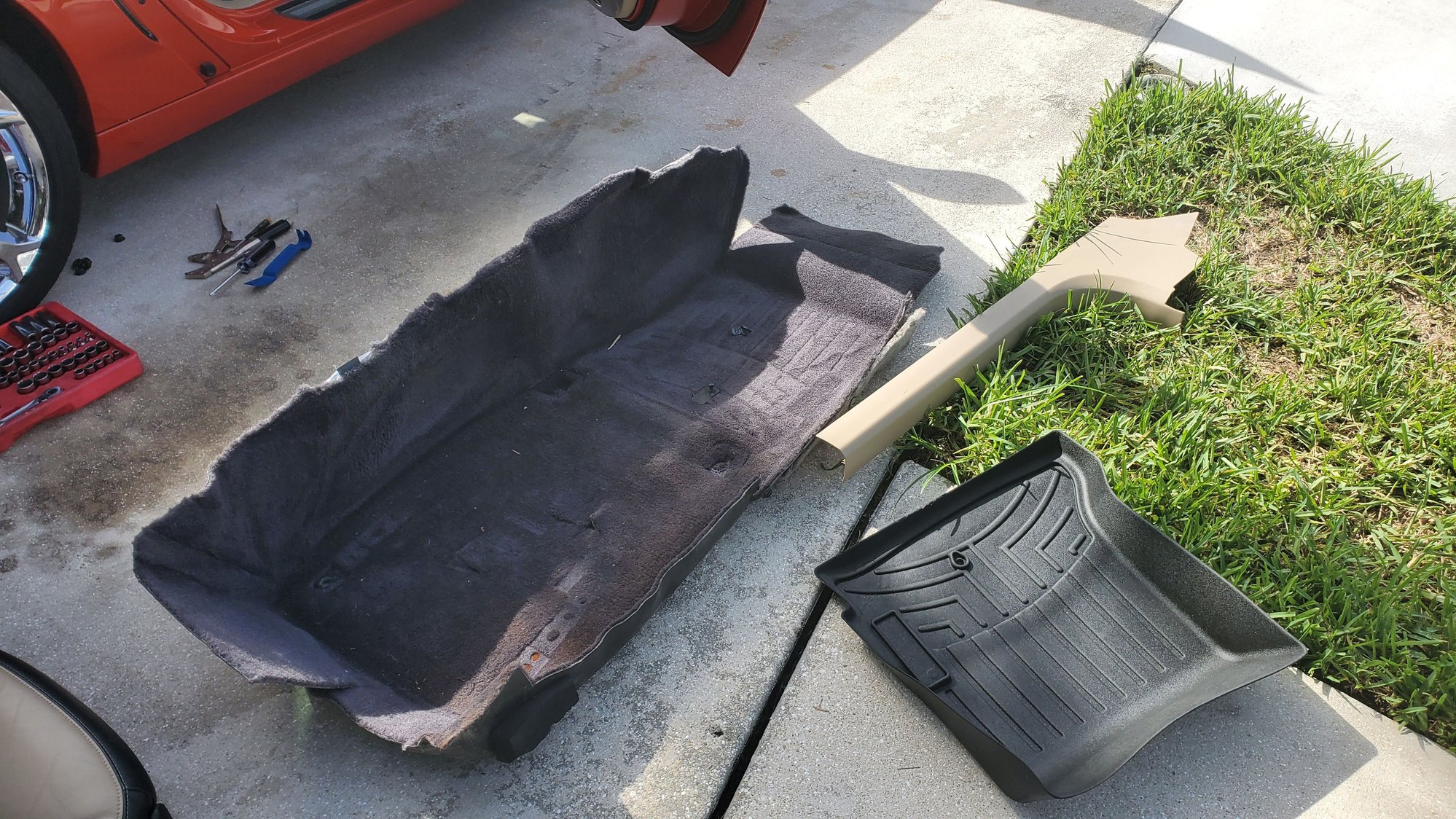

Images of the L/R Carpeting from when I did the sound deadener/heat shield. '11 GS if it helps
Left Carpeting

That does help.
So it looks like the floor carpet runs up into the center console, instead of the console sides being a separate piece. As previously mentioned I would have to make a finished seam on the bottom edge following the contours of the floor. which may be beyond my skill set.
