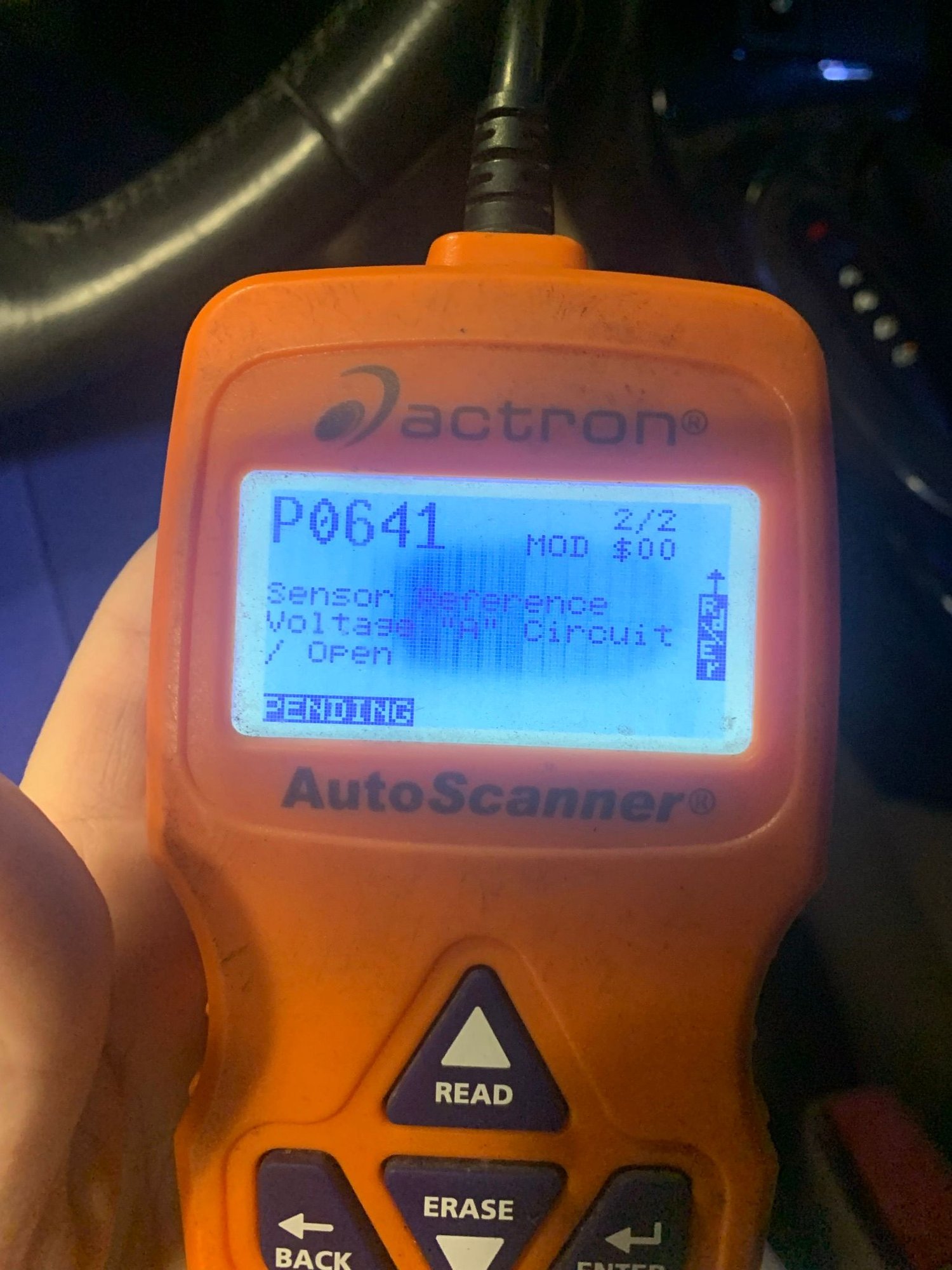

I have a c6 that says reduce engine power and shuts off everytime I try to drive it. The scanner code is P0641

The engine control module (ECM) has 2 internal 5-volt reference busses called 5-volt reference 1 and 5-volt reference 2. Each reference bus provides 5-volt reference circuits for more than one sensor. Therefore, a fault condition on one 5-volt reference circuit will affect the other 5-volt reference circuits connected to that reference bus. The ECM monitors the voltage on the 5-volt reference busses.
P0641:
The 5-volt reference 1 bus provides 5 volts to the following sensors:
• The manifold absolute pressure (MAP) sensor
• The fuel tank pressure (FTP) sensor
• The air conditioning (A/C) refrigerant pressure sensor
• The accelerator pedal position (APP) sensor 2
• The engine oil pressure (EOP) sensor
• The camshaft position (CMP) sensor
P0651:
The 5-volt reference 2 bus provides 5 volts to the following sensors:
• The APP sensor 1
• The throttle position (TP) sensor 1 and 2
• The crankshaft position (CKP) sensor
• The cooling fan speed sensor

I hate generic scanners with a passion since they don't get down to the body level of the car. See if anyone local has a Tech II to pull up the codes, and it should point you right at the sensor that is having the major problem in the first place.
If all items on the 5 volt reference sensors are low, then problem is at the ECM, with maybe a corroded connect at the ecm/wire gounding out somewhere, or something like a cold solder joint at the header pin that would just need to be re-soldered.

Well we changed the ECU and fixed the ABS and it worked fine just still shifted weird but now it’s saying there is no key fob 😞
