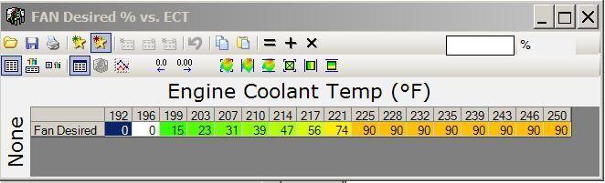

Don't know if it's possible to program the radiator cooling fan to run at 100% duty cycle but GM advises the fan should never be run at greater than 90%. Running the fan at above 90% has been shown to overheat the connector from the fan controller to the fan. I had my tuner guy set mine at 88%. Mine is a '08 Z51, M6, with BTR Stage 2 cam/kit. The engine never gets above 217 deg. F. in heavy traffic, and often will drop to the 180's on the open road.
