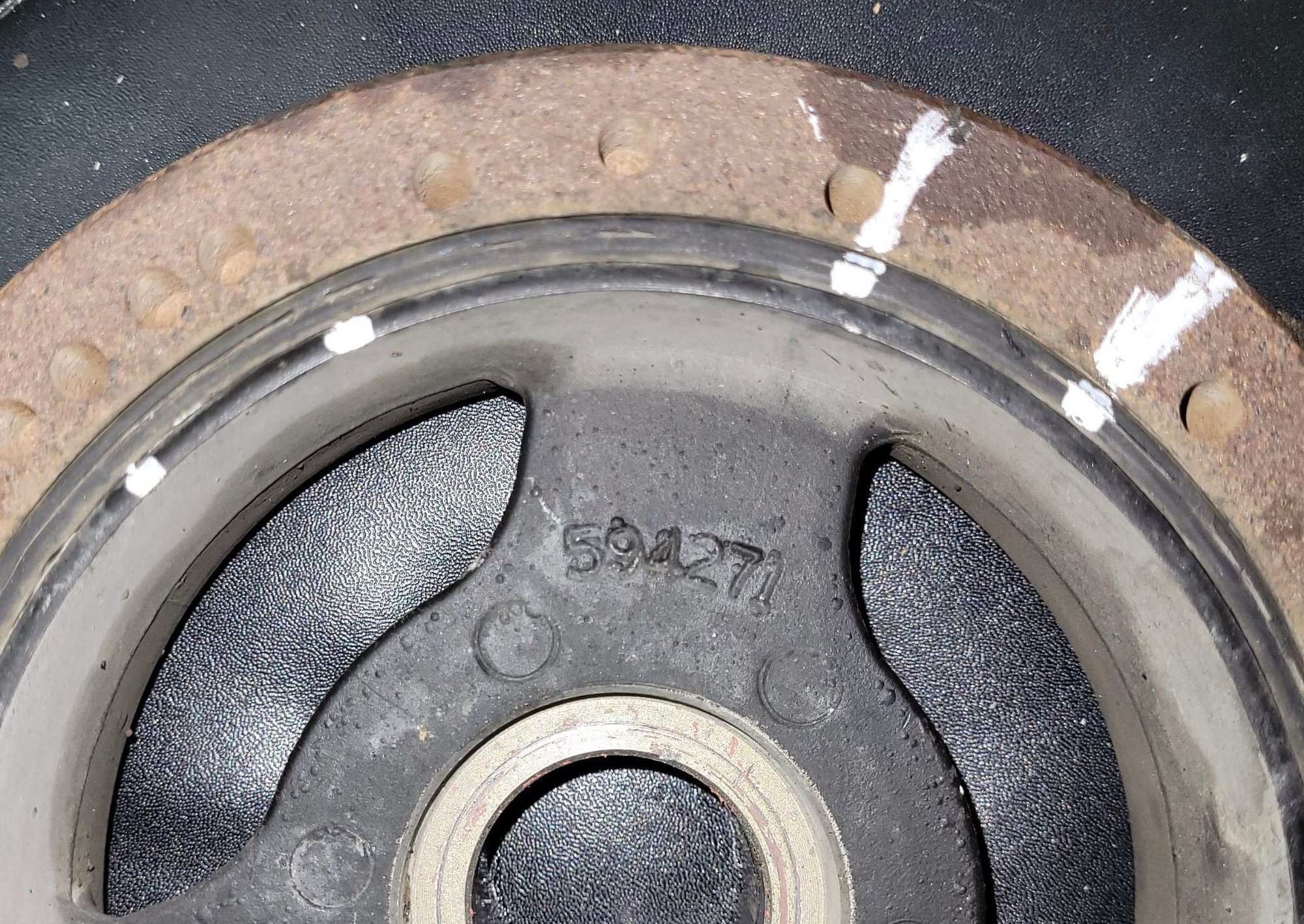

I purchased my 07 last year with 35k miles, wobble was barely perceivable and it squeaked intermittently. Local dealership quoted $1600 to R&R with stock parts, I used this to negotiate. I marked my balancer and within a week it had moved.
I prefer to plan my repairs as opposed to leaving it to chance and the other damage a failure could cause. You do you but I would at least mark it and keep a very close eye on it and hopefully it doesn’t bite you in the A$$. 👍

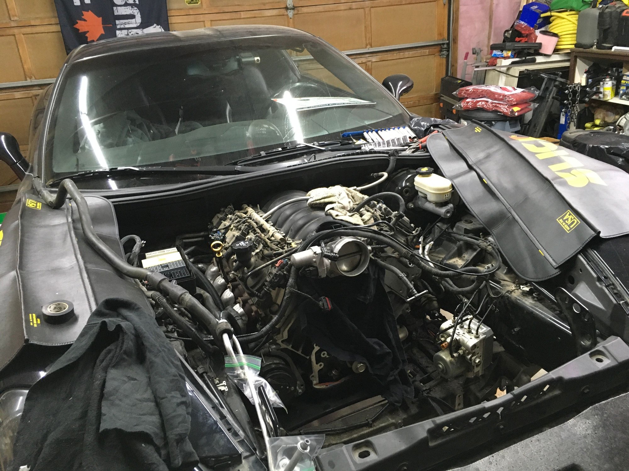

Here is a write-up i made when I did mine a few years ago. Everyone is concerned about how long it takes so I decided I would break it down into 15 minute tasks for a better understanding of what is involved. You can disregard the extra steps I included like water pump and PS hose replacements if not needed.
https://www.corvetteforum.com/forums...-write-up.html

I also have an '05 with 35K on it. The HB had a fair amount of wobble and when I got it out you could see some of the rubber squeezed out on one side and drawn in on the opposite. Left alone it would eventually have failed. That said if your wobble is minor and you don't drive it hard just keep on driving and have an occasional look to see if the problem has increased to where you think it's time. As said you cannot easily replace the bolt. Because the rack is so close to the HB and dead center you need to remove the rack and by that time you might just as well replace the balancer. This is really not a difficult project but it is time consuming and you need jack stands and the right tools. The bolt needs to be torqued to 240 pounds which means you need a 250 pound torque wrench or use the 37 pound and 140 degree method. I did this myself and I'm no spring chicken, although I had my son help. While you can pin the new balancer I didn't bother as I have no intention of adding a super charger which is the main reason to pin one. The dealers will usually get $1200 to $1500 for the job and install a factory style HB unless you provide it! If you're not going to tackle it yourself find a private shop that has done a few and use either an ATI or PowerBond balancer, ARP bolt/washer kit, and replace the front seal. You should be able to get this all done well under $1000 parts and labor. In the mean time don't lose sleep over a minor wobble until it get's worse.
