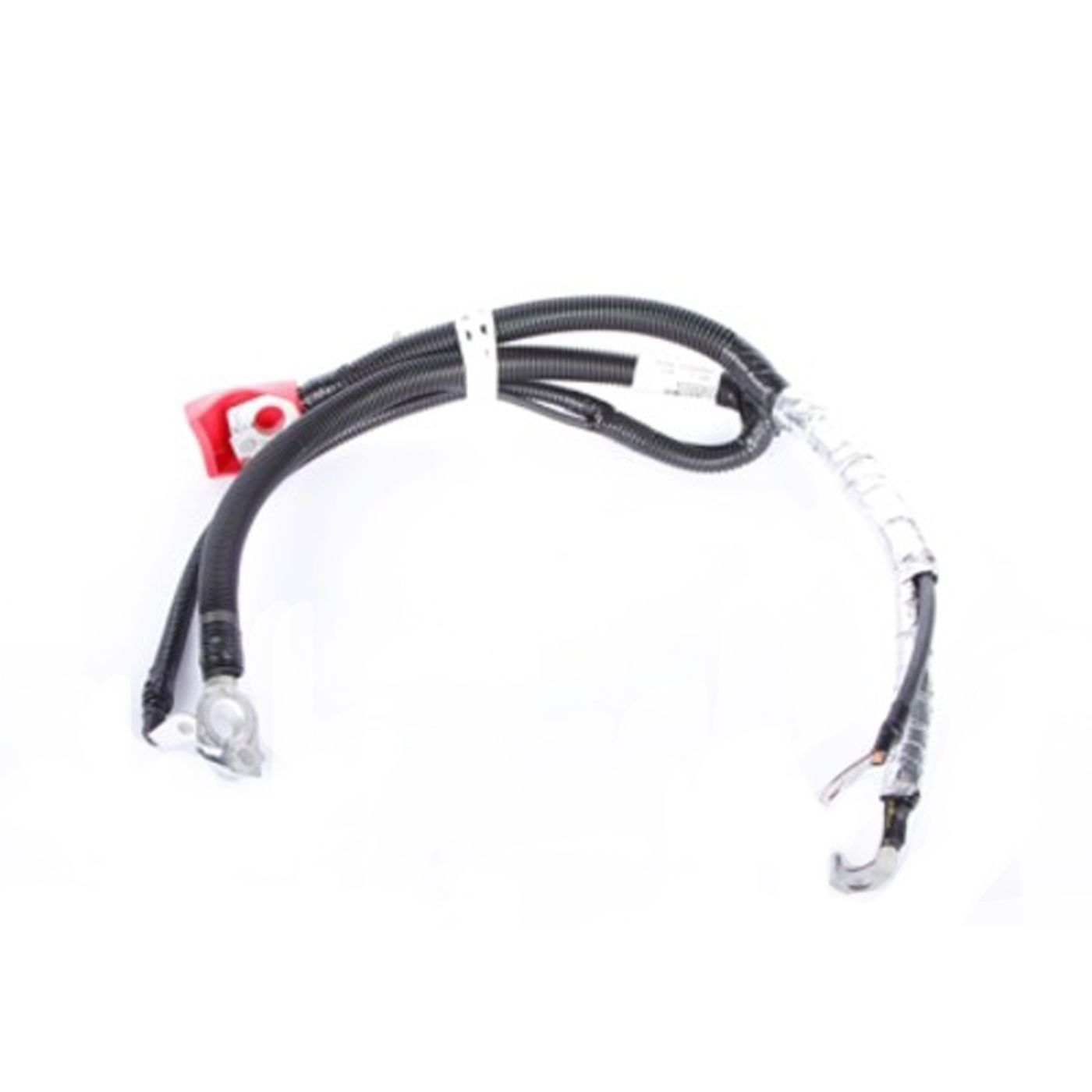

I had a fuel pump go bad and had the dealer install a new one. They have had the car for over a week now for something they said would take about 8 hours. They now tell me the delay is they are waiting for parts, which I assumed had something to do with the new pump. Being tired or the run around I pressured them as to what "part" they were waiting for and they said the battery cable. I believe this is something I can purchase at any auto store unless I am missing something. I have read different things about what to use. One said a cable from the battery to the starter, another said the cable should have pigtails on the end, going to the starter, alternator and ground. Can anyone give me some advice what I need to buy with specifics such as gauge, etc?

Modern car battery cables are a little more involved than the ones sold at your local auto parts store.
Might check online GM parts suppliers. Search 20835504

OP, I just went through this myself a couple of months ago and 20835504 is the right cable...however it took me about 10 hours on the phone over the course of a week and $170 including shipping to find one in stock! The good news is it did solve my "my push, click, no start" issue.

Went through this with my ‘08. Connectors we’re all good but cable was corroded internally. Replaced and no drain since. Took my dealer 4 days to find one and that was before all the supply issues. Good luck in your search.
