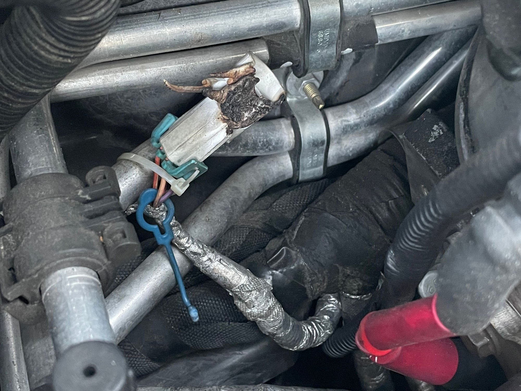

This plug rested up against the long tubes one day and melted. What is this connector for? I can’t find anything on it. Any help would be appreciated, thank you!

o2 sensor harness... or whats left of it... not sure if its upstream or down stream off the top of my head.

I agree, O2 sensor. Square plugs are downstream. Upstream have a trapezoid connector. With the headers, the downstream sensors were probably deleted. I bough my car with headers already on it and it only has the 2 upstream sensors.

Thank you guys! So in that case, with the setup I have, that O2 sensor plug doesn’t do anything anyways. So I’ll just leave it out to the side?

Yes, if nothing was plugged into it, you should be good. It will only be an issue if you ever decide to go back to stock manifolds and cats. And for the O2 sensors you do have, maybe check on the connectors at the sensors next time you or whoever is under it. Make sure they are well away from the headers.
