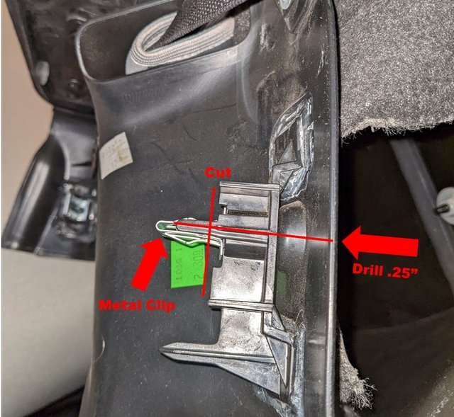

My son and I are in the middle of the bracket installation for the GM Windblocker. We did a bit of research and, yes, the instructions leave much to be desired. We were moving along quite nicely until it came to the seat belt covers. We managed to detach them from the metal understructure and, even though the instructions led us to believe that they would be secured with either a Torx head screw or a plastic "Christmas tree" fastener, they were, in fact, secured with clips - one laterally to the centerline of the car and one longitudinally to the centerline. The lateral one is where the bolt that secures the top of the bracket goes through to thread into the supplied plastic anchor that is installed in the metal, after the slot is enlarged to a 3/8" hole.
It appears that we need to cut that clip completely off the backside of the seatbelt cover, in order enlarge the hole in the cover to match the installed anchor in the metal. This would be a point of no-return, so I just want to insure that we are correct in assuming that clip needs to be cut away and discarded.

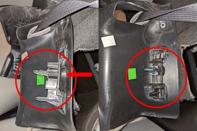

48 Views and just crickets. That's OK because my brilliant son figured it out. Given the age of the vehicle and the fact that the plexiglass wind restrictors seem to find favor over the GM iteration, it's not likely that there will be much call for this in the future. But just in case somebody else ends up struggling with this, here is how we resolved it.
1) Remove the metal clip from its plastic protrusion
2) Cut the plastic protrusion as shown
3) From the outside of the seatbelt cover drill a .25" hole straight through where the clip was
By doing this the remainder of the base where the clip was stays intact and acts as a stand-off against the metal tower. The lower locator pin also remains and facilitates reinstallation. By having the stand-off you can tighten down the bolt that holds the bracket in place.
