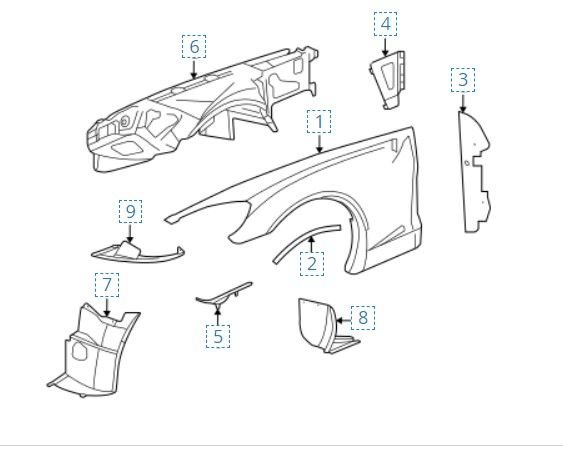

Exactly like WC said above - the front wheel well, rear fender well cover. #8 in the pic below - #3 is the foam pad, behind the foam there is a small bolt or the bolt may even hold the foam.
Just giving the OP some info from what I remember during my re-painting project
